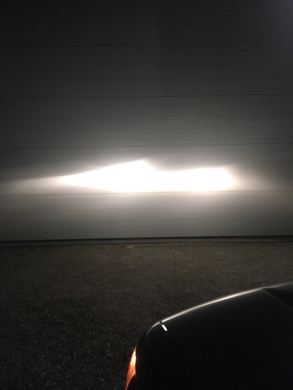

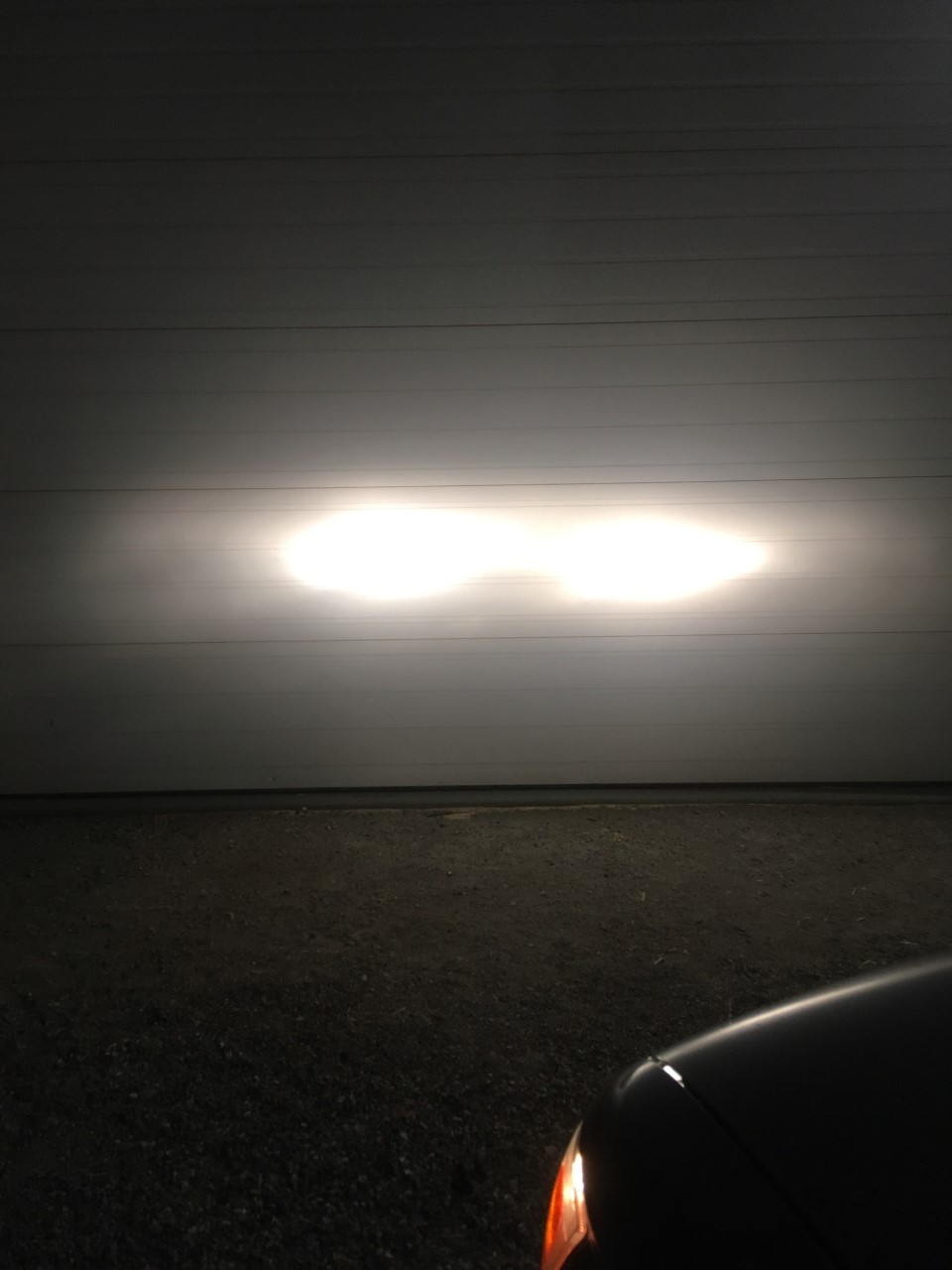

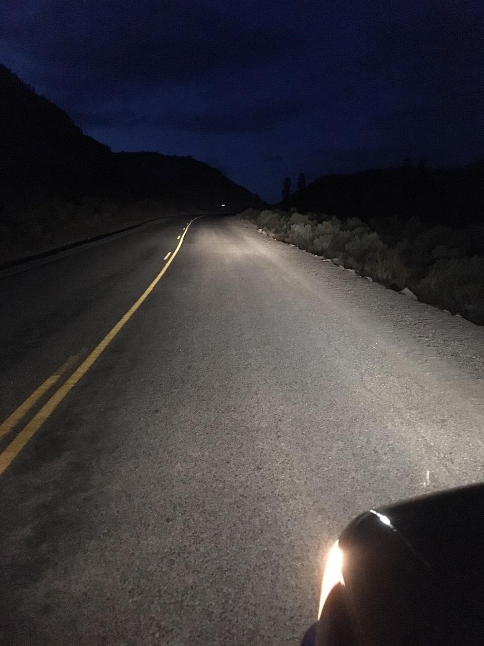

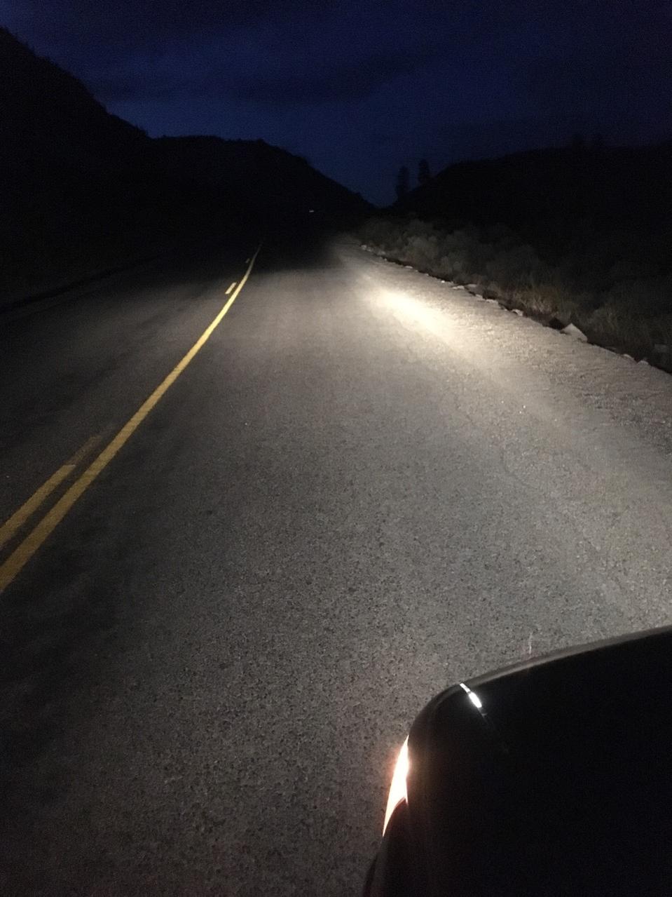

There are no LED/HID made when put into halogen housings that control the low beam light keeping it out of oncoming drivers eyes (ILLEGAL BLINDING OTHERS) in all states. Just for reference I took some pictures close to the ones posted. My measured (not guessed) 12' from the wall using GE Nighthawk bulbs. The farther away the more obvious the legal/illegal light is. The difference is very clear between halogen bulbs in halogen housing compared to LED. Notice the very defined line of light on low beam (LEGAL/NOT BLINDING OTHERS) compared to the high beams and LED on low beam.

There are no LED/HID made when put into halogen housings (LEGAL/NOT BLINDING OTHERS
That is my take on it also why I call these a experimental shot for $40. Had some HID's from DDM that didn't blind folks, output was better than Silver Stars that got totaled along with redrunner. See where it goes.
Forgive me but are these shots of the halogen bulbs or the LED's we have all been talking about?
Yup, that was my concern too, seeing that the sharp cutoff that was present with the halogens was no longer present with the LEDs. I'm curious to try them nonetheless, but if they have any hint of blinding oncoming traffic, back they go. I'm itching to do an HID retrofit anyway :).

I put the oEdRos on, they do Not blind oncoming drivers, not one vehicle, tall or short, has flashed me in about 300 miles of night driving so far. They are designed to emit light in the same directions as halogens and the reflector ensures the light only goes where its supposed to. LEDs without reflectors will do just what you say though.
That's my experience so far, now for longevity tests!!! As long as they last a couple three years they are worth the extra brightness, I notice it more and more each time I use them. Luck to all! :cowboy:
