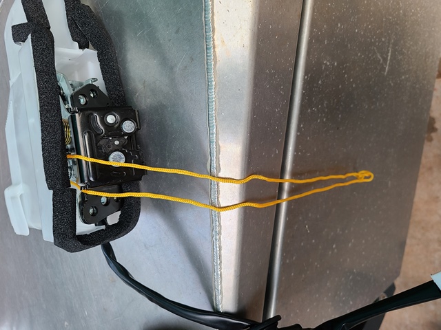

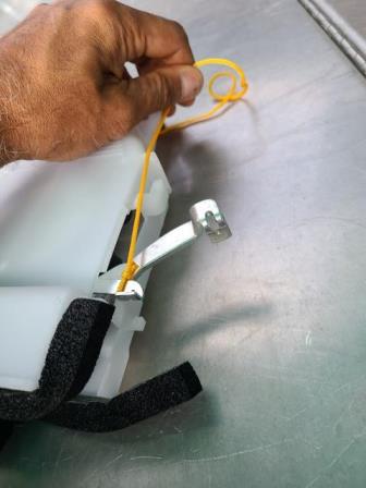

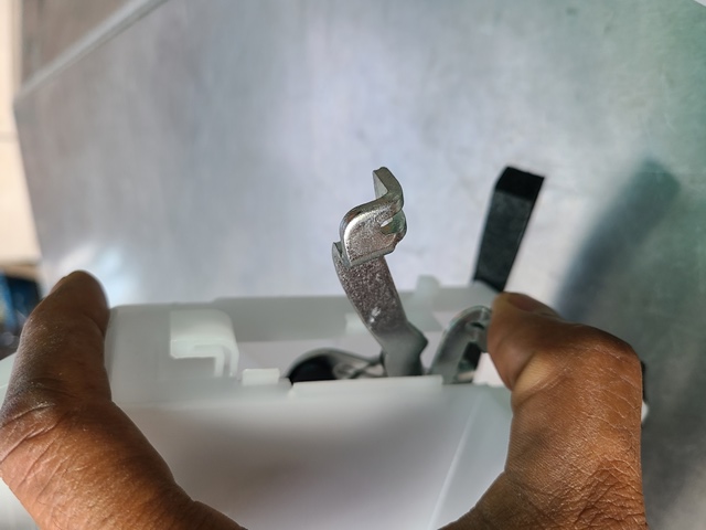

There's one thing you have to do when you purchase an Amazon actuator, that is to move the string. You see, the string they provide for an emergency release is a great idea. However, it's connected to the wrong end of the latch. Meaning, you have to pull DOWN on the string in order to release the door manually, which as we all know, can't happen when the door is closed and you're reaching in through the window.
So, all you have to do is move the string to the other end of the latch, then put a little hole in the plastic cover that covers the latch and pull the string through it. This way, the string is always available just in case the actuator fails to relase.
Just see the pics and it'll all makes sense. My thumb is on the manual release lever, which is the smaller of the two. The larger lever moves with the motor and can't be manipulated manually.

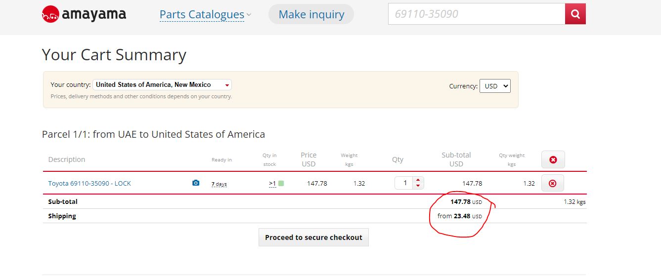

Incidentally, Amayama has OEM actuators for $147 + $23 shipping to my place. I've attached a screen shot of my cart but I didn't order it. Another option for us for an OEM part that is still cheaper than Claremont Toyota, which is where I get some of my OEM parts from.
HTH others with the same issue.
