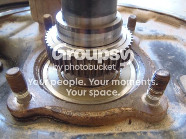

Here’s a picture of the assembly as it sits on the axle (after removal from the vehicle). The top of the Bearing is visible pressed into the backing plate. The Olive/Light Gray colored plastic ring you see is a grease seal built into the bearing. Next is the first of the two Retainers. Not visible in the picture is the Snap Ring, but I believe it sits above the first of the two retainers, holding the retainer in place. Just above that sits the Skid Control Rotor (or ABS exciter ring), that looks like a gear. Finally, on the top you have the second Retainer keeping the Skid Control Rotor in place. The Outer Shaft Oil Seal is not visible as it is on the other side of the bearing.

I am wondering how gear oil leaks past the bearing. In the picture above, it is hard for me to see how gear oil would flow past the bearing. But, looking at the pictures of your brakes (elsewhere in the thread), it sure seems like a lot of fluid flowed onto the brake shoes/brake system. It appears the O-Ring between the backing plate and the axle flange kept gear oil from leaking out before getting onto the brakes...would you agree? i.e. if the O-Ring was not present and making a good seal, the gear oil would have leaked out down the back-side of the backing plate onto the ground instead of getting all over the brake shoes. No?
My guess is the bearing presses into the backing plate/flange, and the Retainer presses onto the shaft to hold the bearing in place? i.e. the bearing is not pressed onto the shaft, only into the backing plate. Which makes the retainer necessary to hold the bearing in place on the axle shaft.
The reason I ask all this is I wonder if your old bearings had gear oil in them? Or, since they appear to be sealed bearings, were their seals OK and the gear oil flowed between the bearing and the retainer to make its way out onto the brake shoes?
Thanks again!
Ok, the top retainer is what the seal rides on. No oil should be past that (meaning nothing on the exciter ring and out) Some people remove the ABS sensor and look inside to see if there's any oil. If there is, your seal is leaking. When I did mine about 5 months ago, I did everything including the press work. Getting that outer retainer properly positioned is CRITICAL to proper seal. There isn't much margin for error. Looking at that picture, and thinking back to my repair, I thought I had a slight gap between the exciter ring and the outer retainer. I tested the position of the seal on the retainer by smearing some grease on the retainer and sliding the axle on then off and looking at the retainer to see where the grease was smeared off. Mine were right in the middle of the retainer. I used Dr. Coffee's write up. It made a lot of sense to me.

I understand how gear oil makes its way into the ABS speed sensor area, and I agree that a bad seal, or bad bearings, or both, would cause that to happen. The part I am trying to figure out is what path the gear oil takes from there, in order to get on the brake shoes.
It seems to me that the gear oil would have to work its way through the bearing, or around the bearing, in order to get to the shoes (which are on the other side of the backing plate in the picture above).
Looking at the pictures of the brakes shoes soaked in gear oil, I would have expected a more obvious path than just seepage between the press connections. But I don't see anything that obvious.
Thoughts?

The bearing is pressed into the backing plate and even though the tolerance around the shaft to the ID of the bearing is very close, its not a press fit so the gear oil will work it way out there. Also, that large oring is just a dust seal, so it can get out a little there also. When I did mine I didn't even replace the oring as mine were still round and supple. Wow, that sounded a little weird LOL but you get the idea.
Thanks!
If you are referring to the O-Ring that goes between the bearing housing and the axle housing, I think I would prefer it to leak there, then the gear oil wouldn't get on the brakes. it would drain out before ever getting to the backing plate.
Would you agree?
Would you agree?
Yep, that seal does pretty much seal it up. I think centrifugal force along with the slight pressure kinda "spins" the oil out between the inner part of the bearing and the shaft.
