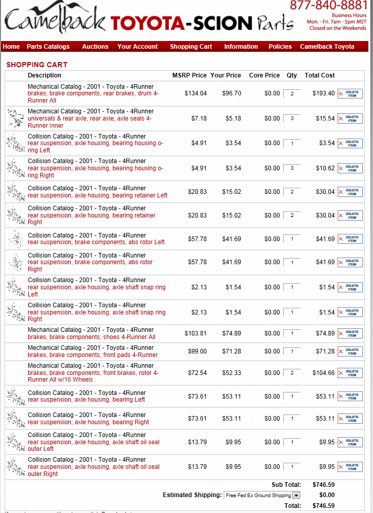

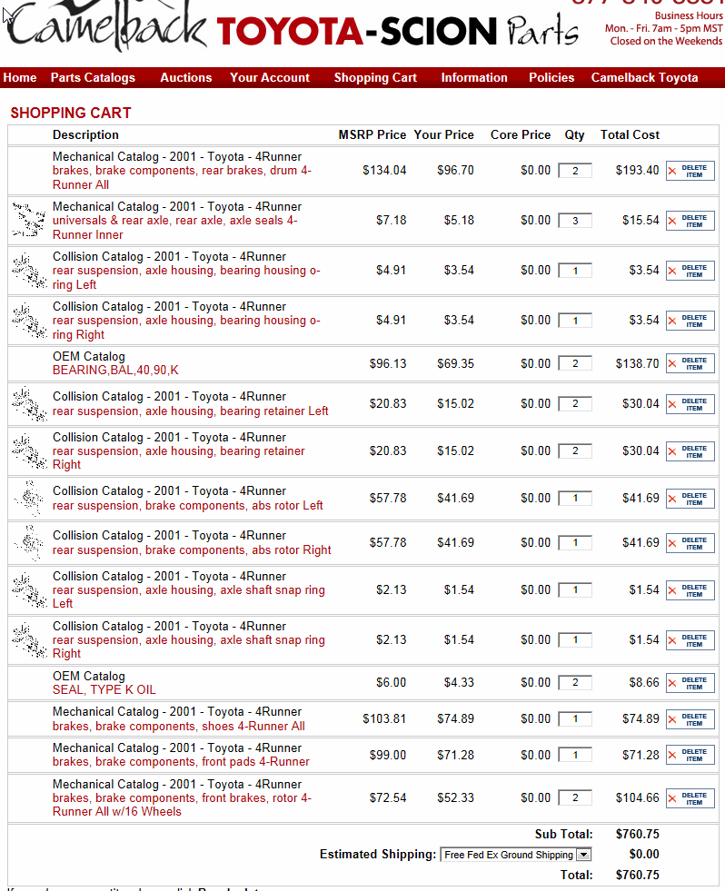

Yeah I think I am on my way to DIY.. I am on the website Camelbacktoyota.com and here is my shopping cart for front rotors and pads, rear shoes and drums and everything the OP listed for the rear axle seal job.... Am I missing anything hear for all of that? I noticed for the rotors it has in description "w/o 16" wheels" and "w/16" wheels", what does this mean??
Total is $760.75 for everything.. including brakes all around. Not sure if I am ready to tackle this thing yet or not!

Just an FYI if this hasn't been posted prior. BFAD's amended parts # list for 2000-2002 4Runners.
inner seal - 90310-50006
bearing - 90363-40068
ABS rotor - 43517-35010
bearing retainer x2 - 42423-20010
outer seal - 90313-54001
snap ring - 90520-36045
O-ring - 90301-88077
Hope this helps.
UPDATED - After seeing this I now added the correct Bearings on the list and O-ring that was wrong prior...

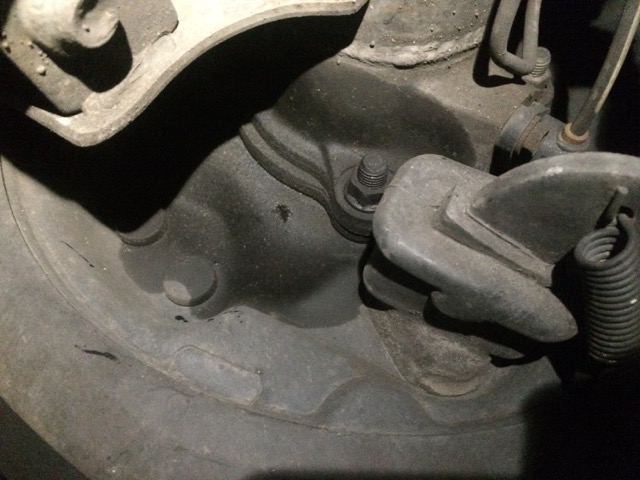

Saw this while I was looking at something yesterday. Passenger side axle.
:roadkill:
If you're lucky, the leak has only gotten into the carrier bearing area and not ruined your brakes. Usually the leak isn't noticed until there's oil all over the inside of one or both tires (and thereby, all over the inside of the drums).
The wheel flange is designed such that a small leak should be channeled through the dust seal and inside the sheet-metal shield piece where wheel rotation can centrifuge the oil out the hole in the outside of the axle flange (between two lug nuts). This is why there is a rubber gasket between the metal shield and the axle flange (sandwiched by the pressed-in wheel studs). The paper gasket seals between the axle flange and the corresponding holes in the drum to keep the oil traveling out safely past the brakes... But that almost never happens. The hole gets clogged or the rubber gasket leaks and gear oil almost always just leaks all over the brakes.
