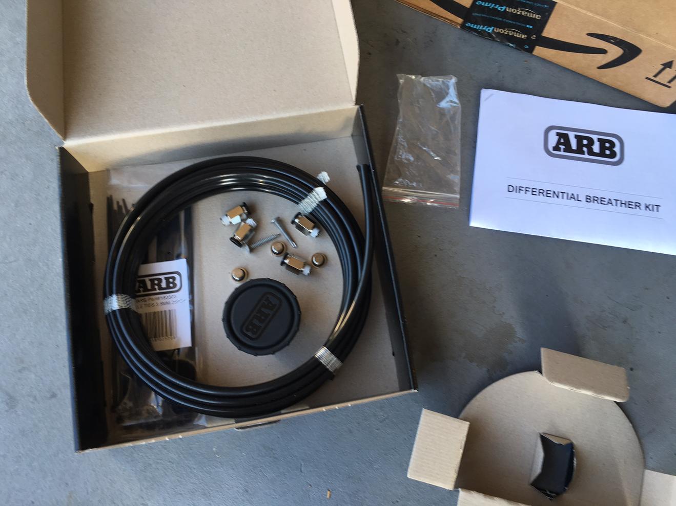

I used the ARB Differential Breather Kit for this modification. I bought it from Amazon.
Amazon.com: ARB 170112 Differential Axle Breather: Automotive
The kit includes a filter, 4 two-way breather fittings with Teflon tape already on the threads, 3 plugs for any unused breather fittings in the filter, lots of zip ties and enough tube to do multiple breather modifications.

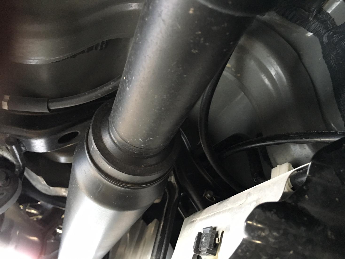

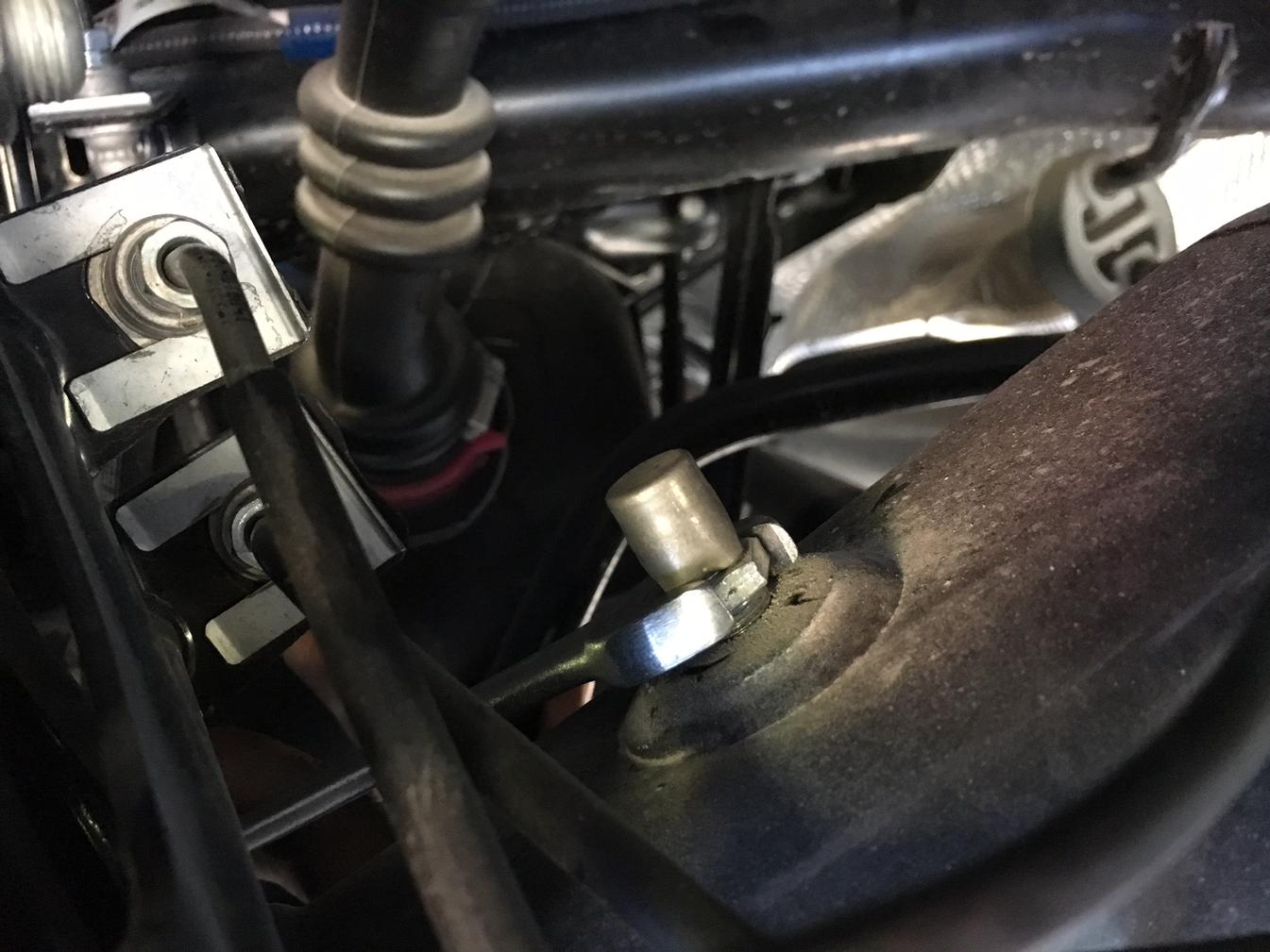

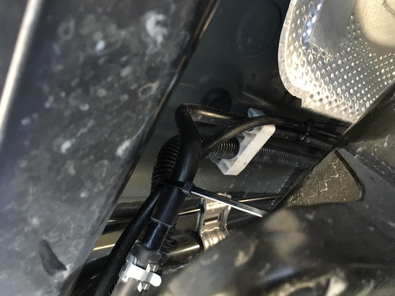

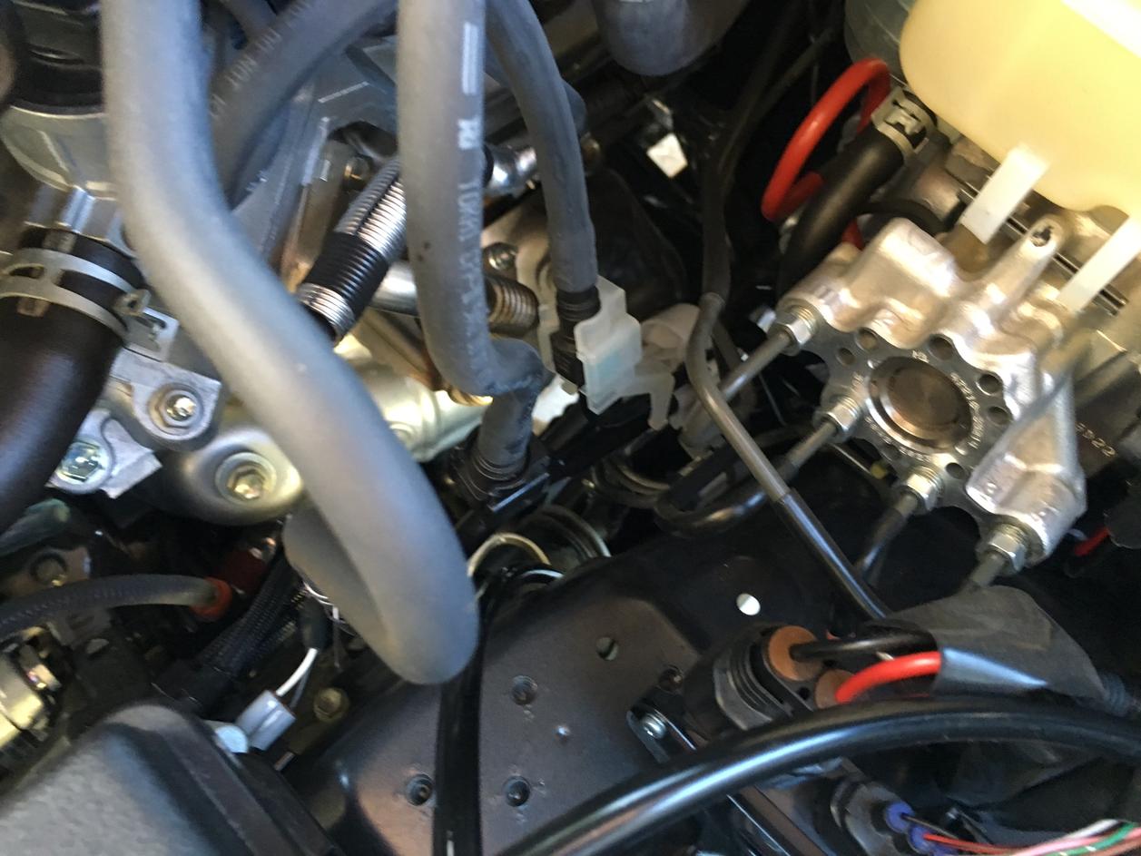

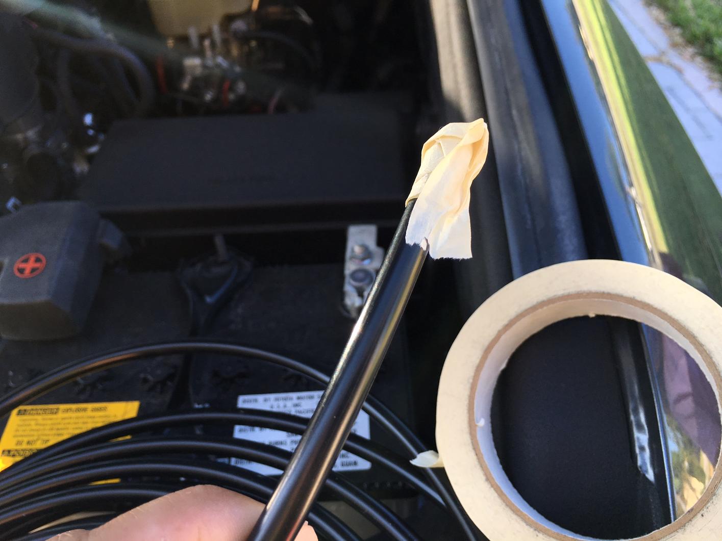

Run the breather line (but do not zip tie or attach anything yet). I started in the engine bay, and ran it to the back of the vehicle. A lot of people run it up to the gas tank or up the fuel tube, but I wanted something up, out of the way and easily accessible if needed. I taped the end of the tube I was running down through the engine and along the different lines and hoses to the back of the vehicle so that I would not get dust/dirt in it.

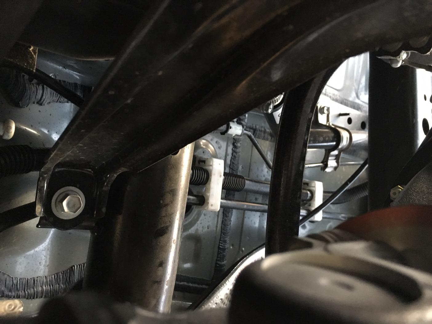

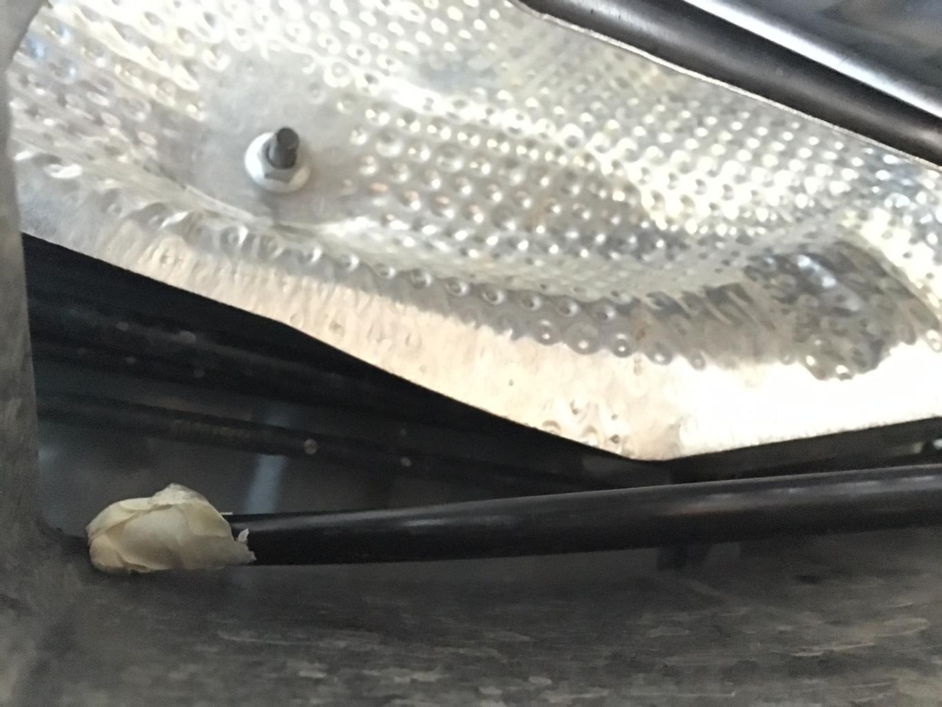

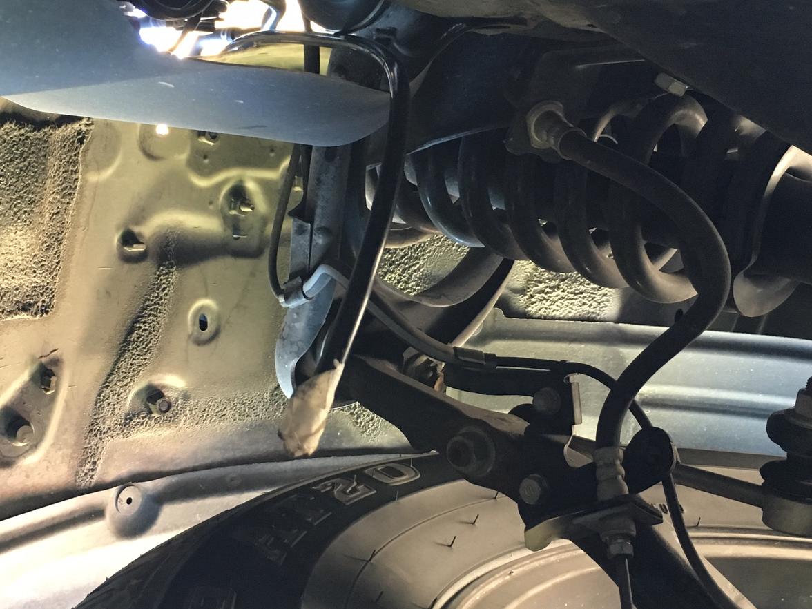

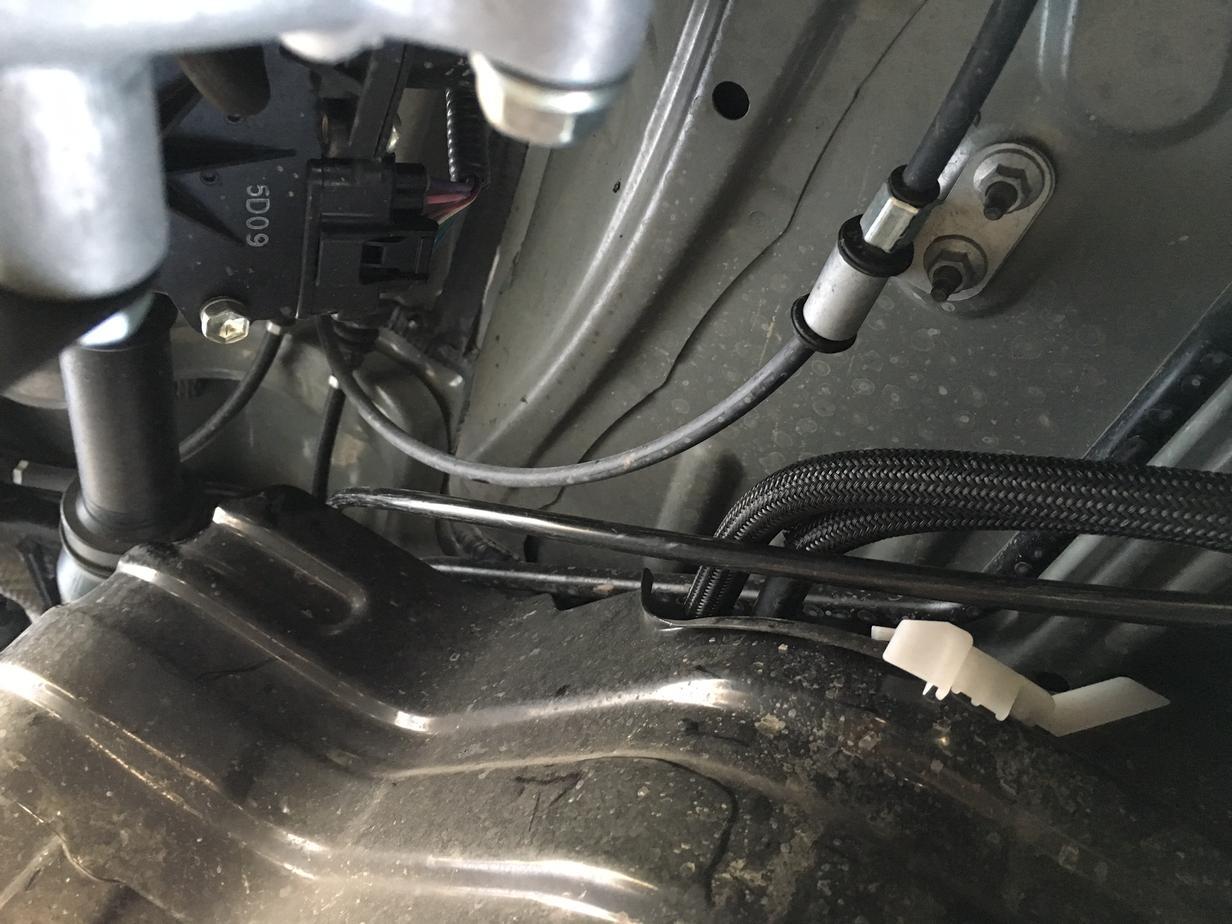

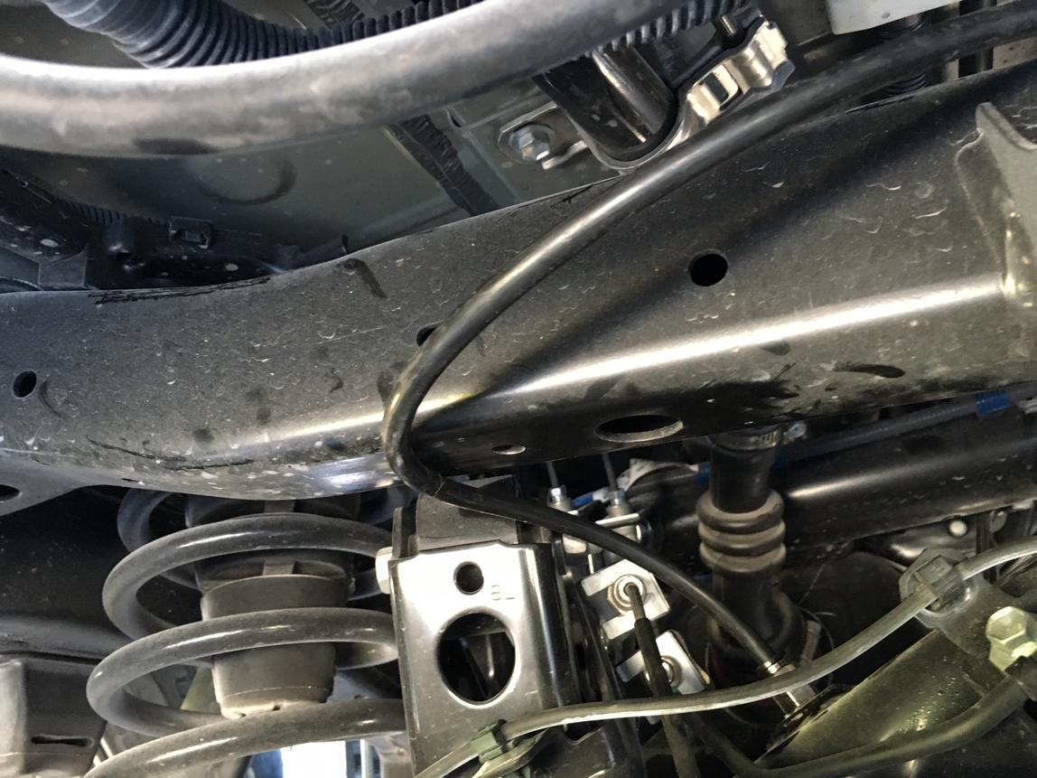

Once I fed it down the engine bay I worked it behind the fender liners to keep it away from the shocks and front axle. I then found some lines to run it next to above the heat shields and above the driver’s side frame rail.

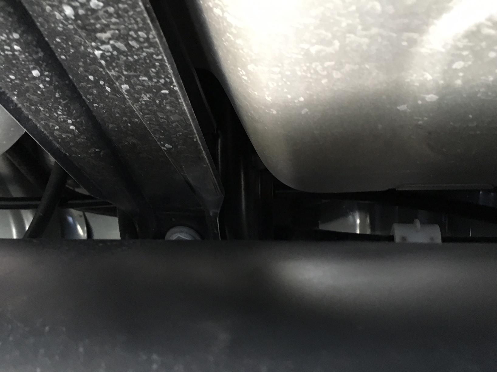

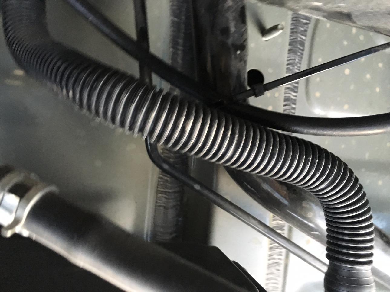

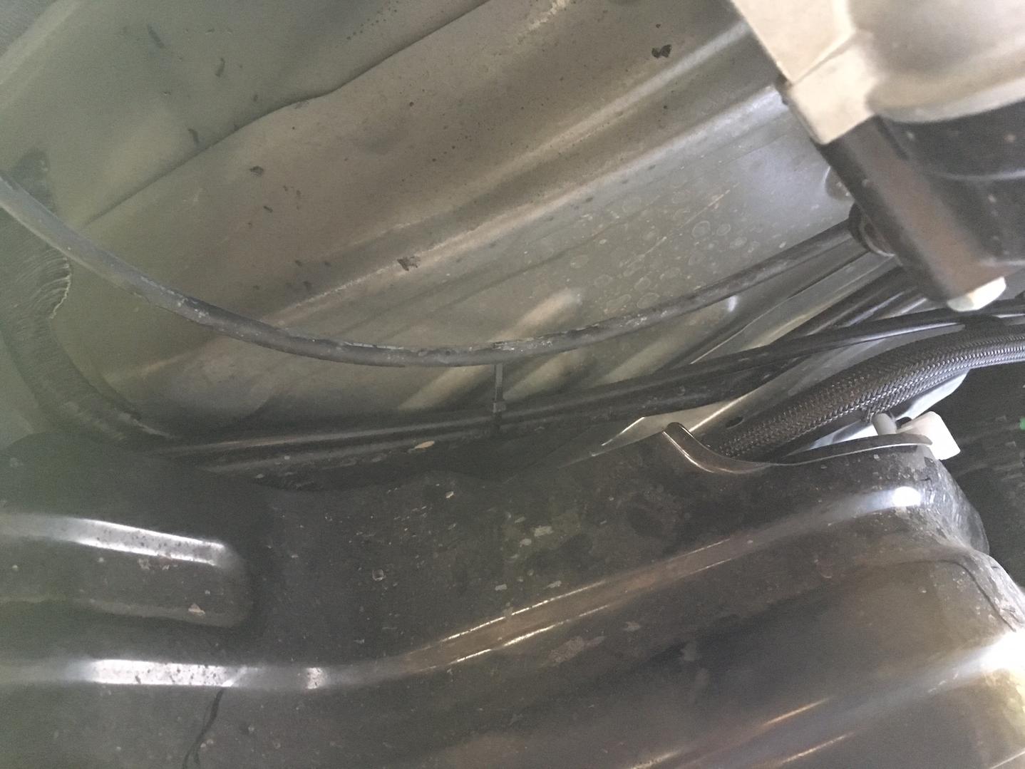

I then followed those lines above the gas tank/gas tank skid plate. Making sure I could eventually zip tie to other lines that were above the center differential.

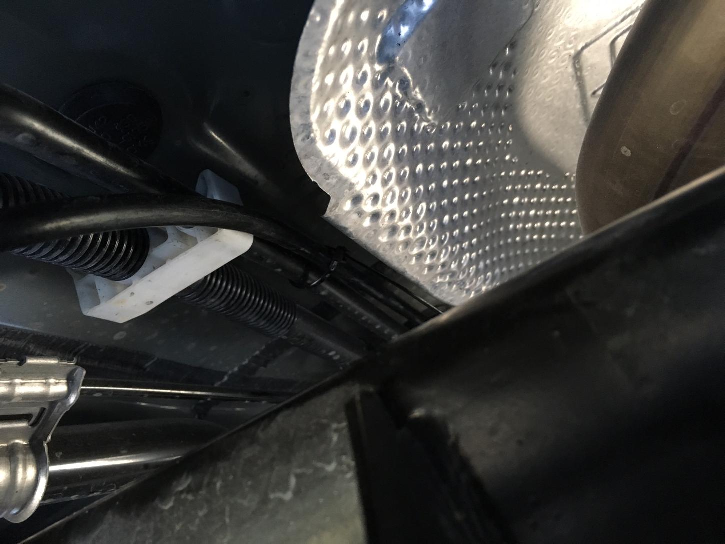

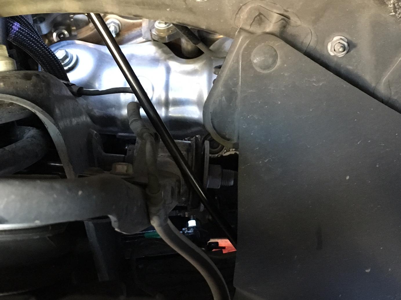

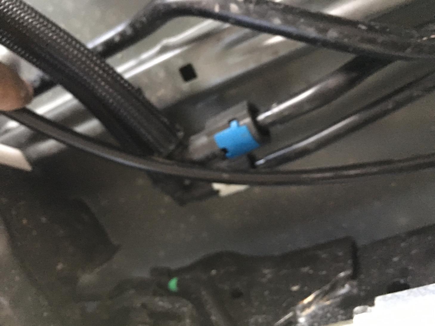

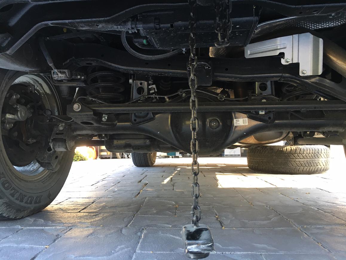

I continued to follow the lines (I believe they are the fuel and electrical) above the rear axle and differential.

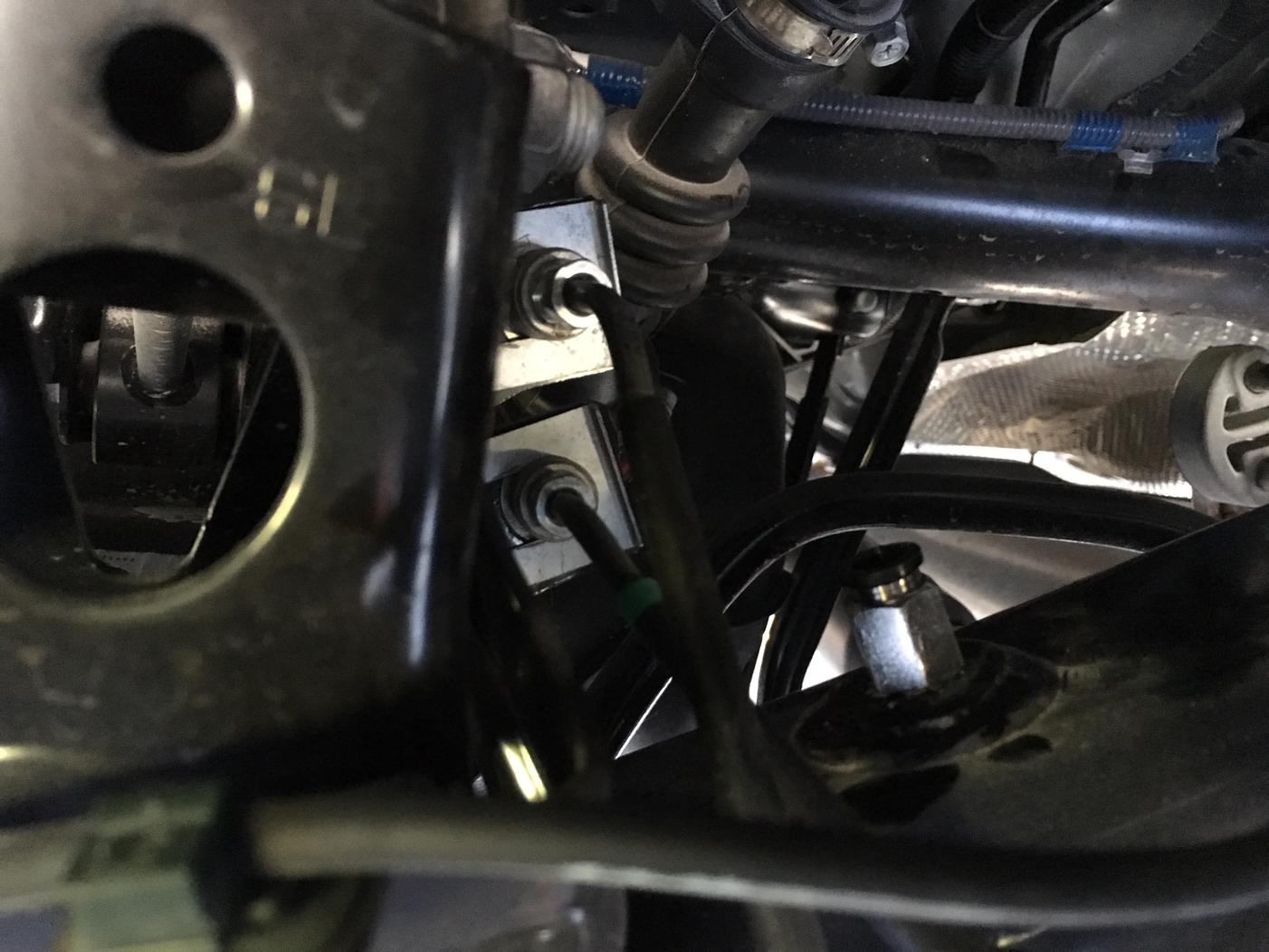

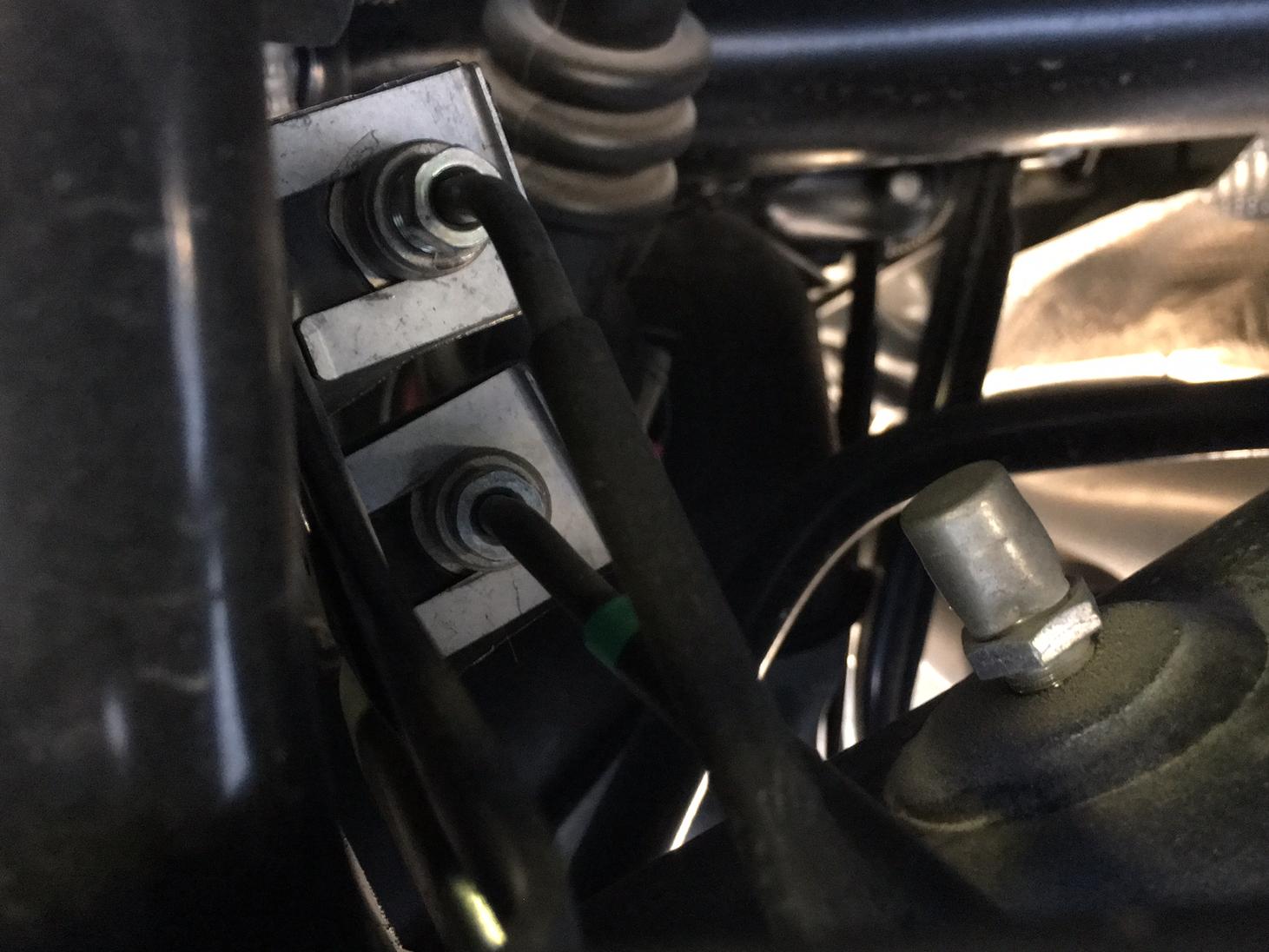

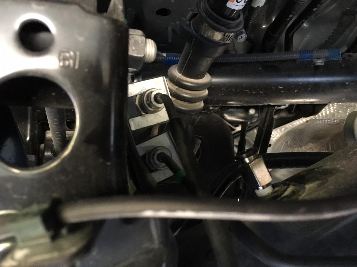

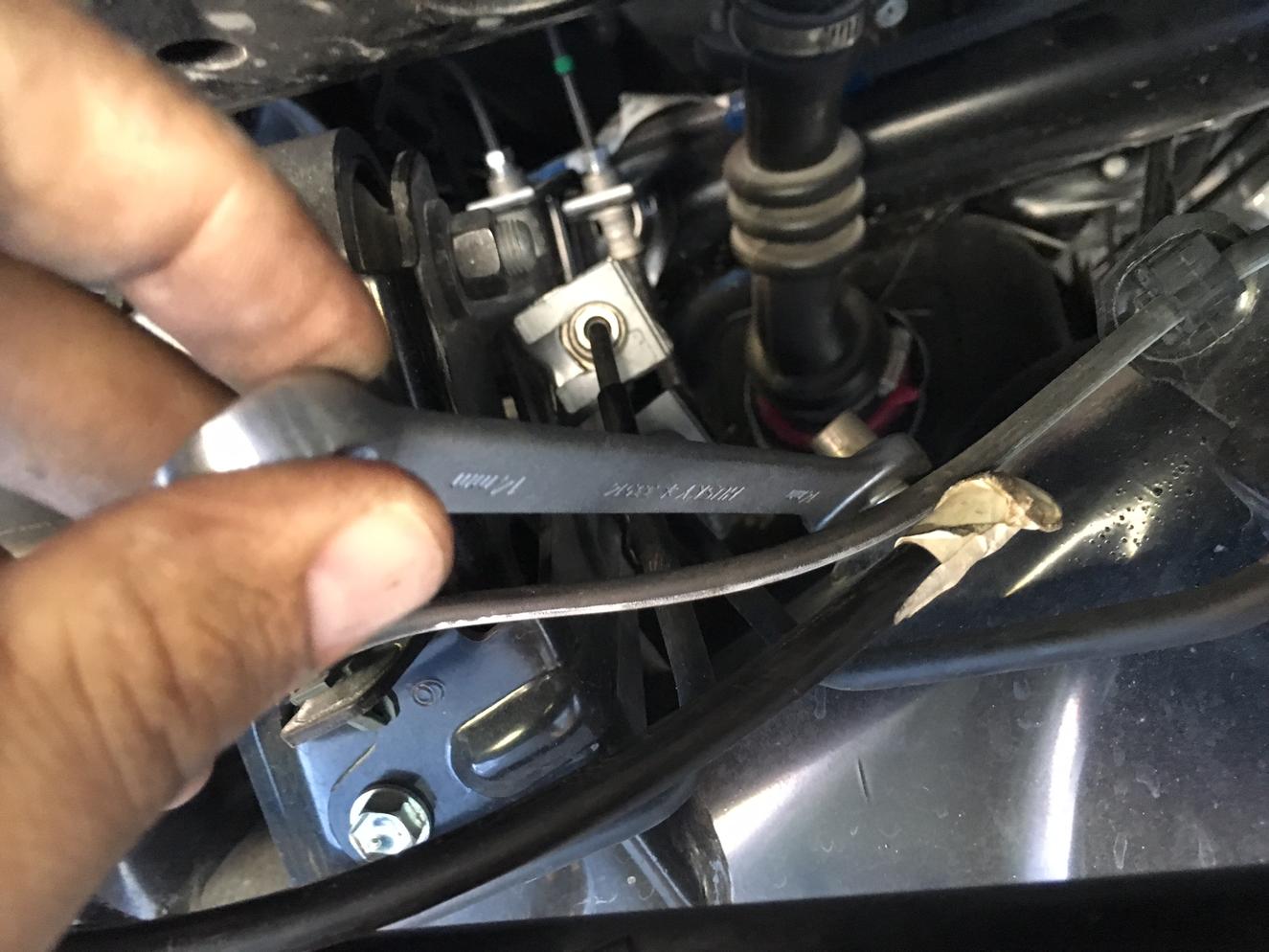

Replace OEM Breather with ARB two-way fitting. Use the wrench to unscrew the old breather. There will be a gas release as you finish unscrewing from the vacuum within. Install the ARB until completely hand tightened.
Step 4:

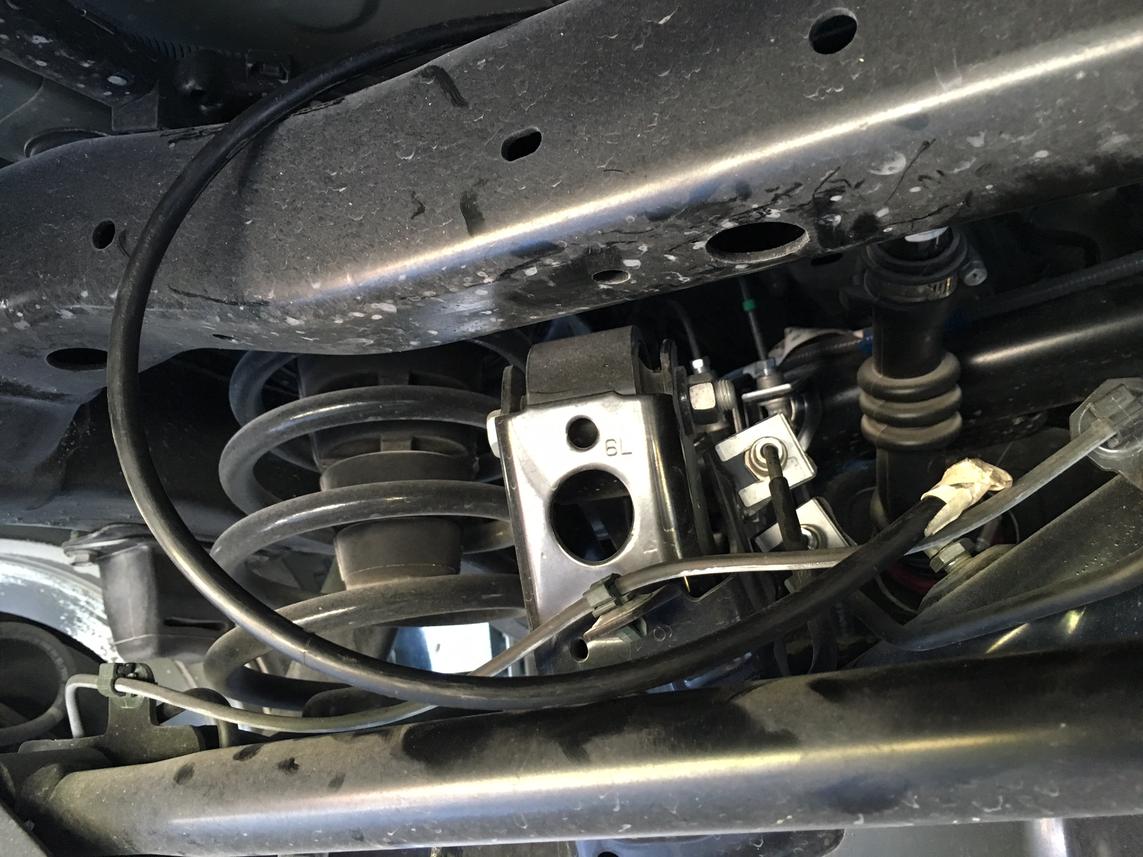

Insert Breather Line into ARB fitting. Before I did this I made sure that there was an extra coil of slack before inserting the line into the ARB Breather. This allows for suspension travel (I still have not used any zip ties yet). The line pushes directly into the fitting and seals itself. Once inserted it is locked in (YOU CAN NOT PULL THE LINE BACK OUT AT THIS POINT SO BE SURE YOU”RE READY TO INSERT).

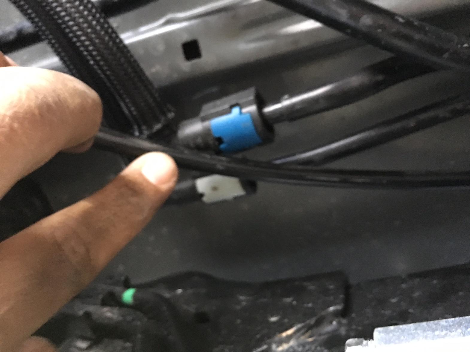

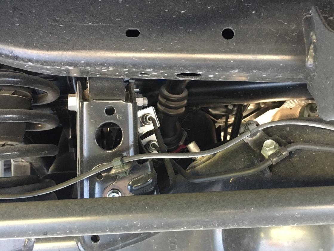

Zip Tie: I now went back through and zip-tied the Breather Line to the electrical and fuel lines that I chose to run along. I made sure to leave some slack near the breather for suspension travel and that the zip ties were not over tightened so the line was attached but could still move freely.

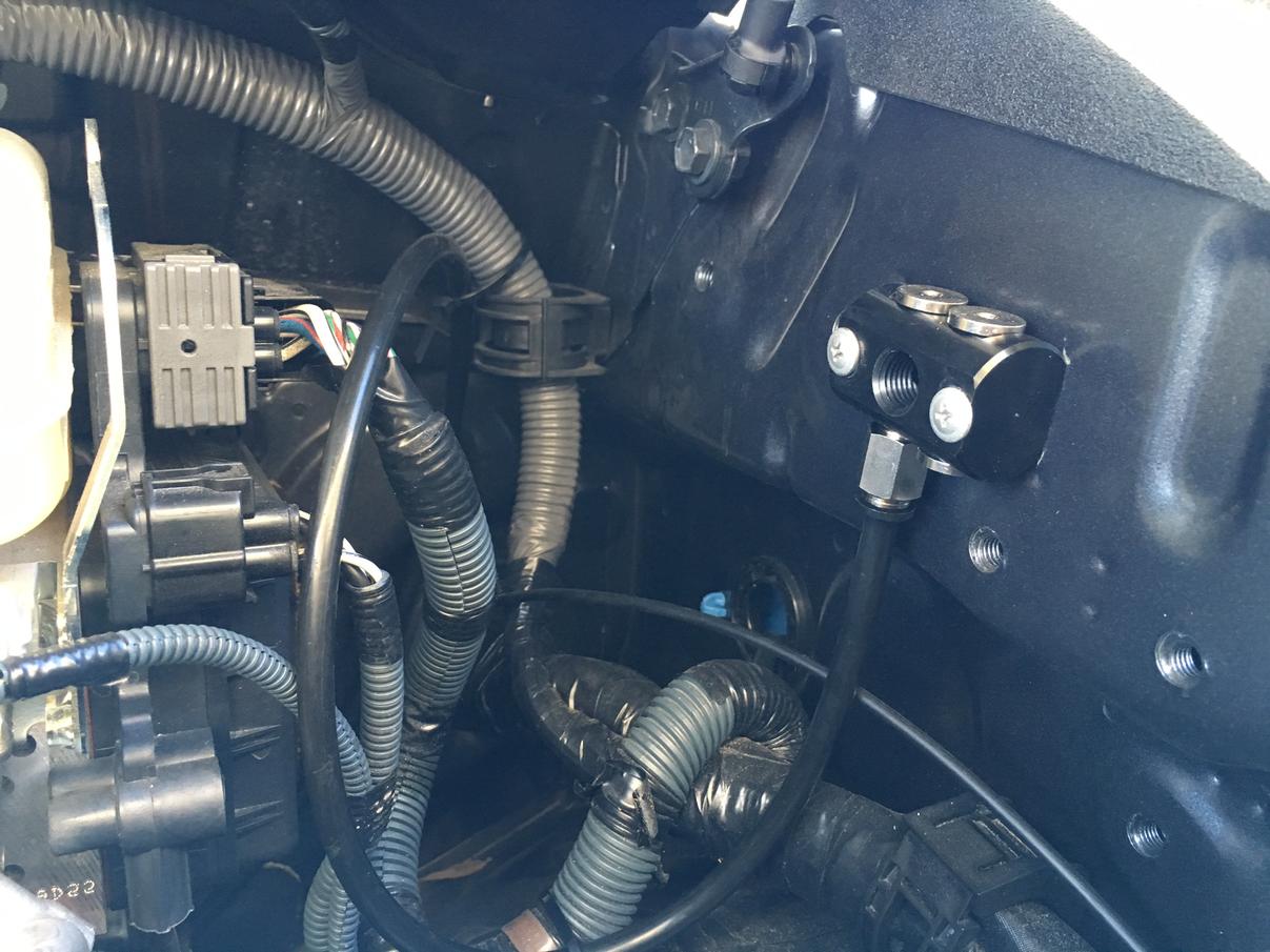

Install filter bracket. I decided to install it on the upper driver’s side using the self-taping screws. This gets it up and out of the way, if water gets in here I have other major issues, not just my rear differential. Since I only am attaching one breather at this time I used the caps in the other 3 breather holes on the filter. I then attached the one other two-way breather fitting and attached it using the self-taping screws and a cordless drill.
Step 7
Install the breather line into the filter bracket. I made sure that there was slack, giving it another loop up and down and then cut off the excess breather line. This is in case I decide to do a lift in the future, or some other modification where I need to extend the breather line. I then inserted the breather line into the two-way ARB breather fitting, pushing it in and locking it in place (same way as on the rear differential fitting). I then loosely zip tied the line to a couple of the electrical lines.

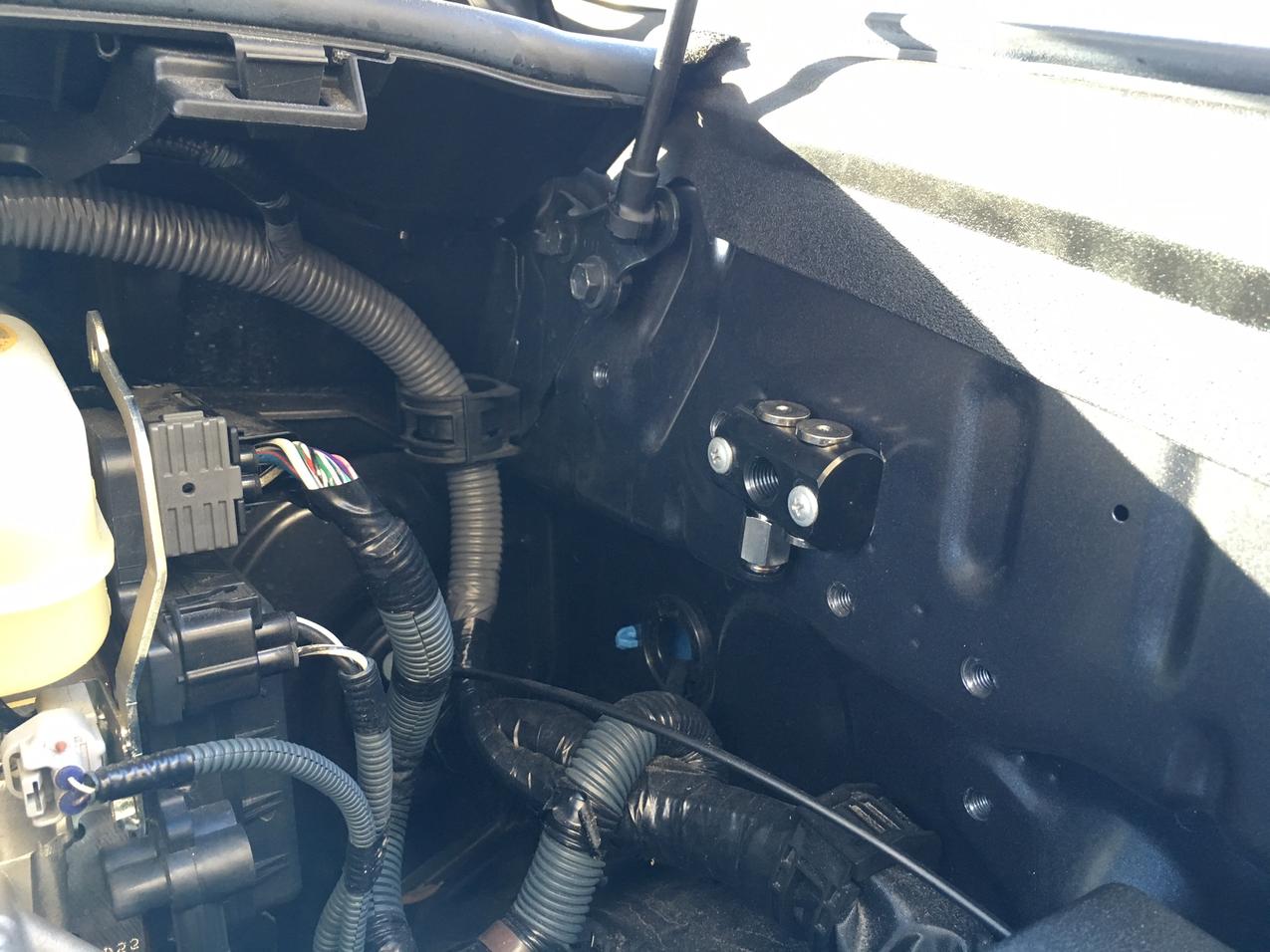

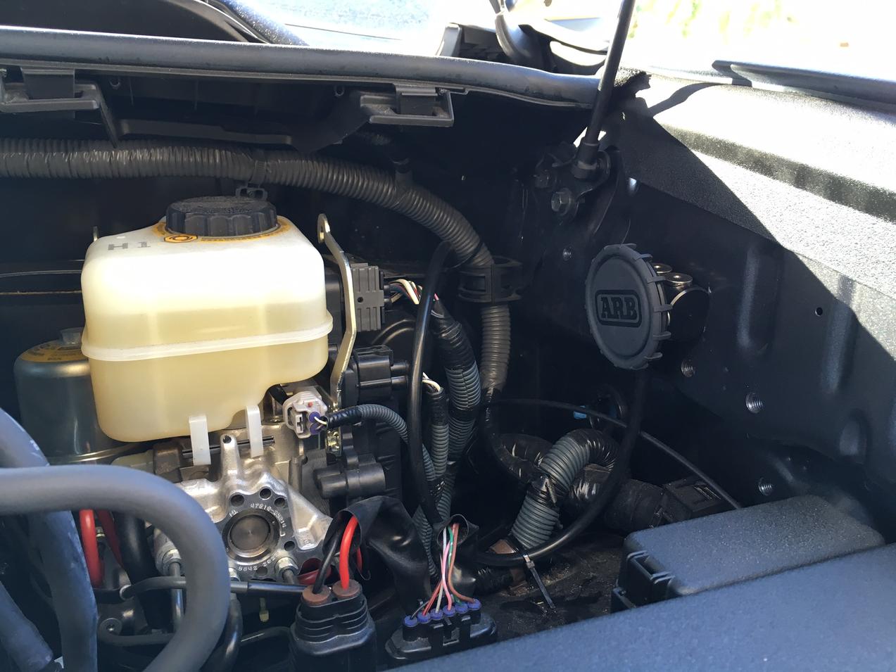

Differential breather in engine bay
Nice write up. I like that you ran this up into the engine bay. In a couple of photos it's hard to tell which of the several black tubes is the breather tube.
If you ran this over the heat shields you should check the tube again soon and periodically. Those heat shields are for the cat's and exhaust. The shields get hot too.
Thanks again for posting this.
