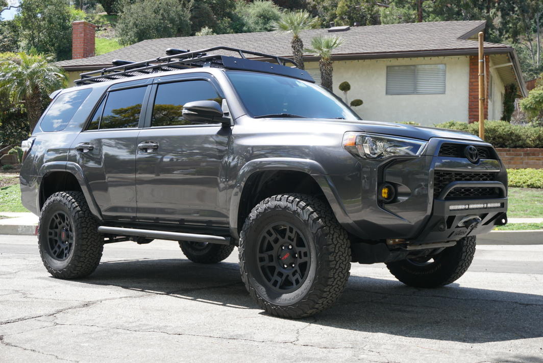

Rear Engine Seal Leak at 23k! May Not Be Warrantied?!

UPDATE: Not going to be warrantied because they said it was "submerged" with mud and debis. WTF?
I have formally opened a case with toyota. Waiting for the case manager to contact me.

UPDATE: The Toyota case manager reviewed the case and although understanding, claimed the mud and debris as "external factors" that void warranty. I explained to her that I purchased that car with the intent to use it for what it was built since it had 4wd and a-trac. I never abused the car and there's absolutely no physical damage. I asked how can go off-road and avoid mud, dirt, and water?
Either way, I still have to pay for it, but the case was settled far from the 2k+ price estimate.
At this point, with my work, I need the car back, and I felt it was the best outcome in this unfortunate situation.
