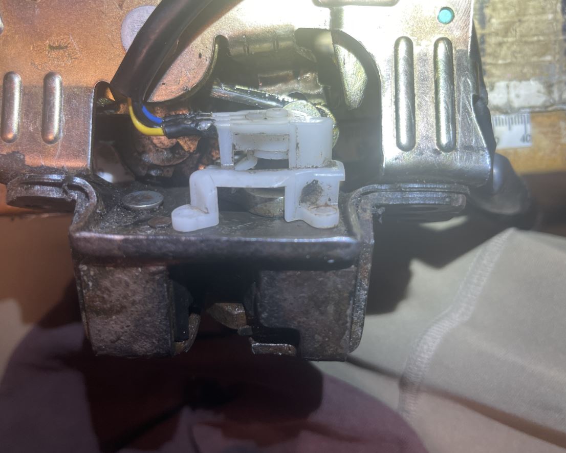

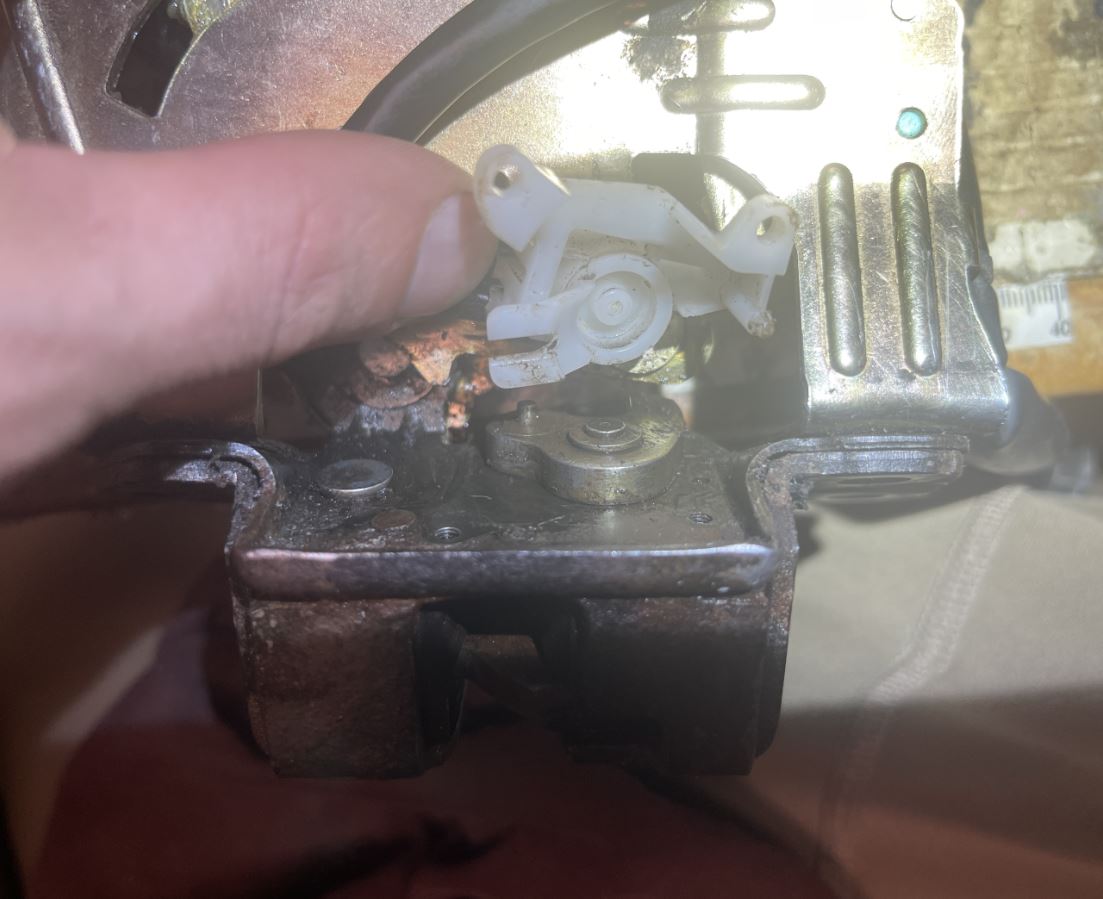

This is the cause.
The problem with rear hatch latching shut and than a second or 2 later unlatching is because of the switch on the assembly. For some reason the switch thinks its in the open position and causes the actuator to open even when it should be closed. The fix is to buy a new latch assembly or try to fix this switch , but it is most likely wore out and needs to be replaced.
