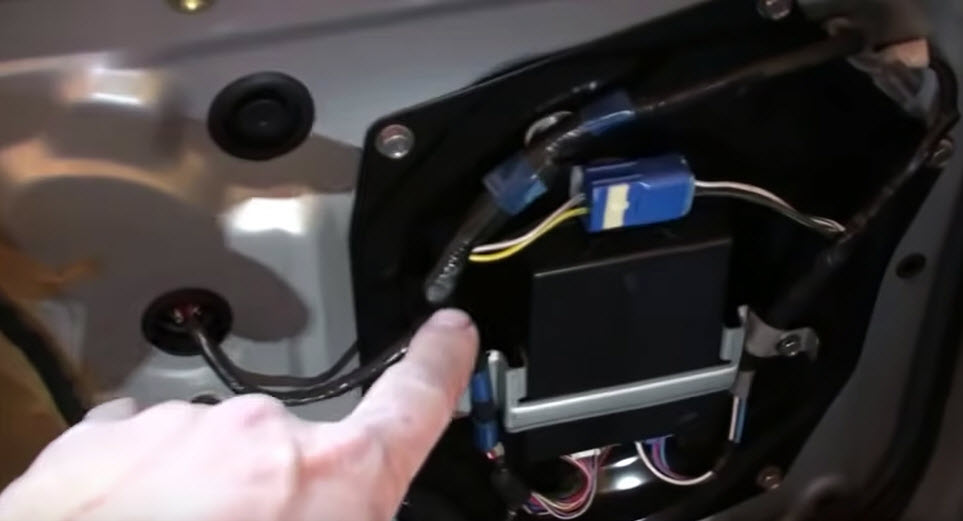

I have come across a few threads here on problems with the rear hatch. Here is a link to a YouTube video that shows you how to open up that area and get at the components.
https://www.youtube.com/watch?v=sSNMyV9ZOfE&list=LL&index=3
If you're able to make the hatch work sometimes I would guess that it's the ECU, which is easy to get to. I have a 99 Sienna that had problems with the power door. It acted up for a couple of years (not opening, not closing, reversing on its own, etc.) and I replaced the ECU and it worked fine after that (3 years). Turns out there was a defect in the 98-2000 ECUs. I found a used 2001 ECU replacement on eBay for a fraction of the cost of a new one. It's been 3 years now with no problems.
TOYOTA 4Runner HATCH TAILGATE LATCH REPAIR - won't open - YouTube
Is the ECU the entire locking assembly as seen here? Rear Tailgate Actuator Door Latch Lock fit 2003-2009 Toyota 4Runner 69110-35090 | eBay
Or is it a different part?

It's a different part. The ECU is the electronic control unit. It's the electrical part that controls the defroster, wiper and rear window. Your image is showing the mechanical part for the door latch.
Here's on on eBay
Toyota 4Runner 2003-2009 Tailgate Liftgate Multiplex Control Module 89222-35010 | eBay
Wouldn't the fact that my window, wiper and sometimes kinda door motor still work make it seem like it isn't the ECU?
Very genuine question on my end as I'm pretty oblivious to all of this.
Like anything electrical, it can be hard to diagnose. My '99 Sienna's power door acted up for years. You'd press the button to close it and it would close then immediately reopen. Sometimes you'd press the button multiple times before it would close. Sometime I could put it into drive and press the button, the alarm would sound but the door would close. Sometimes I had to turn off the engine and slowly pull the door shut. Eventually it quit working.
Since you're getting the latch to sometimes work by disconnecting the battery seems to me that the mechanical part is working (along with the defroster and wiper) but the ECU is having a problem with the latch mechanism. When I replaced the ECU on the Sienna the power door worked fine after that.
If you've tried oiling the mechanism and you don't see any rust or contaminants visible on the mechanism, to my way of thinking the only thing left is to replace the ECU. You could take it to the dealership and have them check it out but not replace anything. Just see if they can confirm mechanical or electrical. Maybe they will not charge more than a half hour of labor for that.
