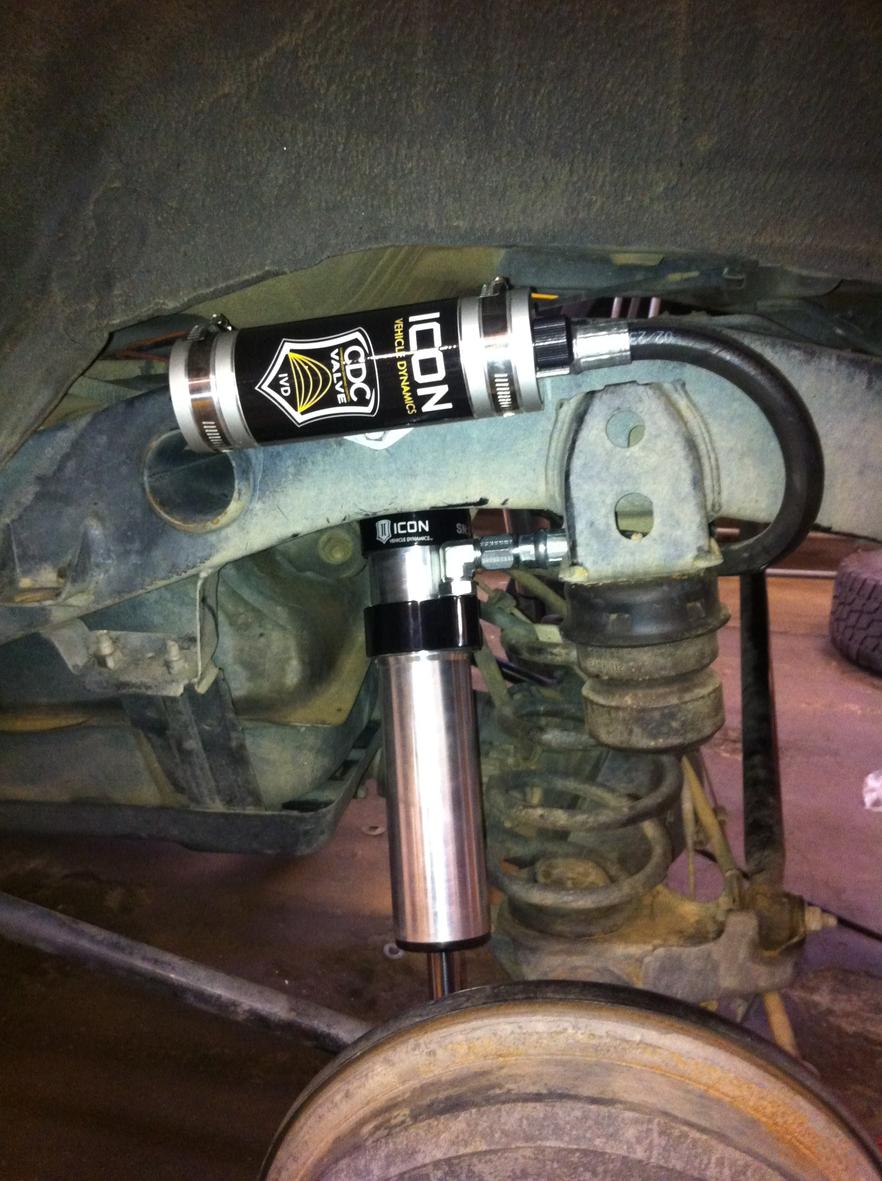

I have the icons in the rear but remote reservoir instead of piggyback. If you add the adjustable CDC valves you can dial them in anyway you like. For the rear coil I have OME's. I love the way it handles and I have no sway bar in the rear.

Here is a pic of the rears. One thing you need to do when you mount them is to grind the corner off of the bump stop mount so it does not rub on the reservoir hose.
