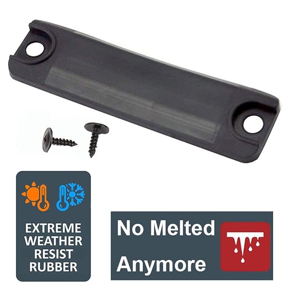

Sorry for bumping an old thread, No Melted Anymore - Made of Durable Rubber Material, Replace Your Melted Rear Hatch Latch, Don'T Have to Replace the Entire Latch, Just the Rubber Cover.
https://www.amazon.com/Release-SEQUOIA-4RUNNER-Liftgate-Replacement/dp/B01BMMXOMU/
5th gen 4Runnr lift gate rubber melting and went to dealer to replace it and asking 400+ dollars part and labor. They described the entire internal cover to be removed and the whole switch with rubber cover to be replaced. I did bought the part from dealer ship for about 90 dollars. Also bought form Advance auto mini tool wrench with multiple Philips head screws. Just from the outside unscrew the two screws and pull the switch to pull down, remove the old one cleaned the old rubber and replace with the new one. Put the screw back and everything works perfect.
I hop this will help someone.
This is a very late reply to your post, but I bought the little $9.00 kit on Amazon (which included the silicone rubber cover and "S" shaped phillips-head screwdriver) to change out the switch cover. The 2 screws in the factory unit were firmly frozen in place and defied removal. The cover was a gooey, tarry mess (my wife had been complaining). SO, I had to remove the switch to get more leverage on the 2 screws, ended up using a needle-nose vise-grip to get them off. The end result was I got it back together cleaned up and spent about 3 hours, most of which was cleaning the mess out of the switch and surrounding trim. I was glad to save the $$ I would have spent for the new factory part, but I think next time I might spend the $$ and avoid this mess.
