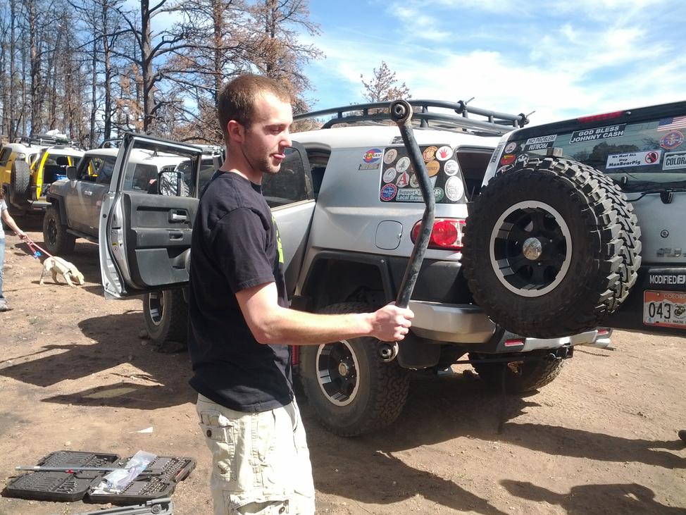

Stock rear lower control arms are known weak links and vulnerable to rock damage.....
Upper link damage ...:nono:
Panhard bar damage....:nono:
