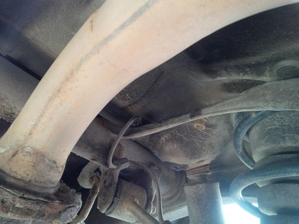

Well, it was long past time to replace my sagging rear springs. I found some lightly used 906's on Craigslist and decided on Rancho adjustable shocks. I do some weekend backroads, some highway driving and in the Summer, tow my sportboat, hence the adjustables. I was really tired of huge sag, when hitched up, and it was really uncomfortable bordering on unsafe. Here it is before the replacement:

All the threads I've read, all agree getting the top nut off is a pain! There's reall not much room!
Starting off:
poleclimber63-albums-rear+springs-shocks+replacement-picture39841-painful-part-removing-top-nut.jpg

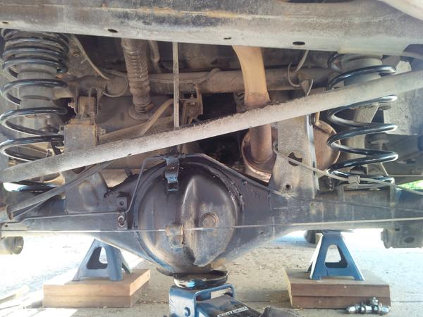

Step 2
- place a jack under the diff
- jack the diff up to take the pressure off pan hard bar
- remove the bolts on the diff to detach the brake line and e-brake cable from the diff
- remove the pan hard bolt

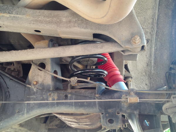

- remove the shock top nut
At this point, I struggled some with the top nuts. I bought Visegrip chain strap which made the difference. I was able to work the outer cover (strapped) and the top nut.. This skinny guy must be stronger than he thought! Both shock shafts snapped at the top nut!!

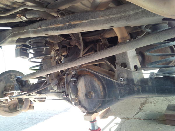

- lower the diff and push down on each drum and pop out the springs.
- place the bump stops in the new springs and place the new springs in place, ensuring the coil end is sitting in the diff seat tight.
At this point, I wire brushed/ wire wheeled the rust off and applied Rustoleum.
poleclimber63-albums-rear+springs-shocks+replacement-picture39843-springs-rustoleum-touchup.jpg

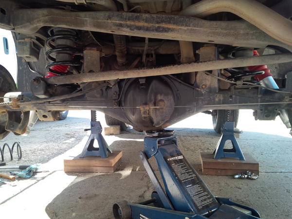

Step 4
- wire brushed the shock seats and lower mounts and cleaned them.
- jack up the diff and install the shocks. I lubed the bushings with silicone grease. Ensure you install the bushings/bushing washers in the right orientation.
- Torque the shock mounts-- lower 50 ft lbs, upper nut 14 ft lbs
- jack up the diff to roughly align the pan hard bar and mount. I had to jack up the opposite drum to get the bolt installed. Torque to 50 ft lbs
Step 5
- replace the bolts mounting the brake lines and e-brake cable. Torque to 14 ft lbs.
- strap the boots and re-mount the tires!
There's really no need to disconnect the brake line, ebrake cable or the panhard bar.
As far as I could see, I didn't want to risk damaging the brake line while man-handling the diff. With the diff dropped down, that centre brake line is quite tight!Try wire brushing the top of the diff with all the brake mounts attached. Removing the pan hard bar bolt provided lots of movement to remove and install the springs. It took 2 mins to remove those 4 bolts. It was worth it to me!
Raise one side of the diff with your floor jack and the opposite side drops, allowing even more room to install the spring than trying to get the entire rear axle to drop. This keeps the center section from dropping so far.
This is in reference to installing springs, not painting the rear axle.
