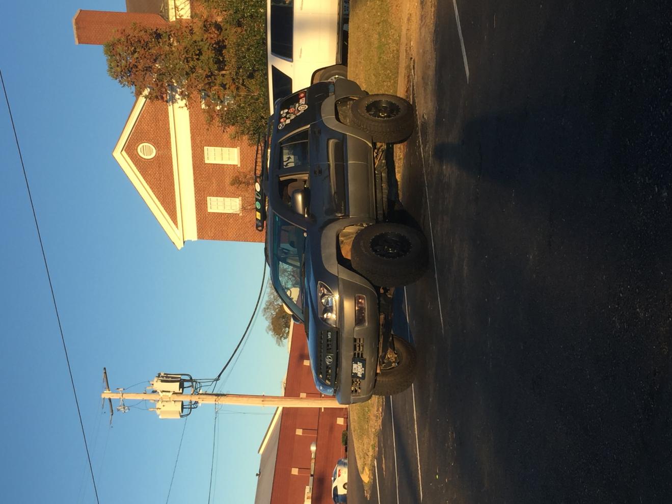

Is that a pic of your truck in your sig? There is no way you don't rub in the front, just from that little picture I don't understand how you could even turn when offroad with your tire so close to the front fender.

I have removed my front mud flaps and trimmed some of the front fenderwell plastic. The only rub I have in the front is at like 30% turn in reverse when the edge of the tire just barely makes contact with the fender. I have no rub while driving or offroading. The big difference between our setups is that you are running tires that are over 1.5" wider than mine, and my wheels are also -12mm offset.
Edit: Also, after a second look, I think the angle of my avatar pic is deceiving.

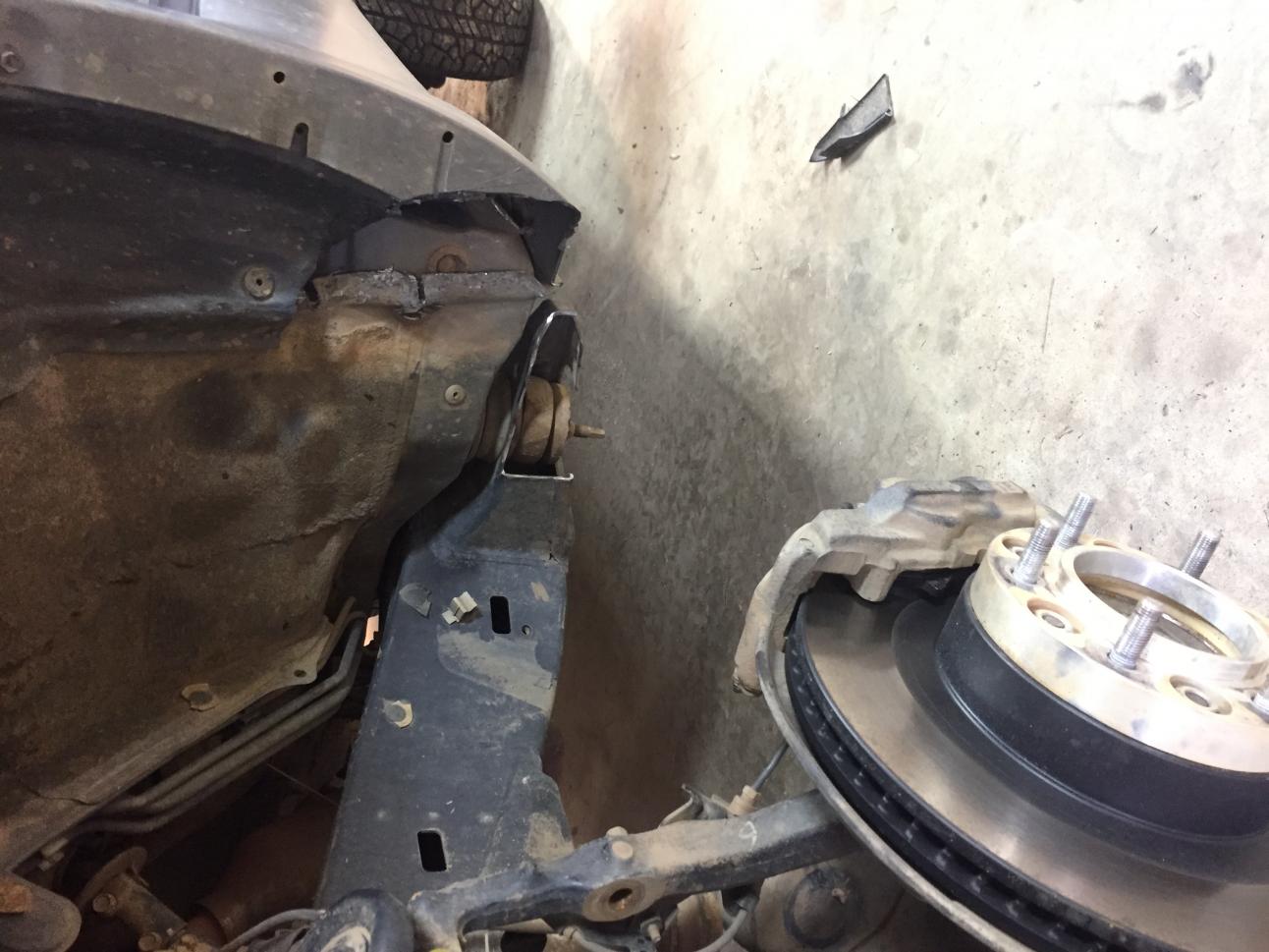

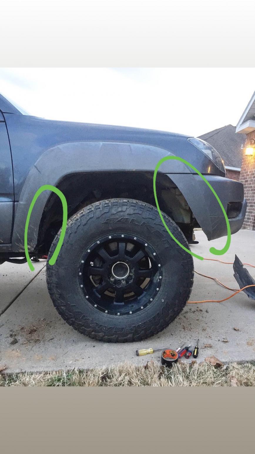

Trimming for 34s

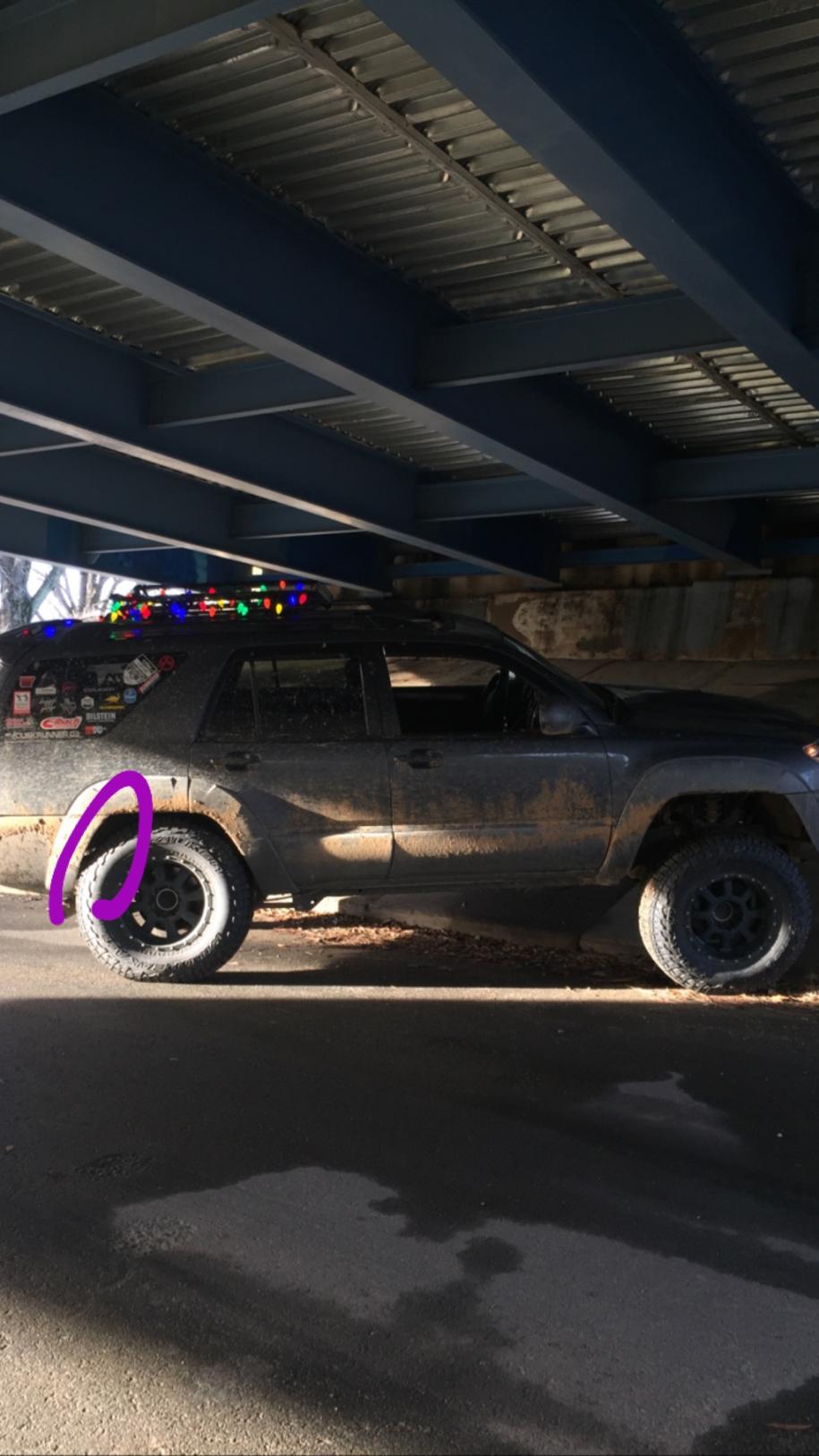

Hi, I think I can be of some help here. I hope you’re talking about 285/75/17 instead of 285/70/17. The first is a 34 and second a 33. I put on 34s back in September with 3.5-4” lift up front and 2” in the rear. I rubbed on my stock bumper with stock UCAs REALLY BAD on the street...I cut off 1” from the front fender including both metal and the flare. I also cut a tapered line from the corner where the fender meets the bumper in the fenderwell with up to 2” cut off the front bumper. For the rear bumper, I had to trim 1/2” off up to the fender. I have 2” bumpstop drops as well as a 1” body lift. Did an aggressive body mount chop and removed all fender lining. Sitting on bumpstops, I still have 1” or more of clearance in the fenderwell when it’s tucked in there. I still rub on the firewall/body mount some with stock UCAs when flexed out. I really tried to make the cuts as clean as possible.

Running 295 70 17 mud terrains, I have metal tech lower rear arms which I extended 1/4”. That keeps me from rubbing on my door fender. I trimmed the bumper side if the wheel well and hammered the pinch weld. I’m running the long travel setup so I have 2” bump stops. My front is cut aggressively, has a caster of 5 and I don’t rub. No body lift.
