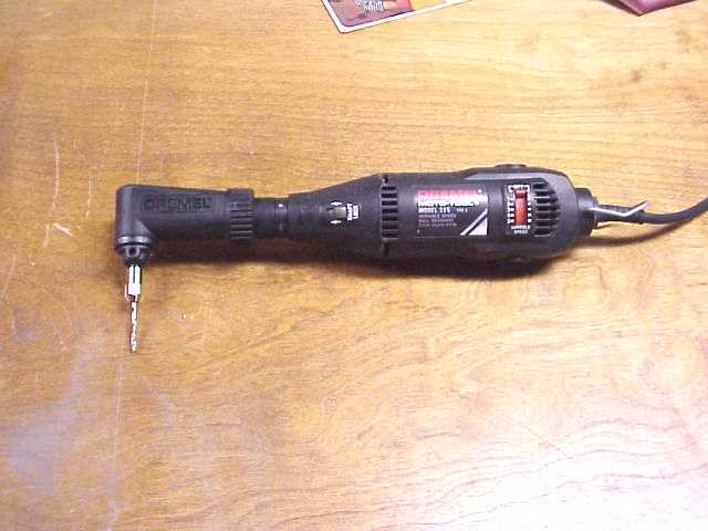

Naaah. It'll be easy with a right-angle attachment for your Dremel and a grinding bit (not the bit in this pic, but you get the idea). Take 2 minutes, including a little touch up spray paint.
I've got one of those but hadn't thought of using it to fix but you're right, thanks for the idea...
