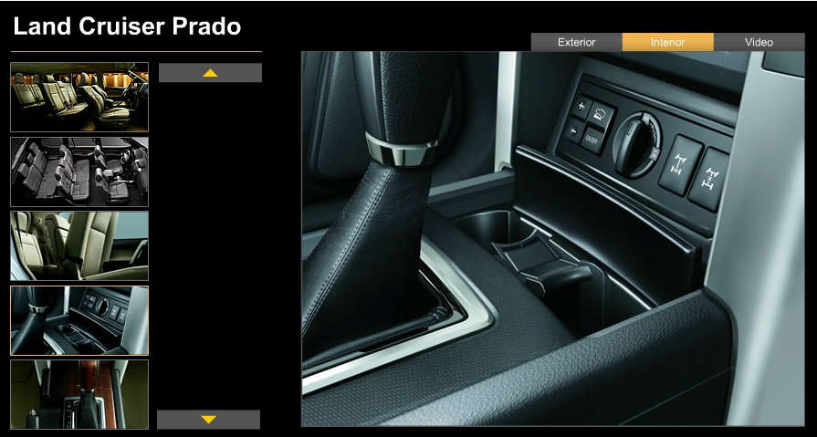

This from the Prado looks nice but it only has two positions.
TOYOTA Middle East - LAND CRUISER PRADO - Performance
C is the switch I was talking about for the center diff.
Here's the landcruiser:
No locker on that one either.

How about the prado 150's switches? Check out the south american toyota website.
Most of the interior is identical to the 5th gen.
Makes me think the mid-year refresh will bring back rear a/c/heat.

stupid how the prado 150 gets a torsen center AND a rear locker and we dont :gun4:
they get a lot more than that.
Philly, there are 2 versions of the tc switch in the prado - download the toyota jamaica brochure and flip through it to see them. One doesn't have the air suspension/leveling
