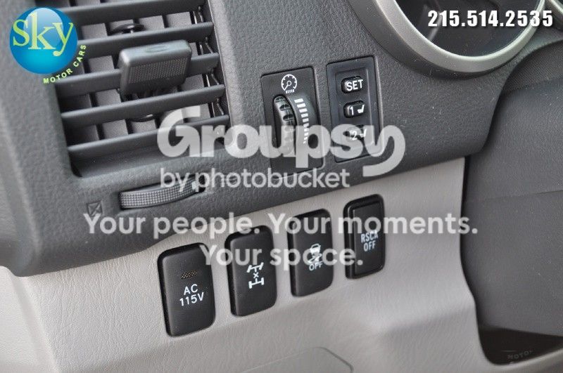

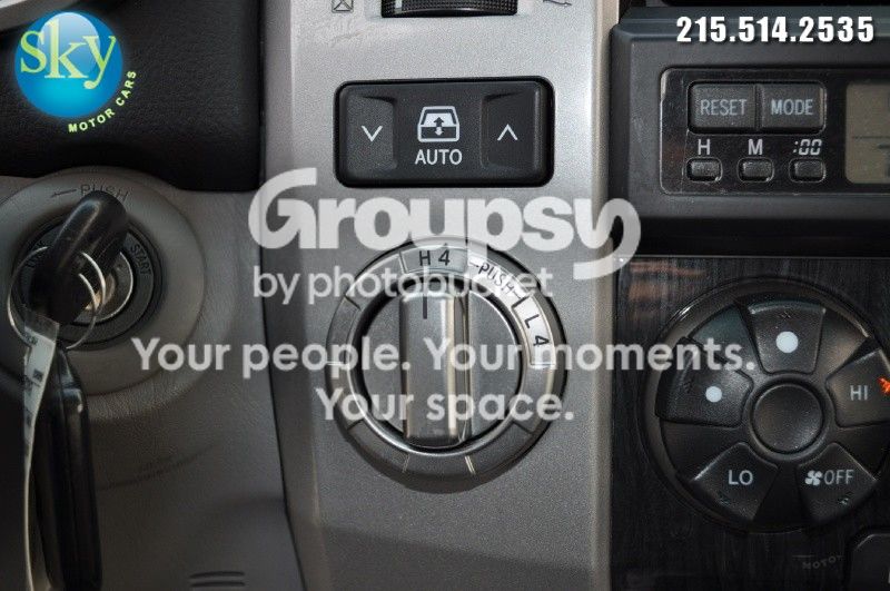

The V6 had multi-mode 2H 4H 4L on the knob and the center diff lock was a button on the left side of dash. The V8 had full time AWD 4H 4L on the selector and the center diff lock button on the left side of the dash. There are some good shots of both dash layouts on 4th gens on Ebay.
Yeah, I had a 2006 V8 Limited and sort of remember the dail. Could you post the links of what you found on ebay?
2007 4x4 V6 SR5
3776722_c3d1bdde-cceb-48c2-a29c-75a25d37f142.jpg~original
3776722_9e66d5b9-6df5-45dd-8b61-65550eb2f33c.jpg~original
2008 4x4 V8 LTD
