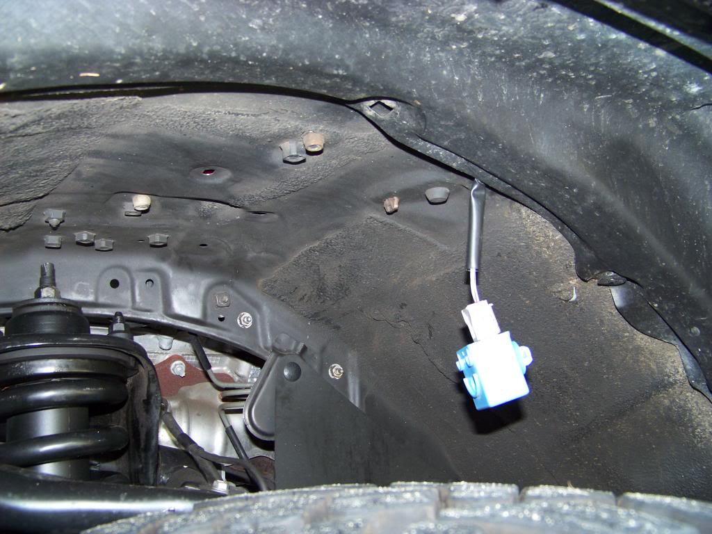

Here's a pic of the "chirper" and a link to my thread that shows how to get it out of it's happy home to mod it....
Antman's "anti-beep switch" mod
