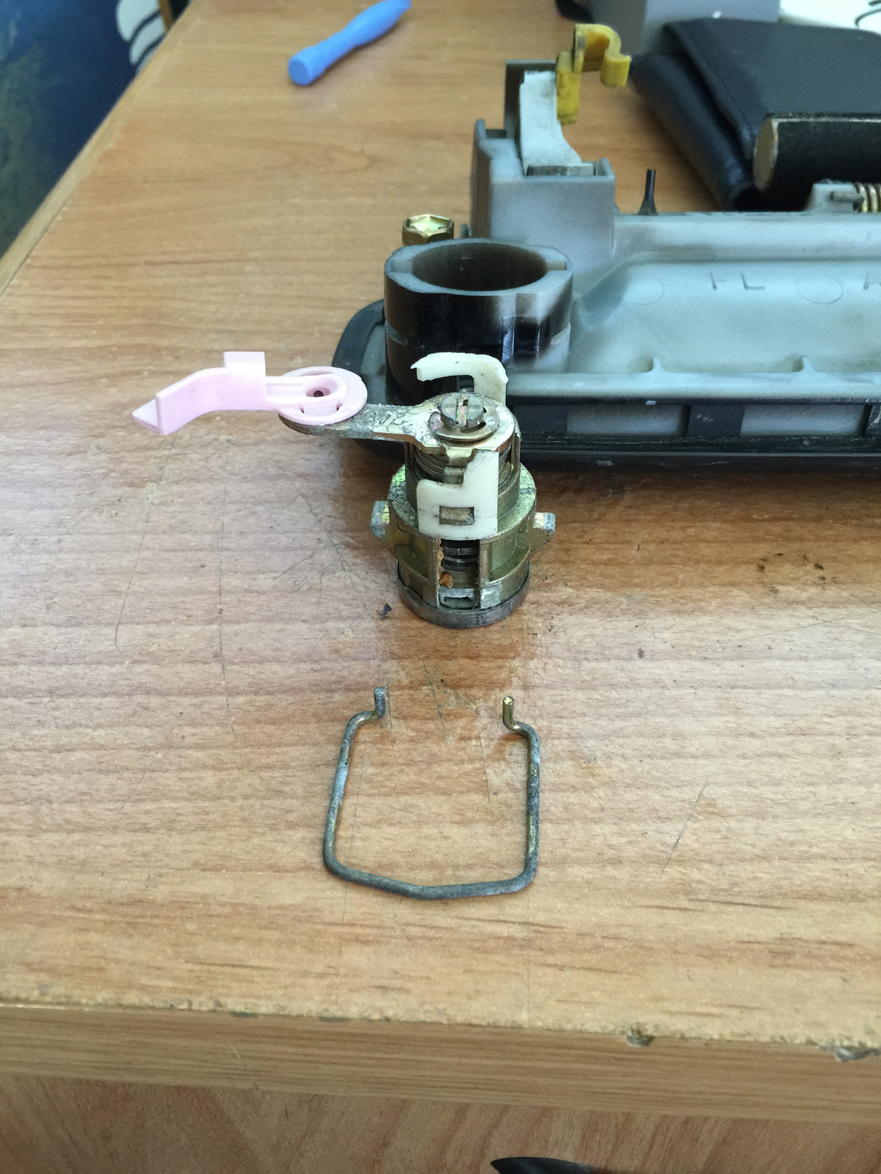

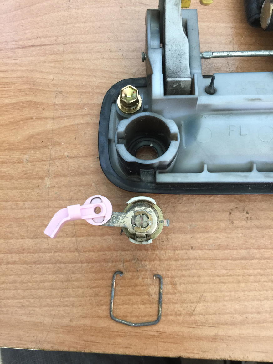

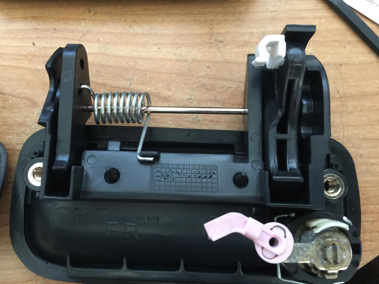

door handles
to remove the handle itself...
there are 2 screws, one on each side of the handle and 2 plastic items as mentioned by SHOOTMYMIME...
you need to flip up and away from the metal rod that goes onto/into them...
see picture of the PINK and WHITE plastic things...
remove the lock from the door handle?
easy! i think the hardest part is removing the door handle itself
there is one little retaining clip....
to reinsert lock... put clip on first and just push lock through until it clicks
