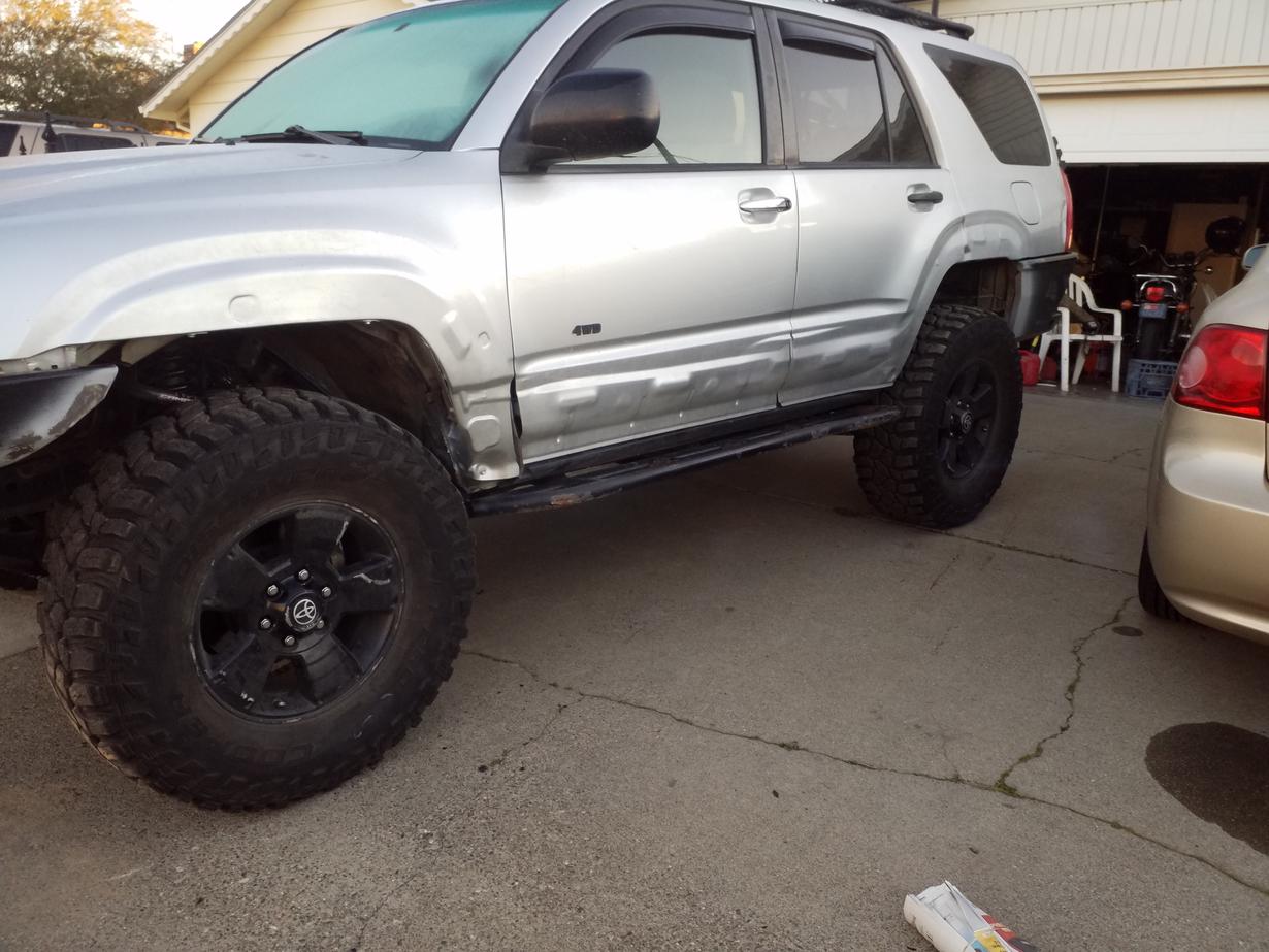

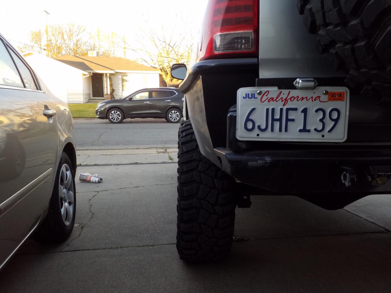

Yes they consist of the 2 types of clips, don't know the correct ones as I did a complete/permanent removal.
I took a flat "L" shape pry bar to remove them. Just slide between the body and flare, and pull hard nod the first clip, after that, they come off with less force. No damage.
Will you post pics of your "flare permanent removal"?
