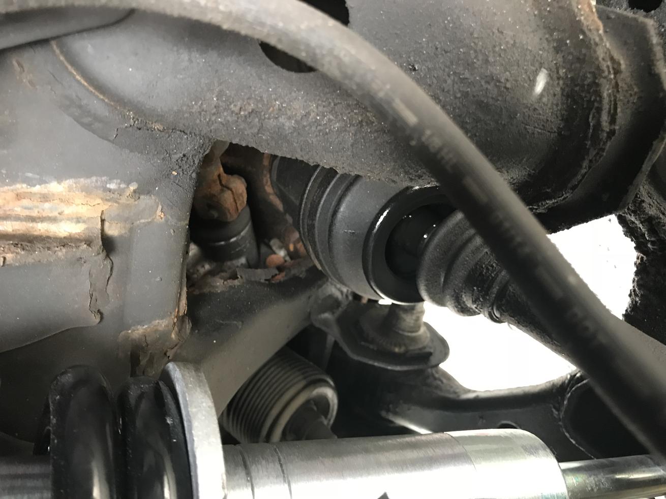

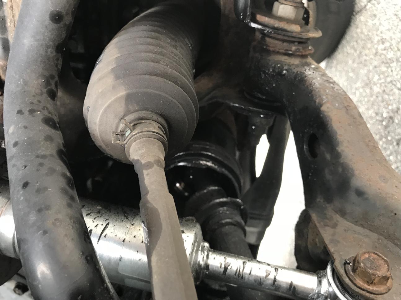

Resurrecting an old thread here but I was just told I need to replace both front. I just installed a lift 3/2 but the 06 I just bought had been sagging for quite some time (it’s got 200k). Anyhow it appears to me that the lift pulled on the old worn boots too much and now I’ve got this. Has this occurred with anyone else?

Yup. Happens all the time. Time to pull them and reboot them if you want a cheap fix and save the high quality OEM axles. Or you can pay $80 an axle for after market replacements.

Get some cvj red boots if your axles are still good
This ^^^^^
This (CVJ) is the best alternative for those who just need to reboot. These boots are longer and stronger and more flexible.
(BTW - cheap CV's from auto stores are often problematic. They are weaker than OEM, often rust easily, have cheap bearings and occasionally they do not supply a new nut, c-clip, and new split pin. I have been wheeling my 4th gen from new in 04. I have seen countless aftermarket CV's break on the trail. IMO always go OEM, either new or remanuf. OEM, unless you don't use your truck offroad. Its not fun changing CV's on the trail. It holds everyone up and just frustrates yourself. I have changed CV's on trails over the years for probably a dozen people. Changing them isn't usually the problem. It's finding a flat ground to get it done!)
