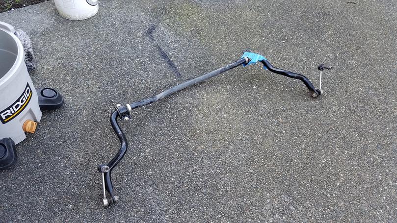

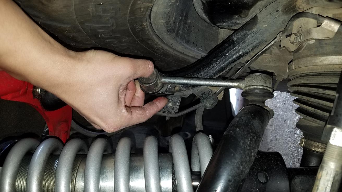

Found out it was the endlinks. Both links oozing with grease after I went some small trails today. Took off the sway and the noise is gone. Going to order new oem links.
You might just run it without a front sway bar and see how you like it. With heavier coils in the front it shouldn't have too much extra body roll. Just takes some getting used to.
