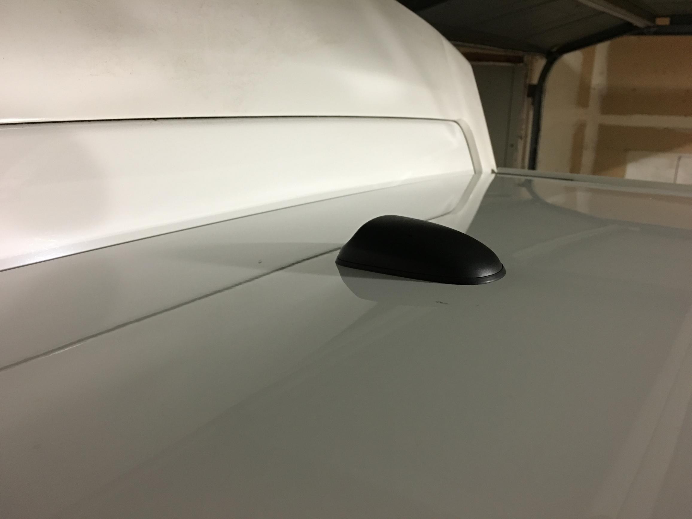

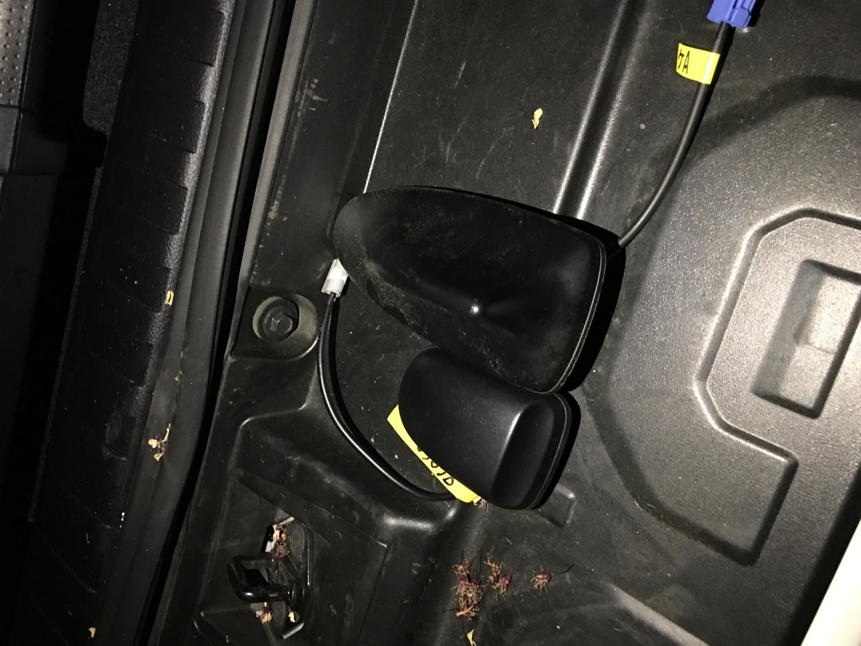

Was able to source a slimmer OEM replacement antenna for those wanting to run the shorter rack or wanting to use the higher rack with a table.
Once I get the rack on I'll update this thread.
