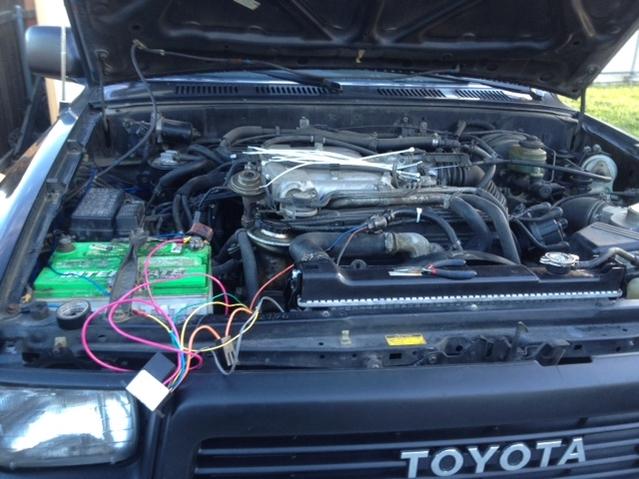

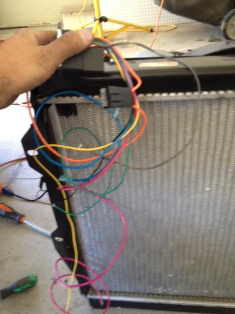

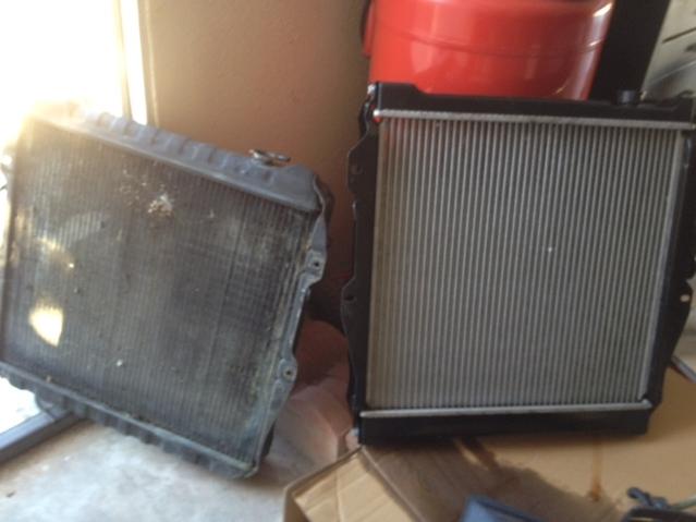

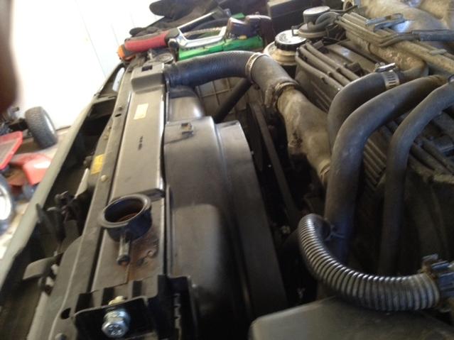

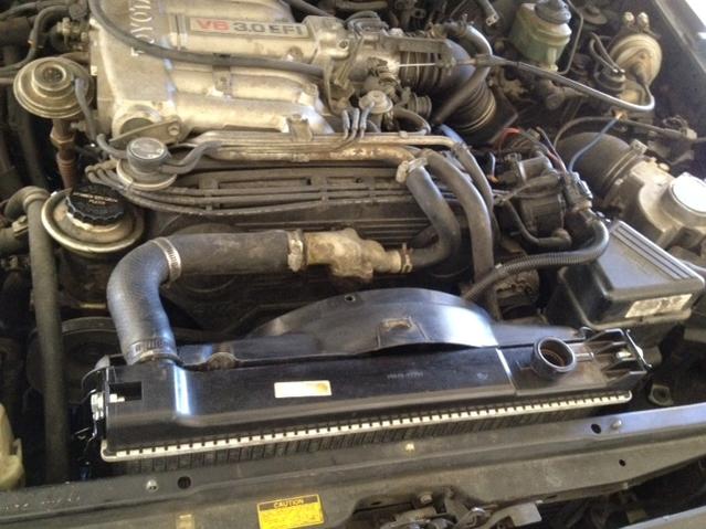

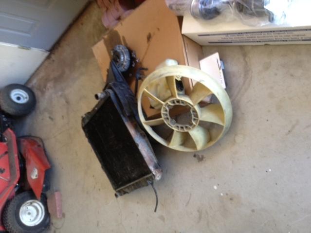

I have a ford taurus electric fan in my 90 4runner with a Haydedn thermostatic/adjustable switch and it automatically kicks on at 190 degrees or constant when the AC is running.no buttons or toggle switches to dik with. I will probably be installing a toggle to cut all power to the fan for water crossings soon though
feel like I whore these pics, but here are a few of my swap and the old stuff I yanked out
