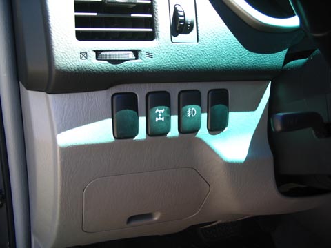

new switch on dash
A10GAC said:
Does anyone have the part number for the 04 Tacoma Fog switch handy?
Yeah I just ordered one last night...
84160-04010 - Taco switch ($33.56)
90980-11090 - is the harness that clips to the switch that will hold the wire plugs ($2.47)
82998-12340 - wire plugs ($3.77/ea) 4 Req'd
Got it from 1sttoyotaparts.com... cheaper than Partznet.
Thanks for the info, $33 is a bit pricey for a switch but it's worth it for a completely clean install.
