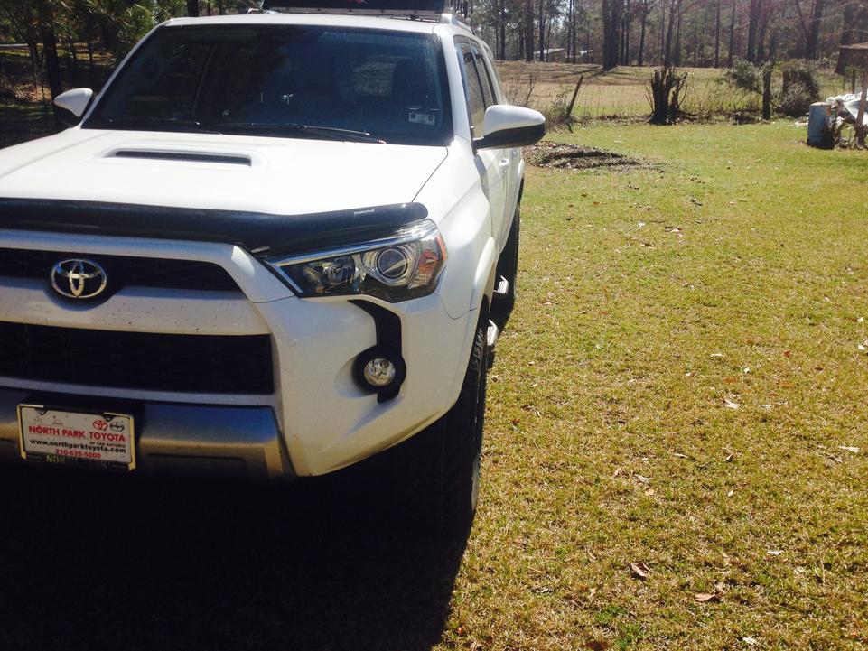

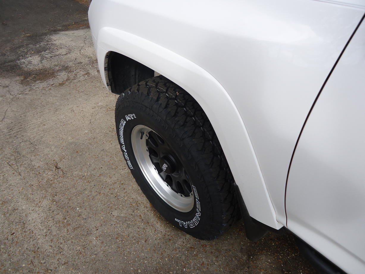

Different rim but same dimensions and back spacing as your Pro Comps, with factory size 265-70/17 tires.
