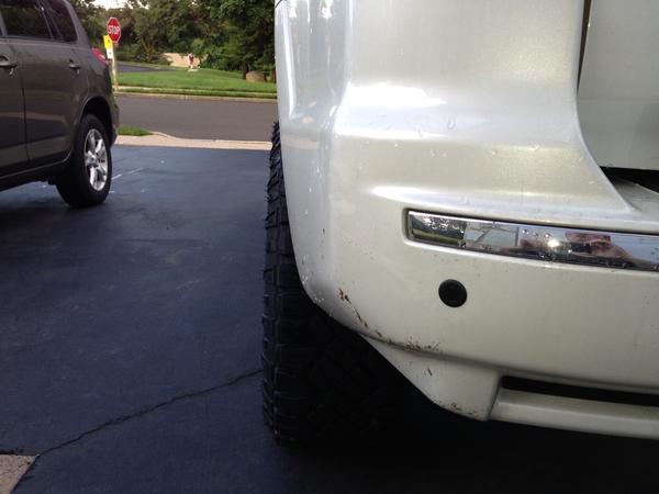

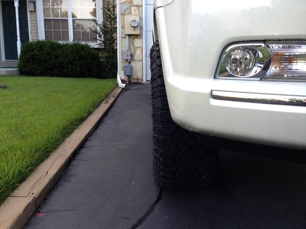

I dont know if it is exactly what you are looking for, but i'm running Icon Extended Travel up front with Ultra Gauntlets in 18" with 0 offset and DuraTrack 295/65/18. With proper alignment and some trimming of the fender lining no rubbing and they stick out good amount. Picture does not do justice:
front
rear

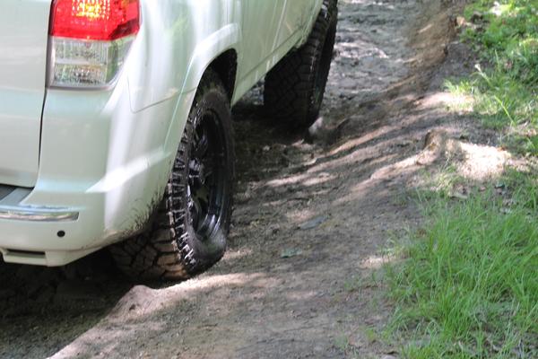

I don't know if you consider this a wider stance or not, but its SIGNIFICANTLY more aggressive than the stock LE stance. I am not running spacers at all. I my wheels are 18x9 with a -12 offset. It doesn't go much past the fenders, but its certainly a more aggressive fitment.

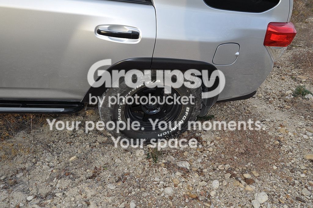

Sticking out past the wheel well.....Just be aware that when actually offroading and stuffing a rear wheel with that aggressive/wide stance of wheels and tires that you will hit the rear fender and ruin your tires. Ask me how I know!The wheel has to clear to the inside of the fender.
This is stuffed with a 8 inch wide/4.1 bs wheel and a 305/65/17(33") with it barely clearing and use your imagination if it was sticking out another inch or so. I stepped up to a bigger tire 305/70/17(34") and hit the fender lip and ripped some lugs off the tires and have to use bumpstop extensions to limit the up travel now . Let's see some offroad pics of these peeps with wheels sticking out past the wheel wells when stuffed .:confused:

Mine look like that Harper. I am at the absolute limit of clearance when my fronts are stuffed, and if I am turning they rub. The rears are ok. I do not plan on going any larger.

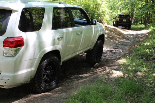

I agree with Harper for sure that wide stance tires can be damage. Here is mine stuffed, but I have 3" bump stop that prevents my damages.
