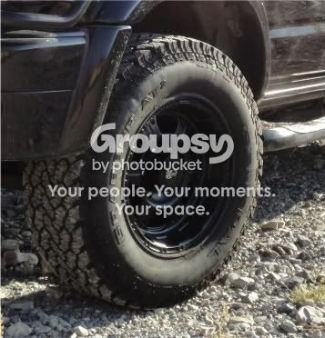

those first ones dont look too bad, I know i have the porcomps you have posted there and im not a huge fan of how the hub sticks out, but then it does make it kinda cool. You should be able to get the procomps for cheaper. I think i paid $90 a wheel at Discount Tire a few years ago.... but then it again we are in a recession. Just find some cool guys that think your truck is bad ass work a deal. I cant wait to see them on your rig man!
BTW the procomps clean up real nice too!
spitshine016-2-1-1.jpg~original
I like the pro comps also. The price was the only thing that the v-tec wheels had over them. I just need to shop it and find a good price.
i forgot that i i did this but i found the procomps in the 4wheel parts magazine and they were listed at $90 a wheel, i showed Discount Tire the price and they matched it. Yeah i think they wil look bad ass on your truck!

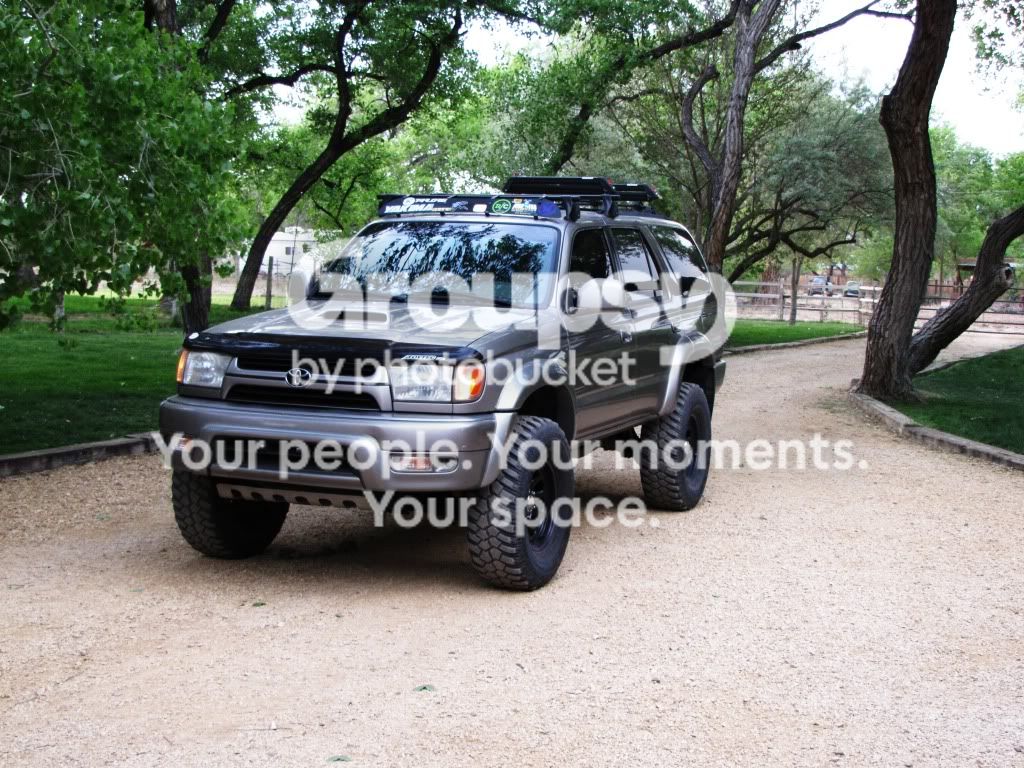

Another recent picture. Just because she looks so purty.
IMG_0515.jpg~original
