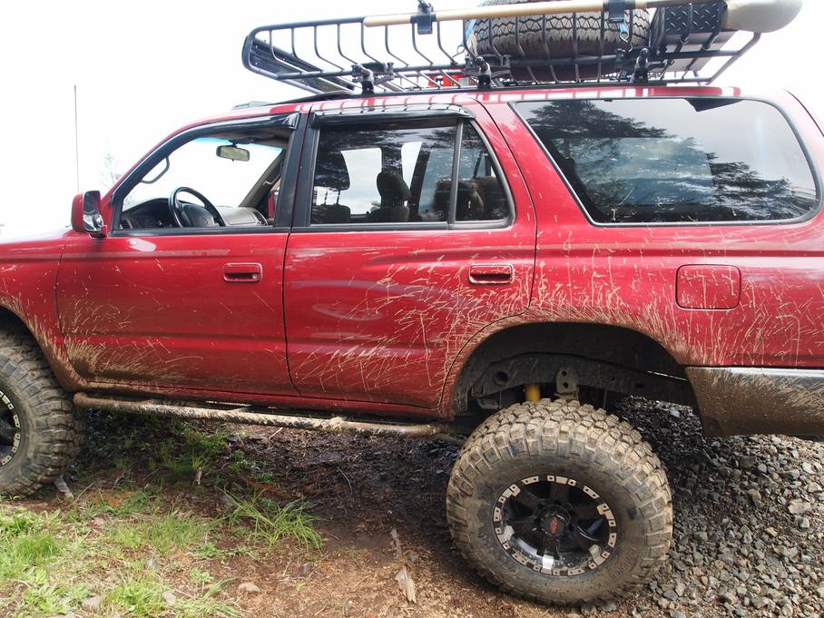

True, I had close to 3.5" and may have had more, but I have a 33"tire where the normal spare is located which tends to bind my panhard bar. Eventually I want to do a custom swing away but that costs money, and I haven't figured out how to grow money..
Here is a picture of my 97 with 891's...
The ride was stiffer and removal of the sway bars did help it to be smoother and flex a ton!! Unfortunately I had to get rid of it because I couldn't shift anymore..

<a data-flickr-embed="true" href="https://www.flickr.com/photos/149794382@N06/34700373433" title="20160515-IMG_1538"><img src="https://farm5.staticflickr.com/4207/34700373433_3e0c83f53c_b.jpg" width="1024" height="576" alt="20160515-IMG_1538"></a><script async src="//embedr.flickr.com/assets/client-code.js" charset="utf-8"></script>
Also note that with the bumper that high (or just if you are installing it without a body lift in the first place) you will need to cut a notch out for the AC line as mentioned in the post about the initial install. See this pic
<a data-flickr-embed="true" href="https://www.flickr.com/photos/149794382@N06/34686724093/in/album-72157682479241254/" title="18451686_1541574065862391_519321999138030348_o"><img src="https://farm5.staticflickr.com/4289/34686724093_d4894f46e4_b.jpg" width="1024" height="683" alt="18451686_1541574065862391_519321999138030348_o"></a><script async src="//embedr.flickr.com/assets/client-code.js" charset="utf-8"></script>
