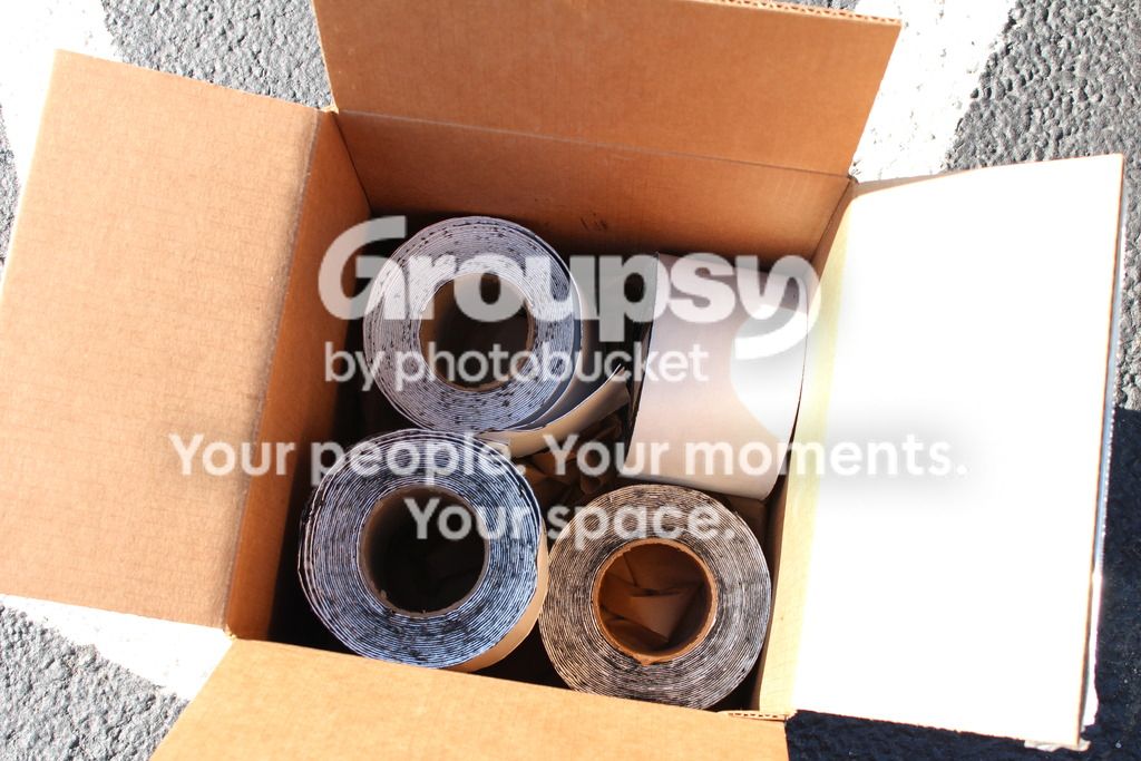

Following with my Stage 1 plan of building a solid platform, the first actual mod will be Sound Deadening. I followed [MENTION=5602]Rock Slide[/MENTION]'s build for where to buy materials. In his build, he also opted for new carpet padding. I chose to reuse the stock padding as it was still fine.

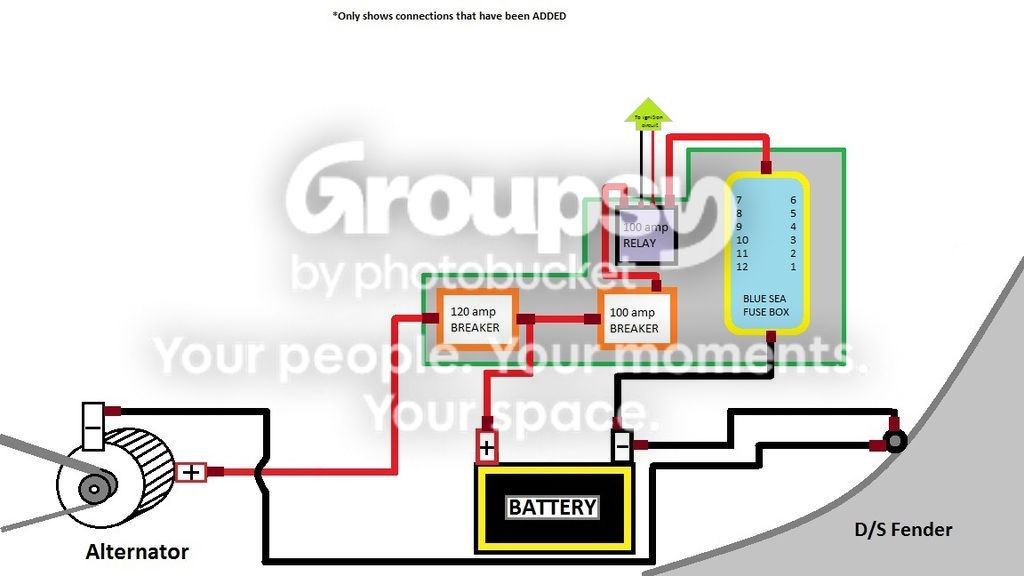

Hey Jim, I noticed that you don't have the power converter on this diagram, and although you did say that this was the diagram for just the fuse box, I also didn't see the connection on your battery from the photos. Did you route the converter through your fuse box? Or am I just not seeing it on the battery terminal in the photos?
I'm trying to get all my ducks in a row so I can do all of my wiring at once. I just ordered a fuse panel from you, and was planning on running the panel exactly as you have yours, but with a power converter.
I just removed the inverter because it failed and almost caught the truck on fire. You can still reference the old diagram if you plan to install one though.
Oh Crap! ....was that just the model you bought, or did it have to do with the location or something else? I planned on getting a good sine wave inverter so I can run my laptop safely, and was gonna run it back to my cargo box.
It was a really old coleman inverter. I would not be concerned with a modern unit from a reputable brand.
Rip—really interested in this sound deadening mod. But I can't seem to find the P/N or where to buy this stuff on that website. Any tips for purchasing this for my '97 SR5?
Much obliged!
I mentioned the part number in the post you took that quote from.. see below.
Parts/Cost:
$84.28: (5) Rolls of 4"roofing mat (McMaster-Carr 9640T1)- I actually bought 7 rolls, and only ended up using 4. I say 5 if you plan to do the doors. They also sell 6" rolls, but I found 4" was better for the tight areas.
