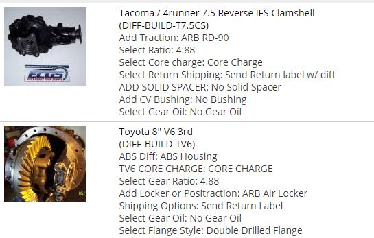

Lockers & Gears are ordered! Current ARB promotion includes a free High Output compressor when you order two lockers.

No prices? Lol
I spec'd out the exact same thing a few weeks ago. ECGS sounds like the way to go but I might end up doing it myself. Just depends on how long the wife will let me keep the rig down. And if I can find someone with a little diff experience to double check my work.
Congrats on the purchase and may they serve you well.
No prices? Lol
ECGS was still thousands of dollars (yes, multiple thousands) less than a few local shops I talked to. I got diffs from them on my last 4runner too, they are amazing to work with. Highly recommended.
I do a lot of stuff myself, but setting up diffs is one big area I leave to professionals. Let's hope its worth the money, busy wheeling season ahead.
How difficult is it to replace the front diff? I too took advantage of the ARB sale and bought rd132 a few weeks ago. Not regearing at this point and having one of my friend install the locker for me. I wanted to go ECGS route for front and rear but couldn't justify spending ~$3200.

So jealous! Just one question on the rear gears... don't we have ABS rings near the brake drums? Is "ABS Diff: ABS Housing" correct? Maybe it's different for your '02 versus my '98.
Right you are. I will have to fix that.

Getting the front diff in and out is quite an annoying job. Its time consuming and you have to take a lot apart. It will be a few weeks before any parts are here anyway.
I would very much agree with the front being a pain in the a**. I found it was easiest to pull the motor mounts and lift the engine up slightly to give the clearance to get the diff out. You can do it without though.
