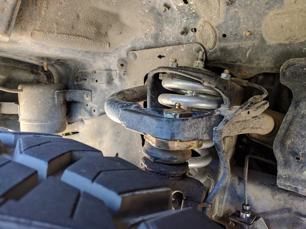

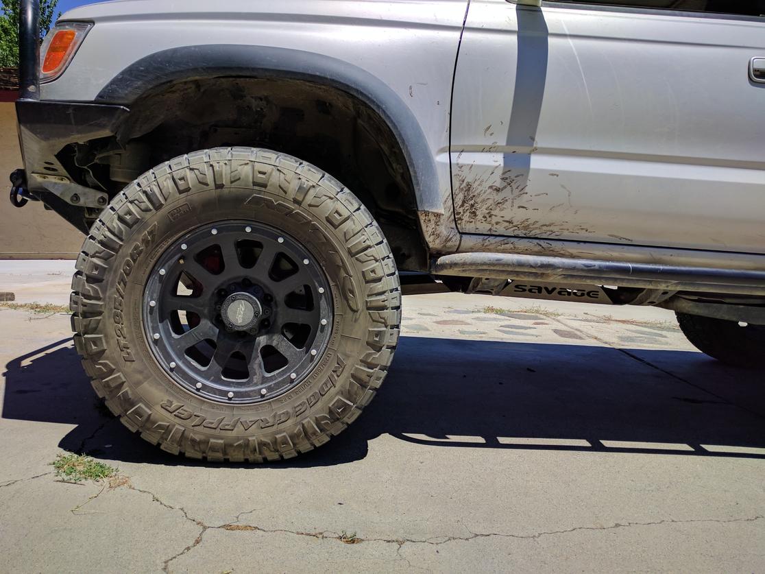

You know the old saying about opinions. Here's a few shots of mine. The arms are set to E for 1 degree positive caster. That pushed my tires far enough forward to gain all the clearance I needed for 295/70r17(33.3"). I'm pretty sure you'll clear 35's if you've beat the crap or grinded the pinch welds. So in this *******s opinion thumbs up.. lol
Good to know how that position worked out for you. I was looking at the chart and some other threads trying to figure out where I wanted to try setting it first. I think I will try E first.
FWIW mine is set on D and I'm pretty happy with it. Curious to see where you end up with them!
Also, I really like that washer bracket/relocation. So nice.
You have also tubed your firewall though. I have only trimmed and hammered the area down.
The arms are set to E for 1 degree positive caster. That pushed my tires far enough forward...
FWIW, adjusting caster from the top yields opposite results from adjusting from the bottom. Meaning, 1* positive caster would move your tire BACK- if adjusted from the top. But wait, are you saying 1* TOTAL positive caster? Or +1* from the UCA itself? The appealing part of the SPC arms- to me- is the camber adjustment. We have plenty of adjustment at the lowers to get good caster, but we end up with pos camber- using the camber adjustment of the SPC, we can pull camber back to 0. To get the tire furthest away from the firewall, max caster at the lowers, and pull camber back in at the top.
One total. SPC arms are set with 2 degrees positive caster. So by going to E you loose a degree and push the wheels forward.
http://www.spcalignment.com/instructions/25480-INS_WEB.pdf
FWIW I'm running C (maybe B?) setting and LCA's at max caster. I rub the shit outta the front of the wheel well with no BL even after moving the battery over and BFH. Planning on adjusting the LCA back to be centered and going for B or A setting. No firewall rubbing issues after tubbing.
