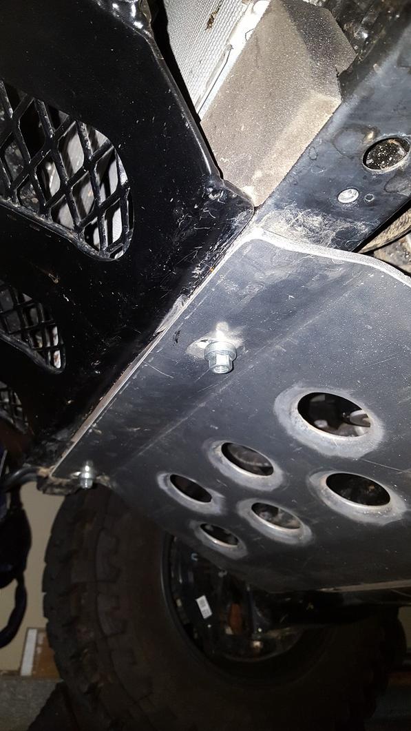

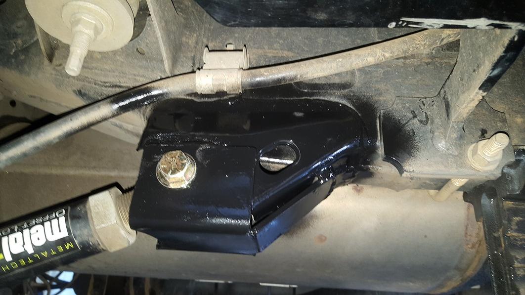

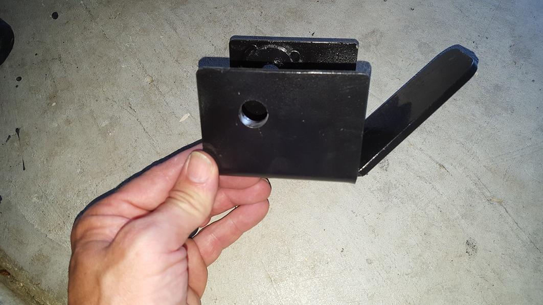

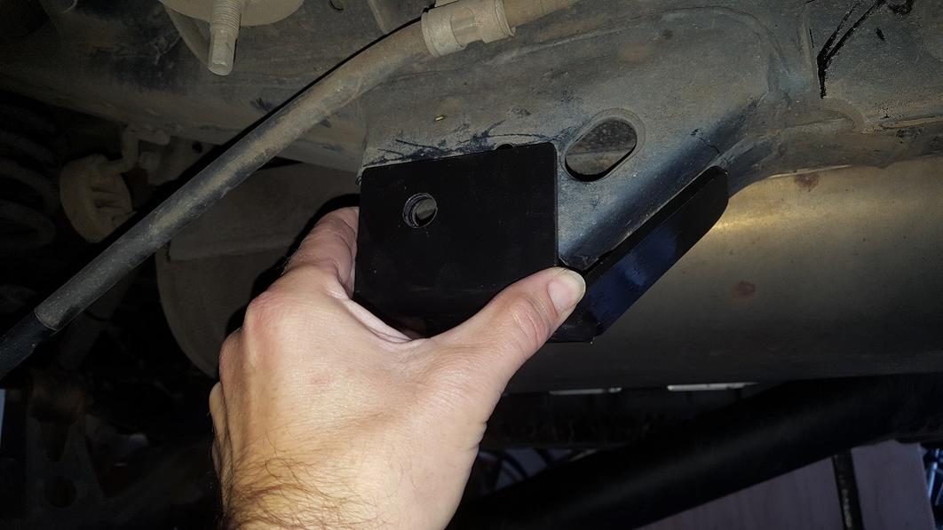

On to the lower link armor. This went fairly smoothly. I was shocked. Did one side at a time, got it all fitted up and welded into place. Since I had access to all the zerk fittings, greased everything up, too.

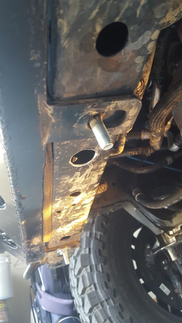

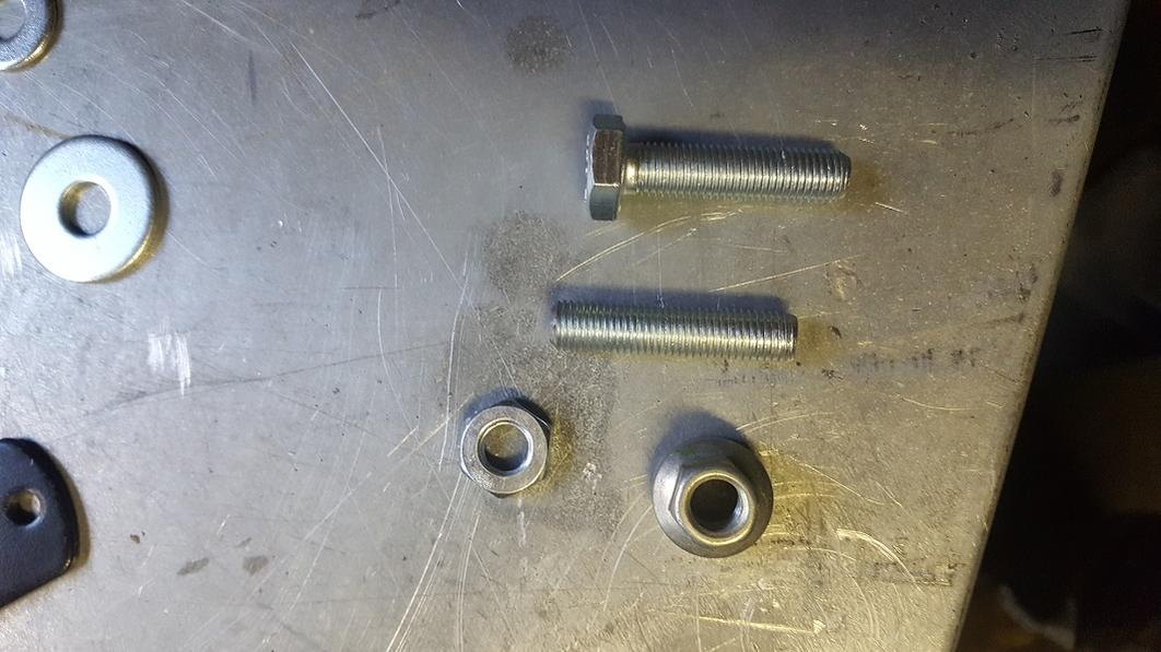

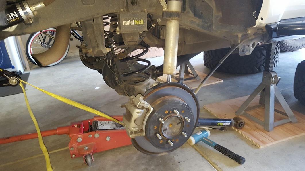

Then onto the front skid mounting issue. One of the nuts that was welded inside the frame popped off, so there was no way to attach the side on one side. I thought for some time on how to get this fixed. I bought several bolts in various lengths of the appropriate size and thread pitch (metric) and cut the head off in order to make studs. Then I decided to drill out a hole a little larger in order to fit a nut into the opening and carefully slide over into position. At this point, I took my stud and threaded it into the nut which was now inside the frame. Broke out the welder and tacked it up nice and good and BAM, new mounting point. In order to keep things uniform, I put a stud into the other mounting location with thread lock and all good to go now.

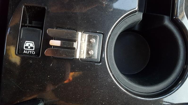

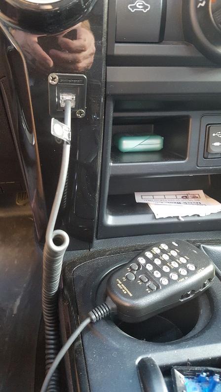

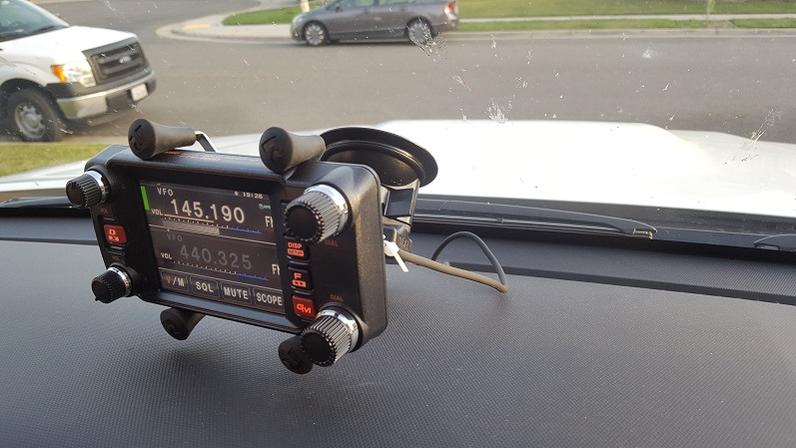

Some updates. A while back, I installed a Yaesu FTM-400DR. The "brain" is mounted up underneath the steering column, right behind the knee airbag. With a little ingenuity, was able to make the bracket mount to some existing points in the area. That and a little persuasion. The next part was extremely difficult, routing the cable for the face plate. Pulled apart the center dash area and popped the little circular plug in the forward center section of the dash right up at the windshield. Proceeded to attempt to fish a wire through there to a point I could feed the cable from behind the dash. (Borrowed this idea from some here on the board.) Once I was able to get the wire through, I attached the cable and pulled it up to the dash and routed the remaining cable to the "brain". Then, since I didn't want to be reaching under the dash to connect and disconnect the mic, I found a nice CAT6 fitting online and mounted in under the fan knob. Allows for easy connection of the mic.

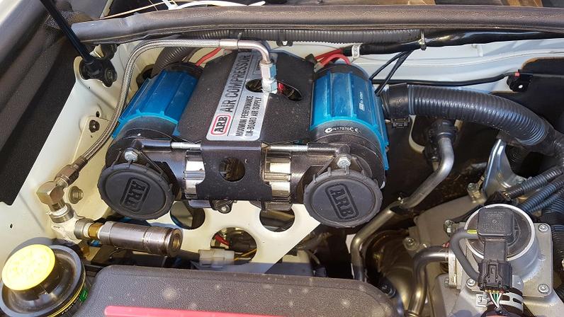

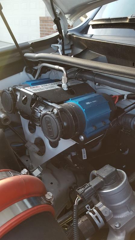

Since there is a post about ARB compressor mounts, here is the one Luke at 4X4Labs made for me.

Dig the HAM mount with the remote hand held plug. Makes me rethink my set up.
How did you do the plug? Where did you get the goodies?

To mount the plug, I used a Dremmel with a cutting wheel. Taped up the panel, and marked up the hole as I measured from the back of the plug.
Google Switchcraft EHRJ45P5E for the plug.
