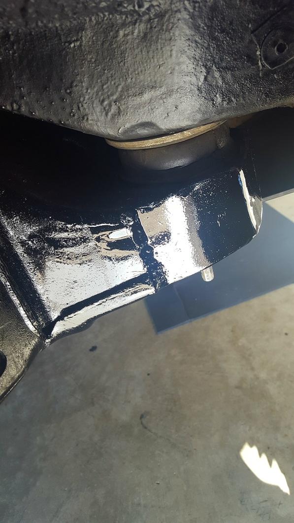

Been having the same problem also. Had cut out the rear bolt location and just weld the hanger on the plate and reinforced. Noticed each time I go out, I have had to cut more each time along the plate. Still need to do some more from our last run.
Yes, it seems every time it gets cut, it gives the axle more room to move. I need to put this in place and cycle the rear suspension to see if I am welding the hanger arm to the plate or if I will be able to bolt it back up.
Same. Since doing a LT setup, had to just move the bracket in as far as possible and kicked forward. Reinfored.
On my 3rd cutting down the length side, going to get extreme this time and test it again before adding side supports. Seems i can only get it to do hits when I'm on the trails, more flex and compress than a loading ramp.

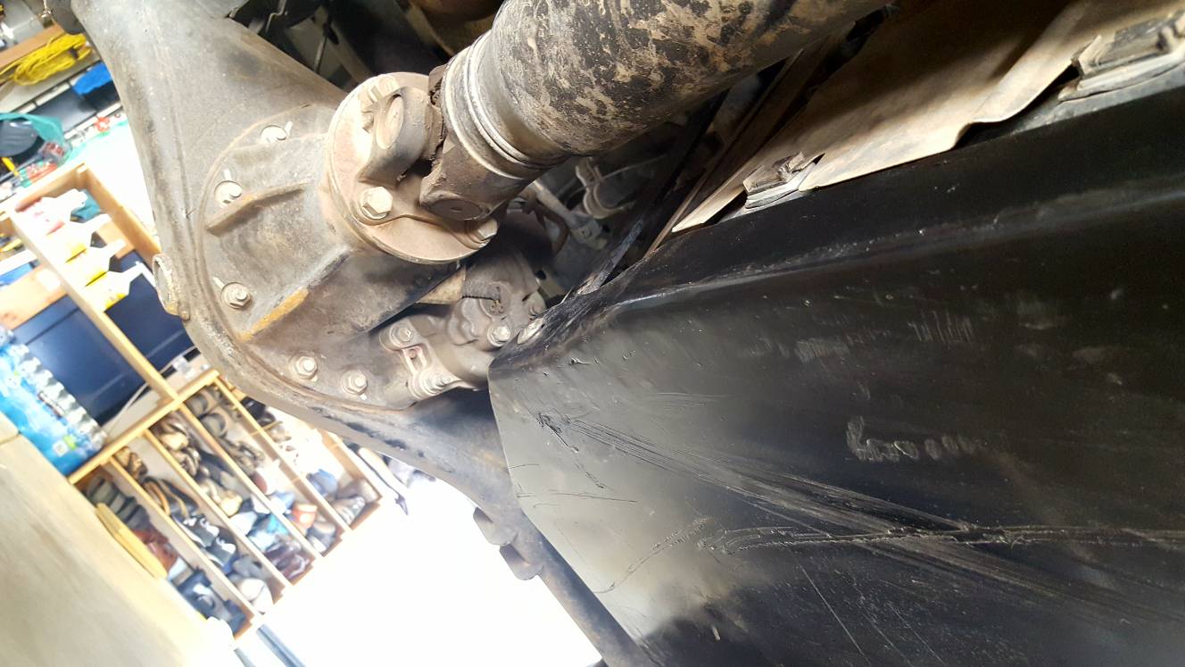

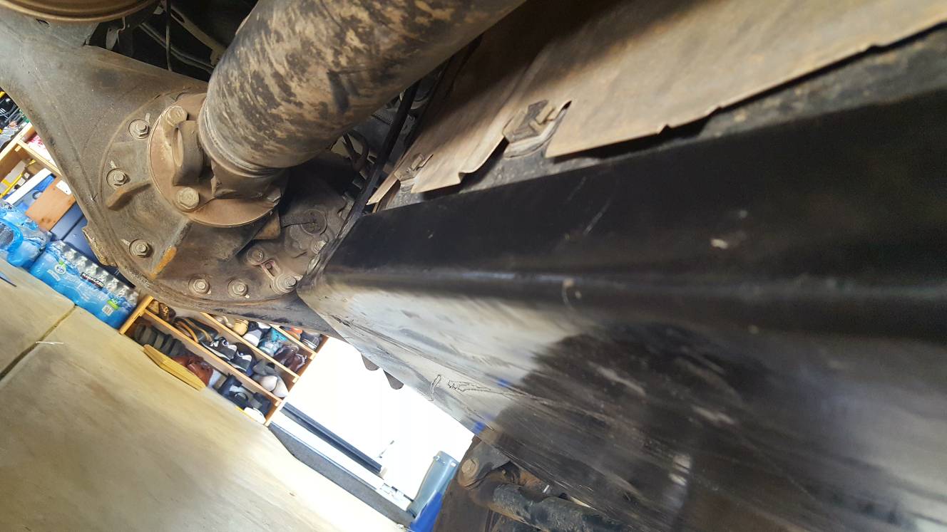

Finished up the mods to the gas tank skid, painted and reinstalled. Hopefully this will eliminate the driveshaft from hitting the skid. Next move would need to be an adjustable panhard inorder to shift the axle.
Since i had all of the skids dropped, i changed the oil in the transfer case with some Red Line 75W-85 GL-5 gear oil.

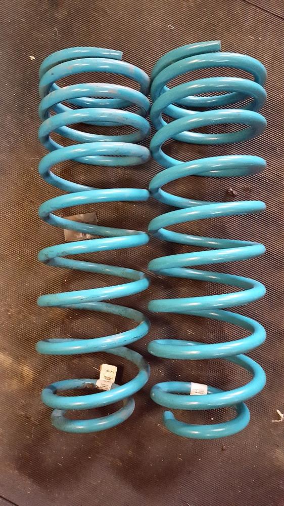

Several months back, I had swapped out my Metal Tech LT - HD springs for a set of Dobinson's C59-677V's. The initial ride and weight carrying was a vast improvement. My only complaint was that the ride height was unchanged. I was hoping for an additional inch (insert comment here). After loading the truck up and a few trails, I was back slamming the bump stops. I got a hold of [MENTION=148378]Dobinsons Mike[/MENTION] once again and ordered a set of the C59-701V springs. Mike quickly turned around the order and I had them in a week.
This past weekend I swapped in the new springs using a new method. The last time was a royal pain in the a$$. Because of the LT springs, I had to remove the rear shocks and also remove the upper rear link because it hits the top of the gas tank and would not allow the axle to drop far enough to remove the springs.
This time around, I had ordered a set of spring compressors and installed while the truck was sitting on the ground. Then proceeded to jack up and set the frame on jack stands allowing the axle to drop-out. I then jacked up the opposite side which allows the other side to drop a little more and BAM, out came the spring. Remove the compressors and reinstall on the new spring and crank down, shove up into place, raise the axle, and remove and repeat on the other side. Fully swapped in about an hour.
Here is a comparison of the two springs, the C59-677V is on the left and the C59-701V is on the right.

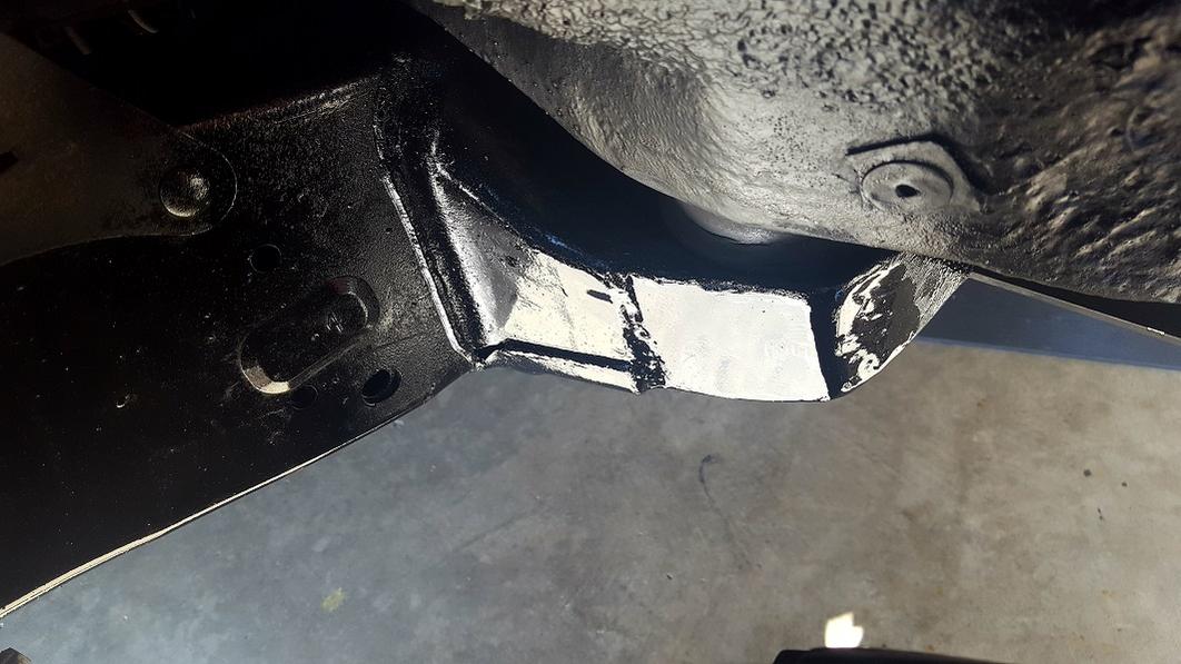

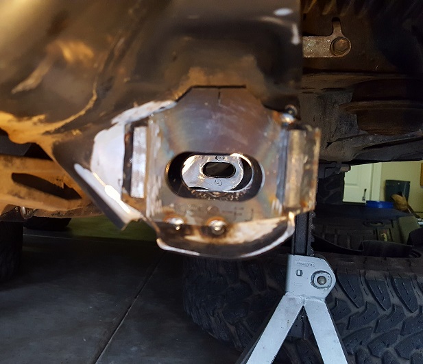

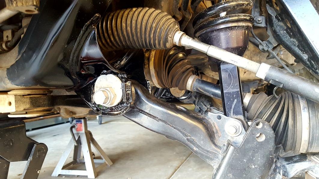

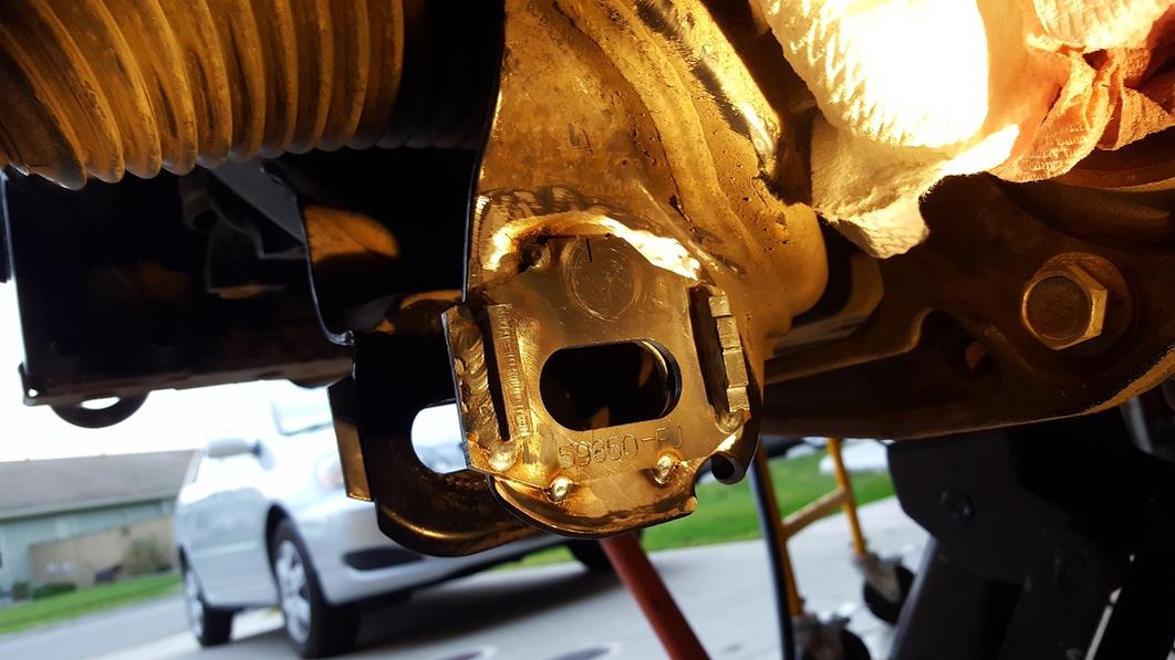

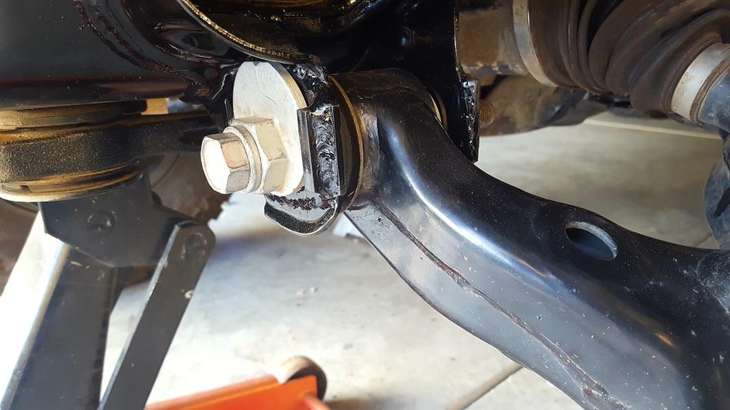

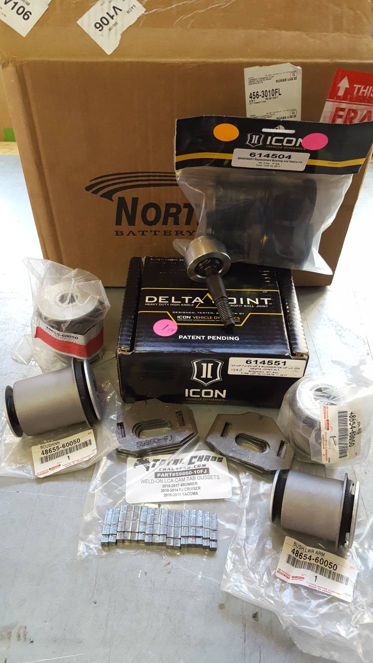

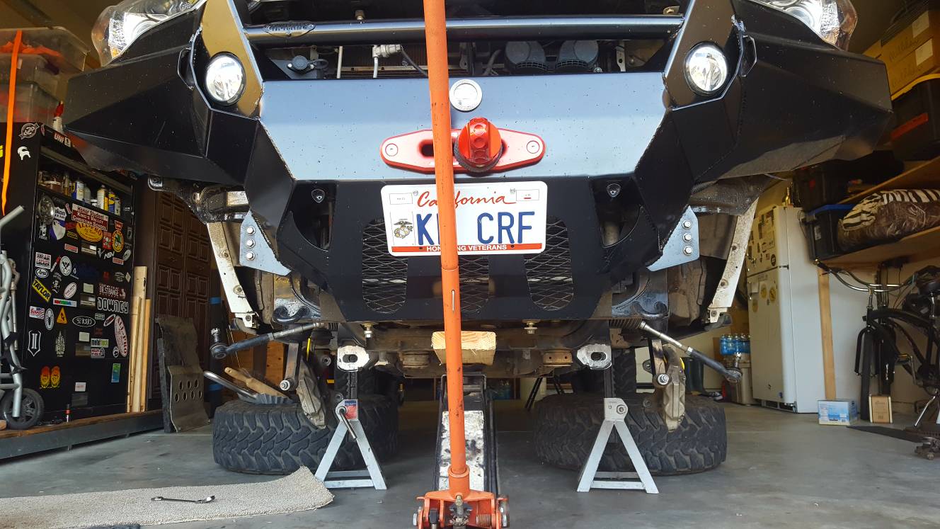

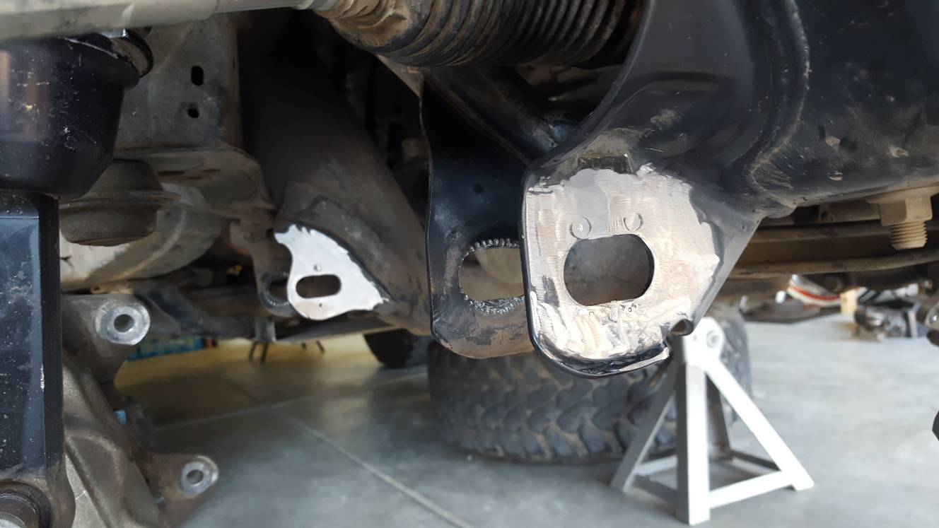

Ripped into the front between yesterday and today. Front pretty much disassembled and cam tabs removed and Total Chaos cam tabs all welded up and ready to install. Need to get the bushing swapped out on the lower control arm this week.
Sent from my SM-G920V using Tapatalk

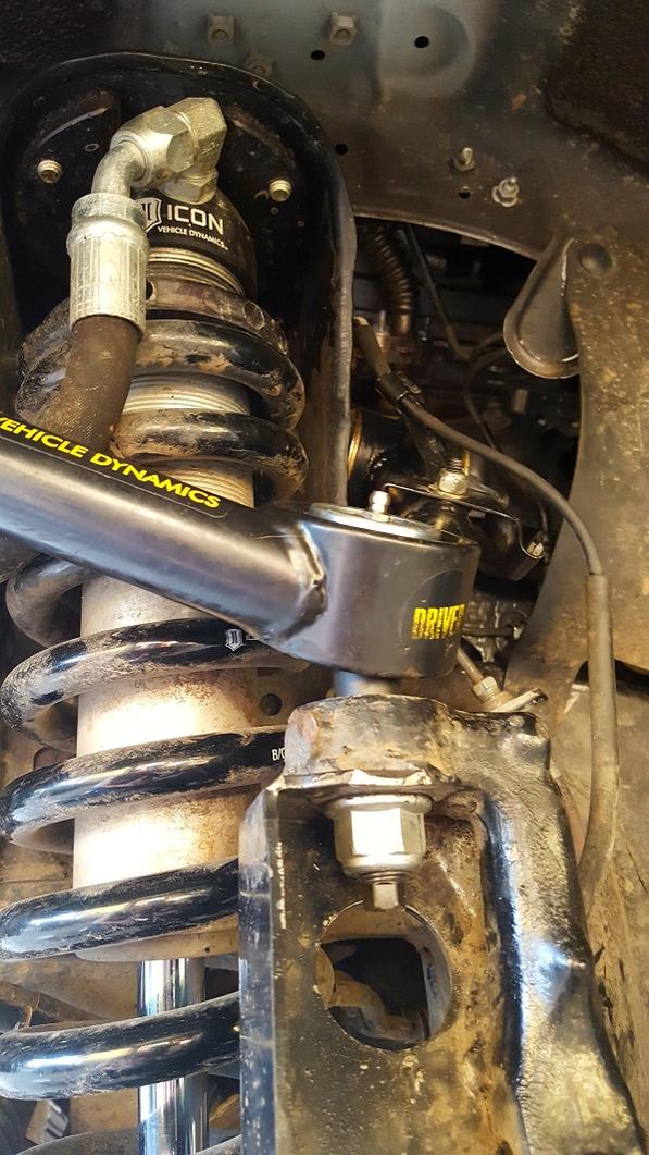

It was a long and productive week / weekend. Had the bushing swapped out in the LCA's and also had the new Delta Joint installed in the UCA's during the week and also got the Total Chaos cam tabs welded up and ready to install.
This weekend, cleaned up and made sure the cam tabs fit in the gussets and would spin freely, then got them in place and tacked all of them in place. After that, I installed the LCA with the bolts and cams and checked to see if everything spun and worked correctly. Had to make some minor adjustments with a de-burring bit and then checked again until I was satisfied. At this point, removed the LCA and went to town welding. After welding, cleaned everything up with the grinder and rechecked the operation and then painted everything up and then started the re-assembly of the front end. After I had everything put back together, I decided that since I was already there and had the welder out, I would go after the body mounts since I was still rubbing a little after the first BMC.
I learned my lesson on the first go round. This time, I loosened all of the body bolts and removed the bolt at the point of BMC. I had to use a bottle jack to lift the body to get the upper bushing out. Once I had done this, it made getting the sawzall in there a lot easier. Cut out a bit and then started mocking up material to fit and the welded it all back up. So much easier when the bushing is not smoking and melting from the heat. Again, spray with paint and put it all back together and repeat on the other side.

Proof of lots of cutting and grinding by this mess. You can see the section of the BMC in the pile.

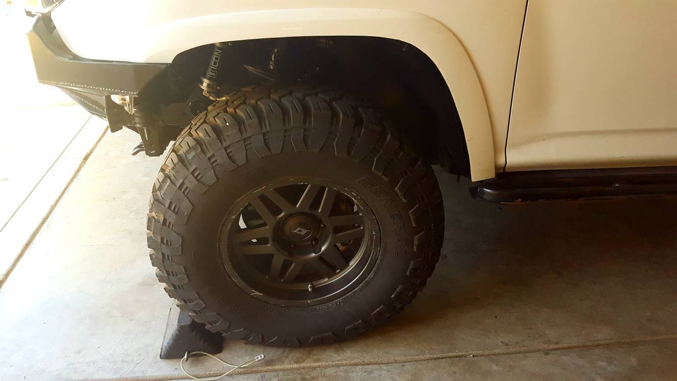

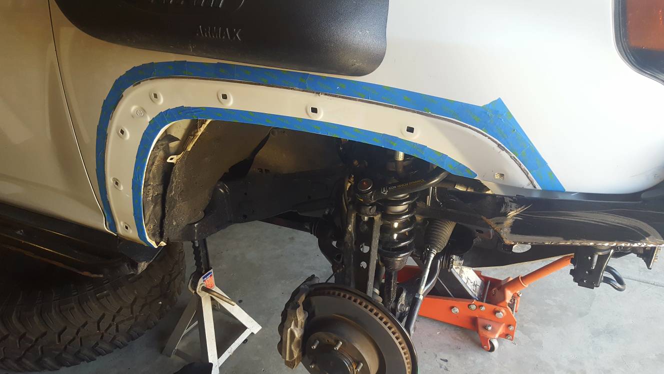

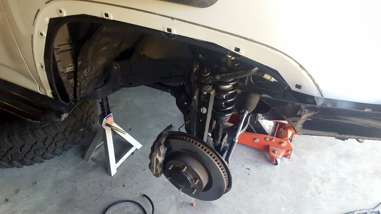

Upgraded to General Grabber X3's in 315/70R17 this week. Need ti do some more trimming on the fenders ala [MENTION=49966]mikey's2010SR5[/MENTION] for some added clearance. Looking forward to getting these dirty.

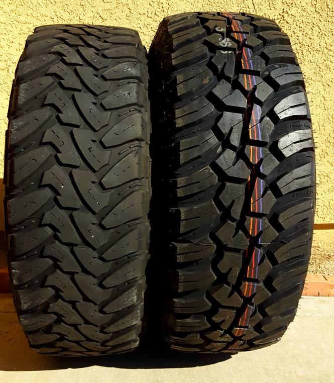

Side by side of a worn Toyo MT 285/75R17 and the Grabber X3

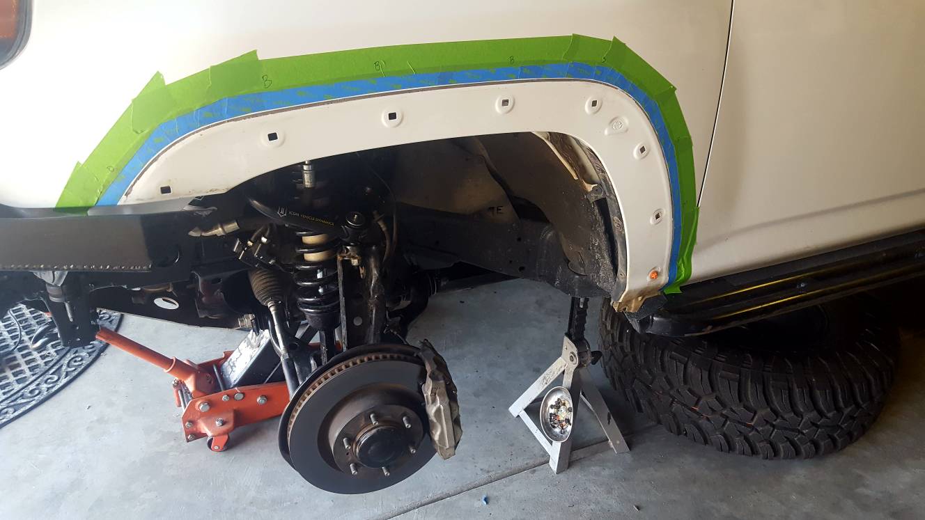

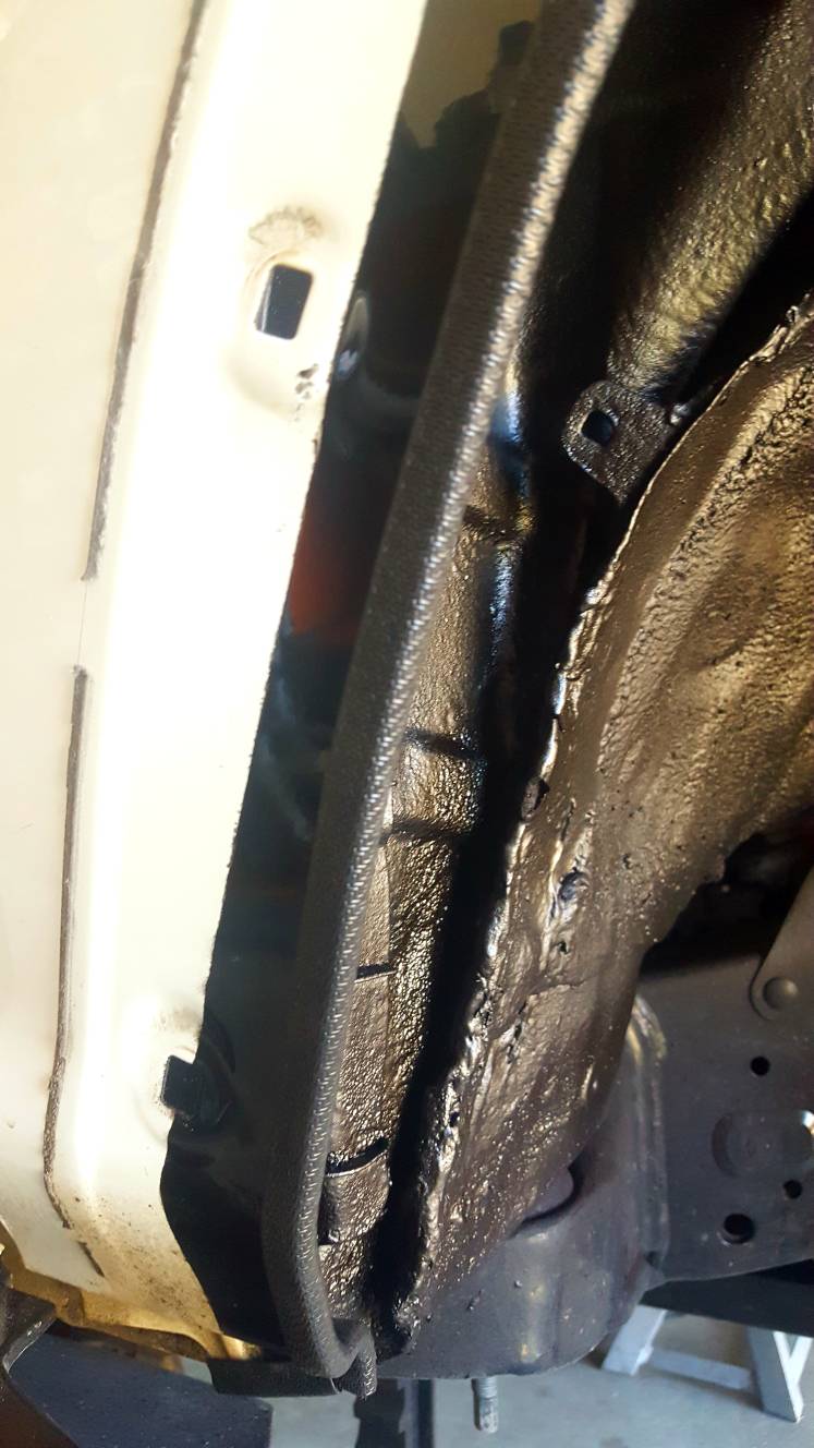

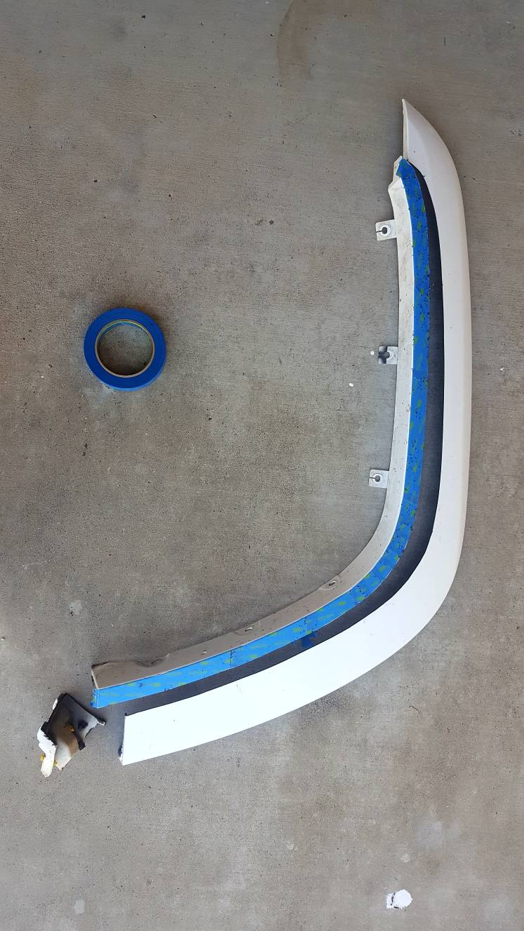

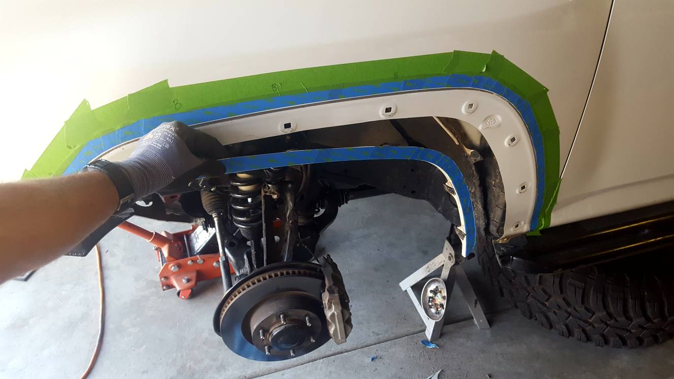

Since I upgraded to 315's, i knew this day was coming since i was already rubbing the rear of the fender. Took this mod from [MENTION=49966]mikey's2010SR5[/MENTION].
Removed the lined to get acces to the blue and orange clips, then started prying off the fender flare while cutring the tape with a knife. I would reach back with pliers and release the clips when i got to them. Took 1" off the fender and flare. I used a jig saw with new blades which cut real easy. Painted the cut line and spayed the entire inside of the fender with 3M liner.

Looking good! I bet you still rub though, only say that because I do a little still. 35s are no joke!
Time will tell. I haven't dropped the cash for LT, so it may not be a factor. This was a pretty quick project, surprisingly. Done and cleaned up in under 3 hours.
