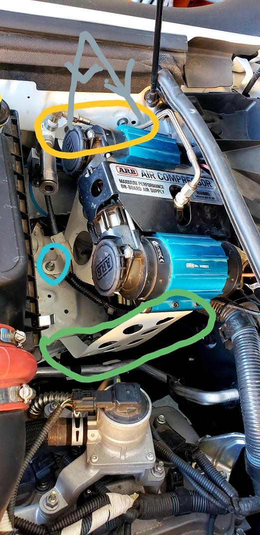

Last week, I finally solved the mysterious dash rattle. It had been driving my nuts for a long time now. I was finally able to pinpoint it the other day because I shut the passenger door and hear that sound. So I went through the process of opening and closing the door several times until I decided it was coming from under the hood. SO I popped the hood and continued until I isolates the compressor. At this point I shook the compressor / mount and heard that rattle click. So I promptly removed the compressor and mount and discovered the noise was from the tears in the sheet metal of the inner fender popping. It appears that the weight of the compressor, off-roading / California roads and the design / mounting points have let the compressor vibrate and oscillate enough to start to tear the mounting points of the inner fender.
At this point I knew I had to create an additional mounting point to eliminate this issue. Since there were no real additional factory nuts or studs in the right area, I fabricated a bracket and attached it in two points to the inner wheel wheel and welded it to the existing mount. Nothing like DIY fab work without the proper tools, especially for creating bends and offsets.
In the end, it really stiffened up the bracket and should eliminate and further damage.
In the picture, the original mounting points are circled in yellow and blue. The grey arrows are where the inner fender was tearing. Circled in green in the the piece I fabbed up for additional support.

Ha! I had the same exact problem with rattling and subsequent tearing. Ended up welding a reinforcement plate to the inner fender too.
Damn things just don't have the same thickness as the old trucks. I think my beer can is a thicker gauge than the body panels.
It reminds me of the first series of FJ Cruisers, the inner fender wells would tear with nothing attached, stock or lifted, low miles, high miles.... There was no rhyme or reason to it, other than the metal just wasn't thick enough I guess.
Everyone at first was blaming big heavy front bumpers on them, causing reverbs through the whole front end, but then when stock trucks were also doing it, Toyota updated the whole platform with the 150 series and hopefully/apparently fixed the issue.
This still happens to me, but I think bigger batteries are the culprit.
I have a similar set up. I may have to up my game before I have the same problem.
Yeah, just looked at you bracket. I would just to eliminate the issue down the road. Looking at your work, I'm pretty certain it will look a lot cleaner than mine. :thumb:
Do you have any support from underneath yours? I used a couple of short sections of pvc pipe as supports to help distribute the load.
