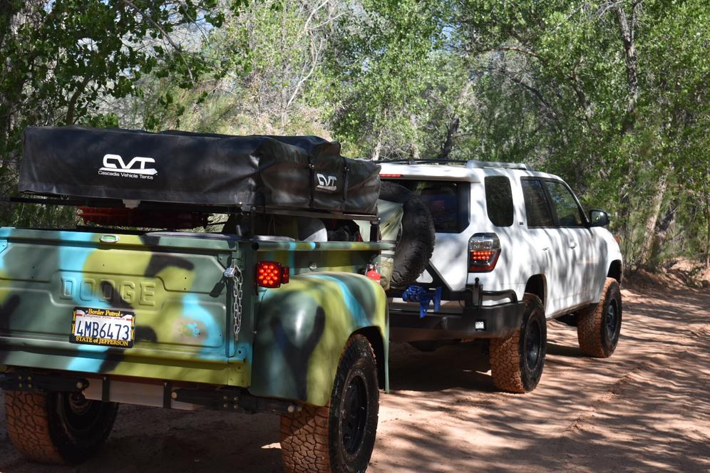

I’m all ears on that too. I tow a trailer sometimes and fully loaded, with that hooked up, the icons just aren’t cutting it. I know that there is no one shot, one kill, for everything I want to do. But, i think I can get close. I’d like to keep from running airbags and just have the best setup that I can.
