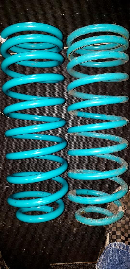

A few weeks ago, [MENTION=148378]Dobinsons Mike[/MENTION] reached out to me about Dobinsons having a new, even heavier HD rear LT spring for the 4Runner. The specs are as follows;
  • C59-749V - Variable Rate
  • Raised Height (75mm Lift)
  • 400Kg Constant Load

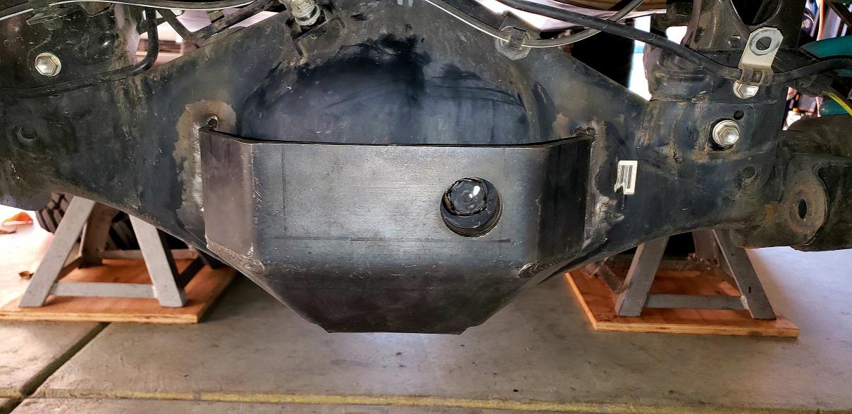

I will be replacing the C59-701V I am currently running. The issue I have been having is with all the weight, rear bumper, armor, rear storage drawers, spare tire, tools, plus anything else I load up, I hit the bump stops while just going down the road. Yesterday I swapped in the springs as well as added read diff armor.

After the install, I am sitting at about an additional 1". Right now with the 315's, I am at 42" from ground to fender. With the very short drive, could tell there was more stiffness, in a good way.

I like the rear diff armor.
