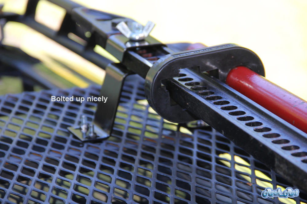

I normally don't carry the hi-lift jack around with me except for longer trips and off road. Before I got the whitson rack I used to clamp the jack in my ski rack. It was a great fit and I never even knew it was on the roof.
I looked at a couple of options for my existing setup and decided I wanted to use as much surface area of the rack as possible to ensure there was little stress placed on it. The tube mounts for mounting on the side looked OK but the rack only has an ~ 1" diameter frame. I just didn't feel the rack should handle that kind of stress with a jack hanging off the side. I think if the tubing diameter was larger I may have gone with a tube mount.
So until I get a rear bumper I decided to mount it inside the rack. Not my favorite location because it does take up valuable real estate for additional storage containers up there. Anyway here goes...

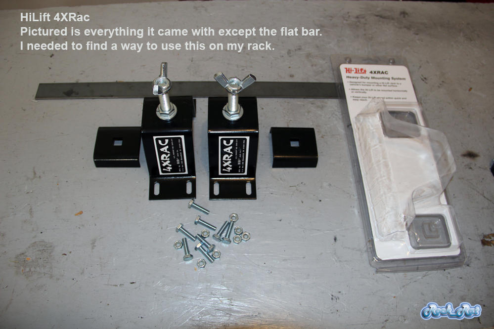

What I bought
  • Hi-Lift Jack 4X400 4XRAC Jack Mounting System
  • Cost - $33 locally ($38 off of amazon)
Cons
  • No way to secure it to the rack.
  • The hardware didn't come with any washers or backplates or anything you can use to secure it to a perforated rack.
  • It was clearly designed to be mounted to a solid surface such as a bumper. Hardware is lacking!
Pros
  • It was inexpensive enough
  • easy for me to modify in an afternoon
  • Mounting brackets are solid
  • Will suffice until I get a new bumper
  • Carriage bolts and wing nuts are good

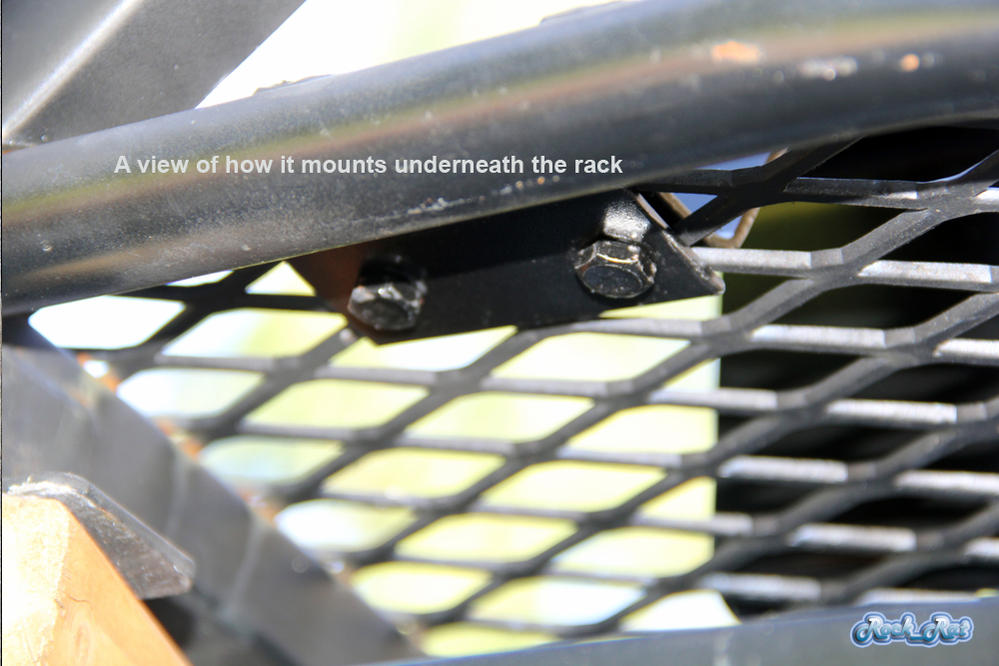

Modifications Made

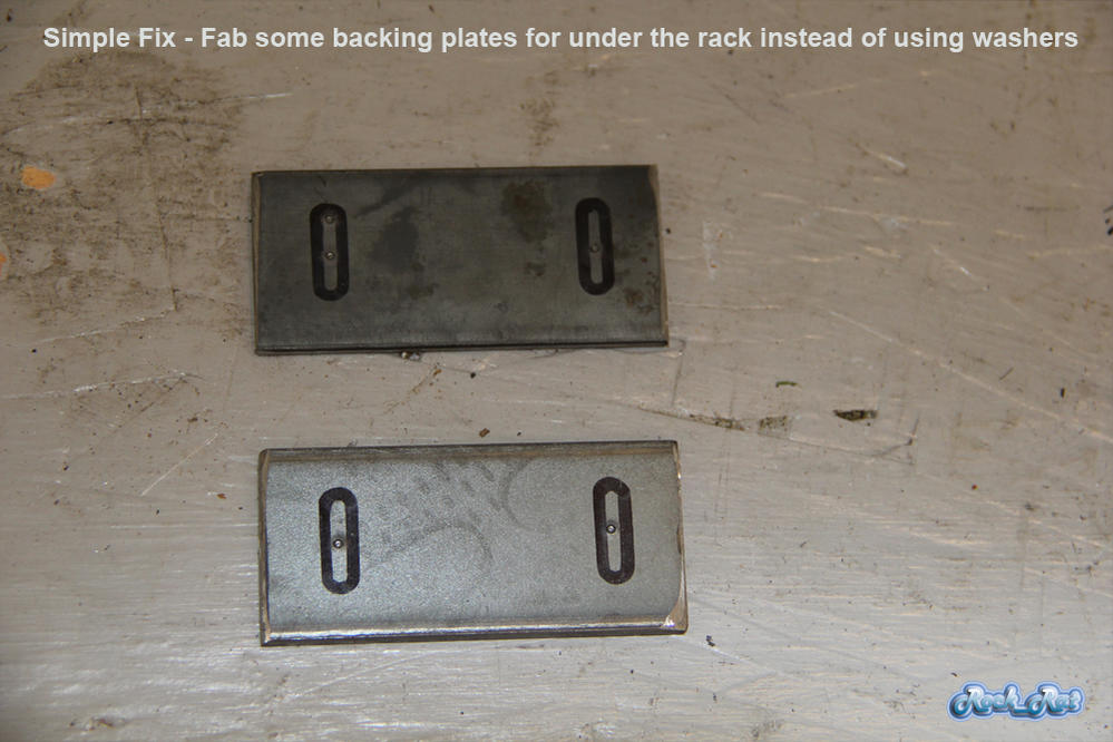

  1. I could have used washers for each of the bolts but I wanted:
  2. a more even distribution of the weight at the mounting surface
  3. to use a larger area of the rack to prevent it from getting "pulled through" over time.
  4. I just didn't think a washer underneath could provide me with the strength I wanted to support the jack
  5. I used a 1 1/4" flat bar and cut four pieces to size. Next I drilled the necessary holes and shot it with Rustoleum semi-gloss. Done.

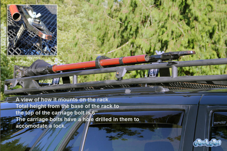

I mounted it on the passenger side
  • For more weight on that side to compensate for drivers side lean
  • More (cough cough) aerodynamic with the top facing forward
Only drawback is the base plate definitely rattles causing it to reverberate throughout the rack. My fix is to remove the base plate and put it in the recovery gear bag

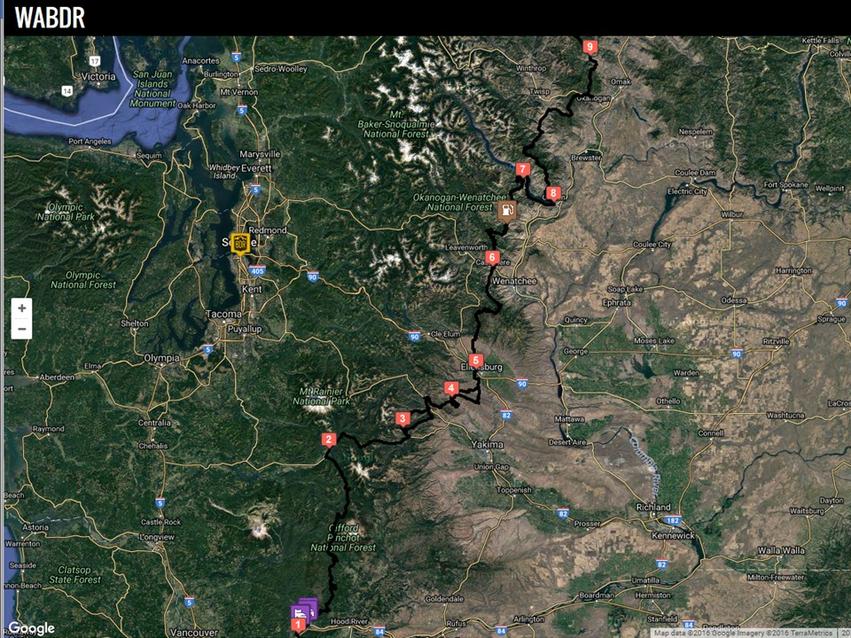

Preparations for the WABDR Next Week
Finishing up preparations for the WABDR trip. We'll be leaving from Stevenson on Wednesday the 10th. I'll post an itinerary on here if anyone wants to meet up along the way. We're looking at 6 days.

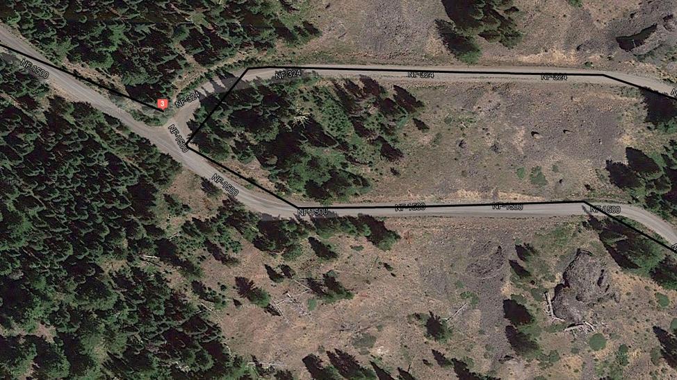

Bethel Ridge Bypass or Not?
For those that have done this route, did you bypass Bethel Ridge? That one section looks pretty sketch. ( [MENTION=63487]A.Wilson013[/MENTION] [MENTION=82154]GSPRunner[/MENTION])

I cannot tell where that is on Bethell Ridge, but there is nothing "sketchy" up there. Granted, I've not been up there since Memorial Day last year.
The only possibly difficult part up there is where you go back into the trees after going past Bethell Ridge. It's an actual 4x4 trail (short one) but can be rutted out, muddy, etc. We've done it a few times and have never had a single issue.
As you climb up to Umtanum Ridge there are some pretty nasty ruts that you'll need to straddle to get past. If for some reason you dropped a tire into one you'd be screwed and likely need to do some serious digging or easy winching if you have more than one vehicle with you.
I cannot remember a single truly "sketchy" part of the trip. It's all pretty mellow and could likely be done in a well driven Subaru Forester. Unless, of course, that actual trail part after Bethell Ridge is too muddy or rutted out.
