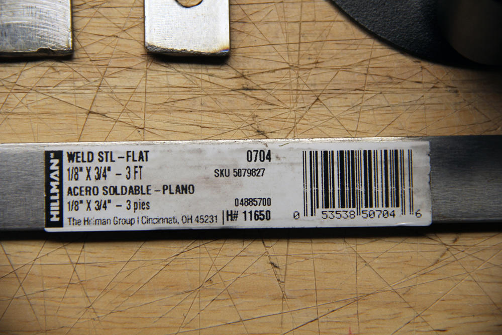

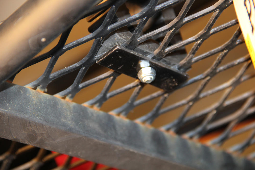

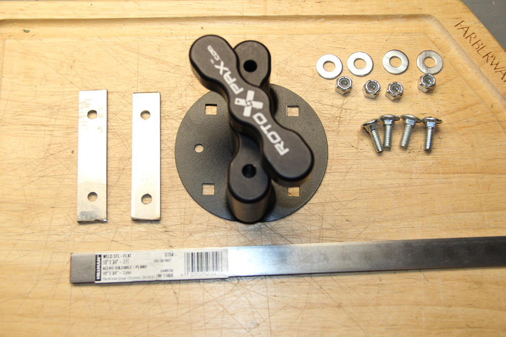

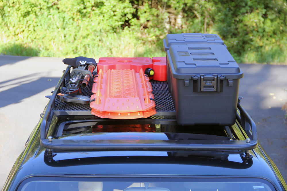

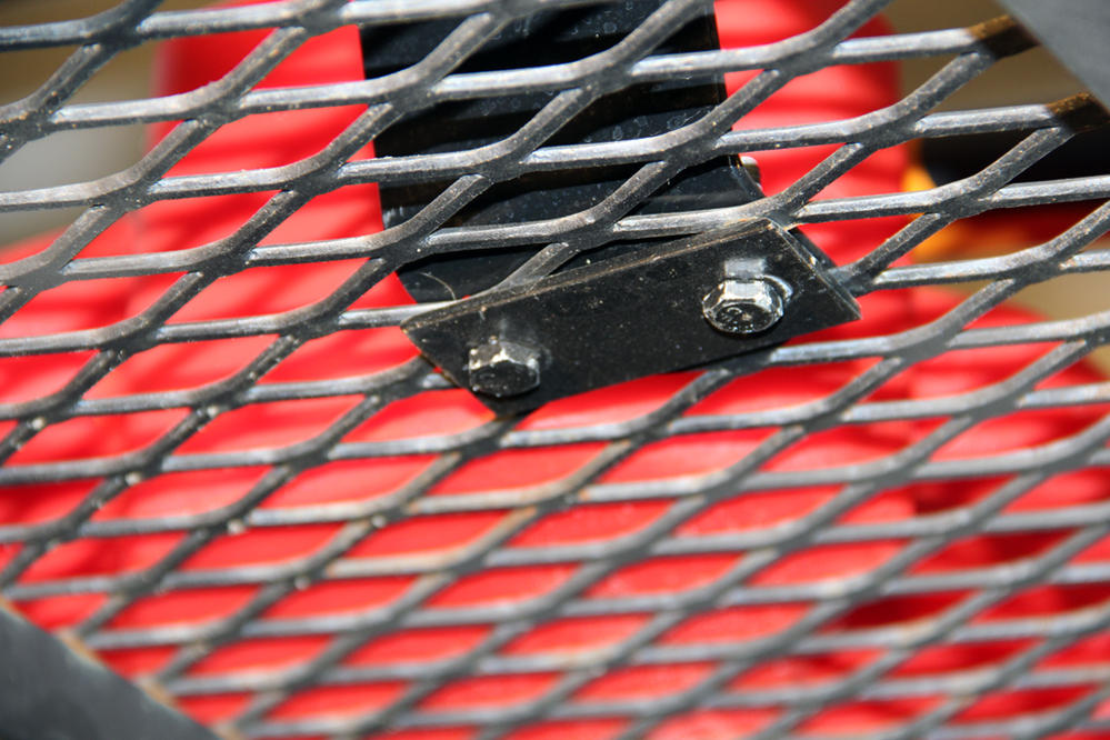

So, as I'm preparing for the WABDR trip I'm finding out that flat bar is my BFF with the Whitson rack. Yup. vise, angle grinder, bench grinder, drill and Rustoleum semi-gloss paint have become good friends the past few days. The quick fists only come with washers as do the Rotopax mounts.

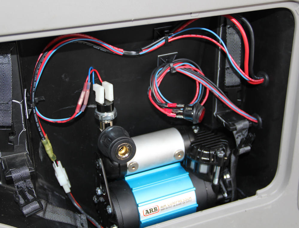

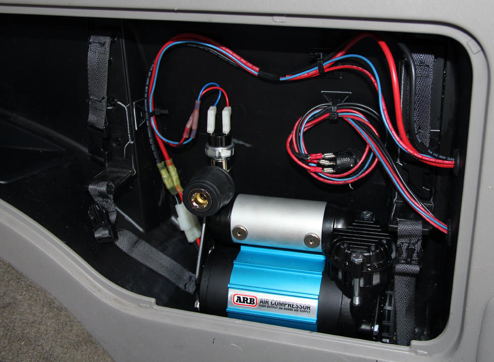

I still have my ARB compressor to install (in the back small cargo area. I want to keep it away from the heat in the engine bay.) over the weekend. I also need to figure out the puzzle pieces on the roof. I'm not happy with my hi-lift taking up that good real estate on the roof rack. Damn squatter. Guess I can't complain too much. The Fiskars axe fits nicely under it though on the quick fists. I might mount the "treds" (they're the MAXSA Innovations 20333 Escaper Buddy Orange Traction Mat - $130pair) on the side. I'm not sure yet. Anyway here's a peak at how she stands right now. Looks like a swing out rear bumper is in order. ( [MENTION=116387]Unner[/MENTION] ) Never really thought I would get one. I can see now how it can become a necessity very quickly.

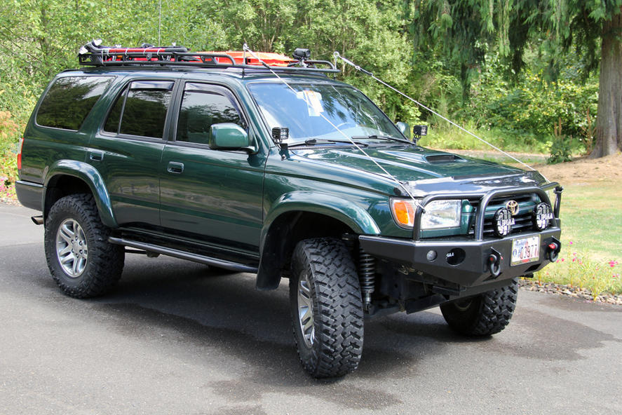

Man i want those wheels so bad, mostly for the extra width for my 315s and also because i hear the color is spot on for dorado gold.
Looks like she's ready to hit some Washington backcountry trails!

Good idea on the whitson rack, I always just used fender washers, but aluminum stock would work well. I have never had good luck painting aluminum, I also just found out recently that there is a special primer you are supposed to use for aluminum other than self etching...

Aluminum is funny stuff. That's why I went with the steel.

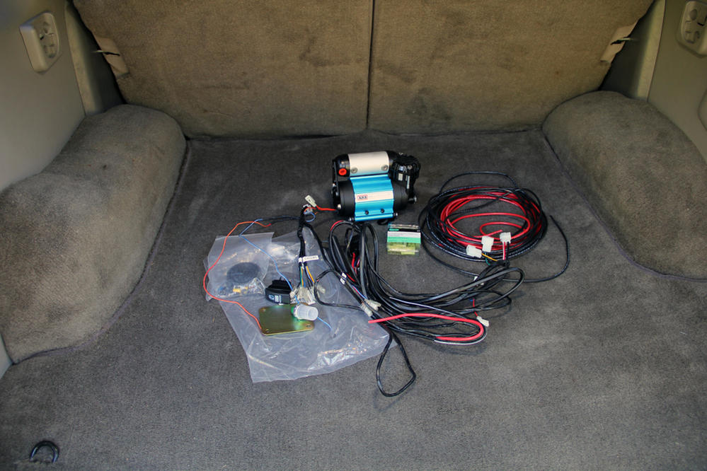

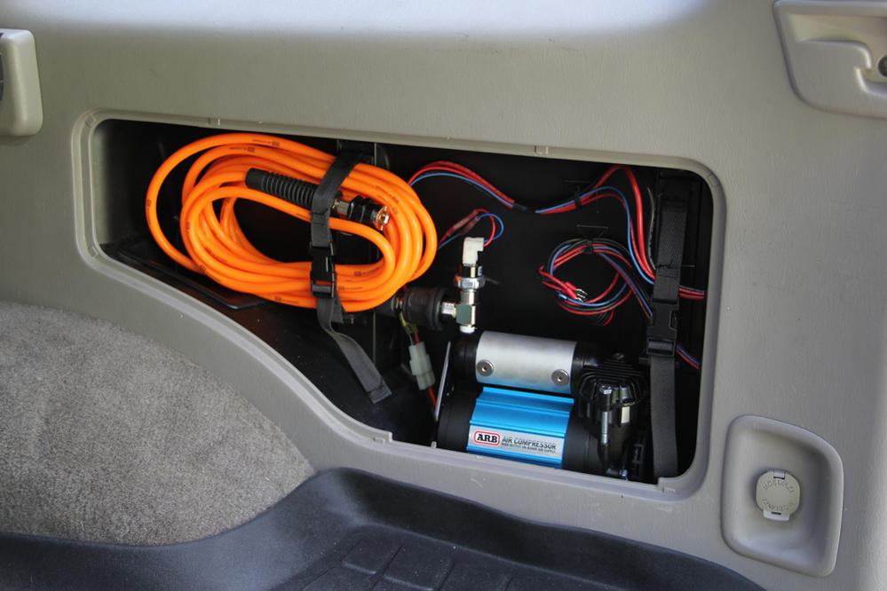

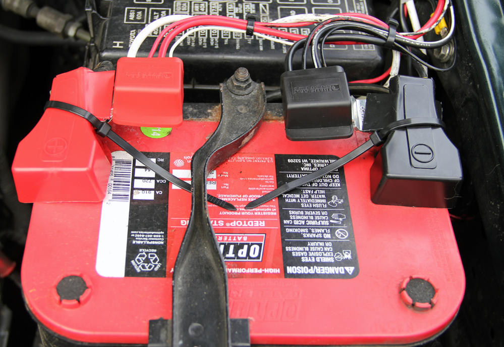

Here's what my weekend consisted of: Installed the ARB Compressor and tidied up my wiring. I can now air down and air back up along the way. I "wanted" the twin cylinder but just couldn't justify the cost - even with the group buy. I think I read somewhere that the inflation times with this one is around 6-7 minutes per tire. I'll soon find out.

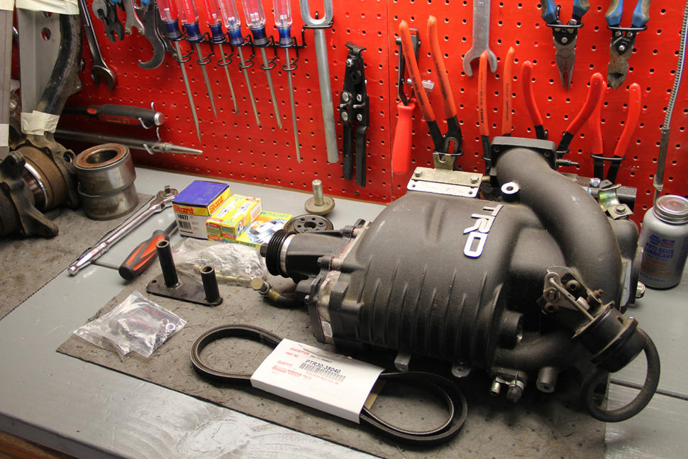

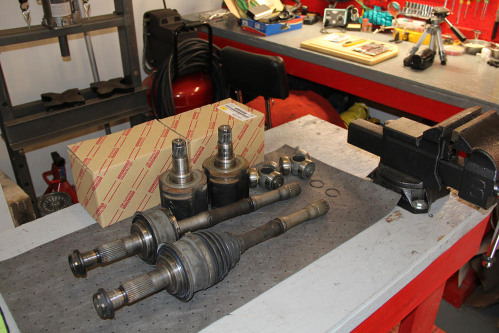

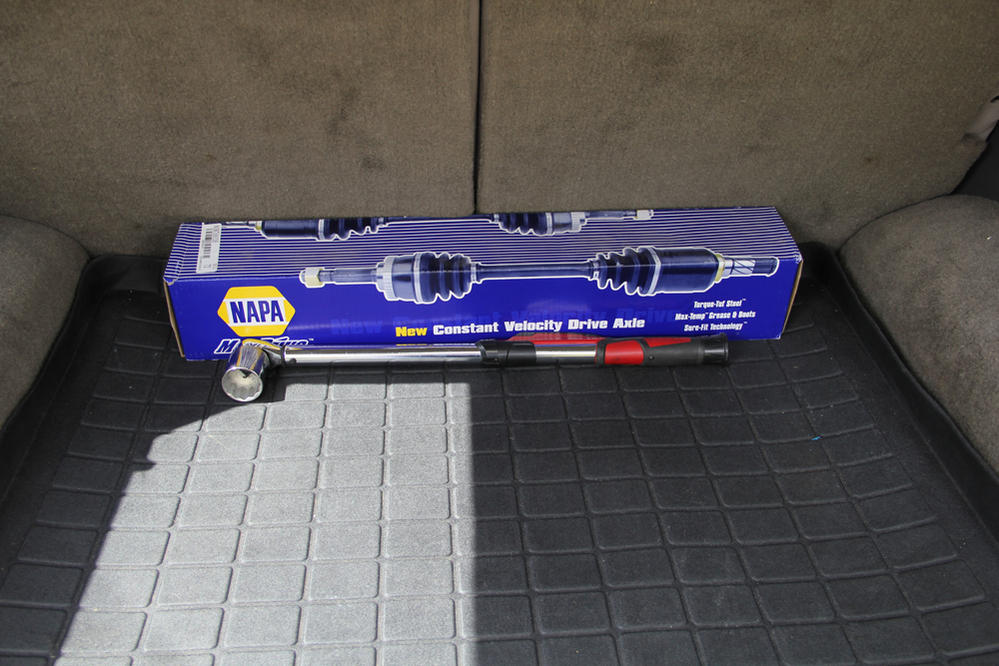

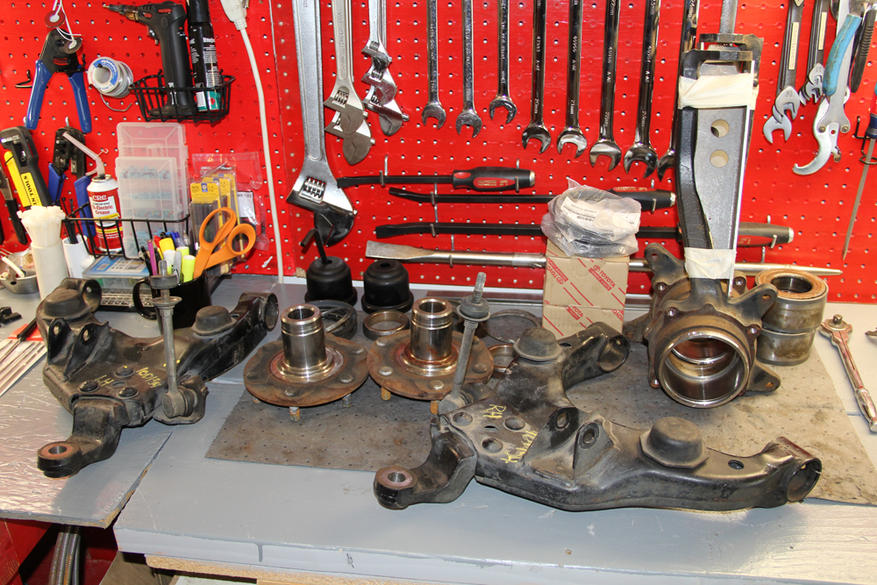

So I felt guilty as all get outs yesterday pulling into NAPA and buying a spare axle for the trip but I looked around in my garage and realized I had so many unfinished projects including my original axles that I really had no choice.

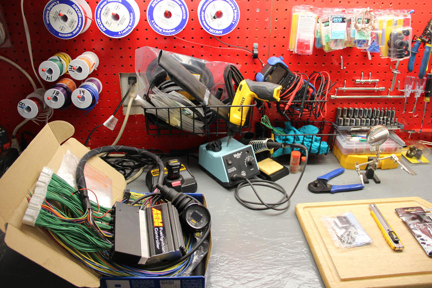

I swear, one day I will finish rebuilding the axles, the LCA's, the spindles, and I might even install the SC and the AEM kit. Only as long as no other projects come up that take priority.
Am I the only one with unfinished projects laying around their garage? And to think, this is just 4Runner stuff only!! Life just get's in the way. But man oh man I wouldn't trade a thing! I'm just about set for the trip. Next post...

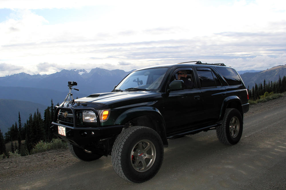

Limb Risers and Camera Mount
...Ok this is why I can never get all of my projects finished. Two other priorities came up.

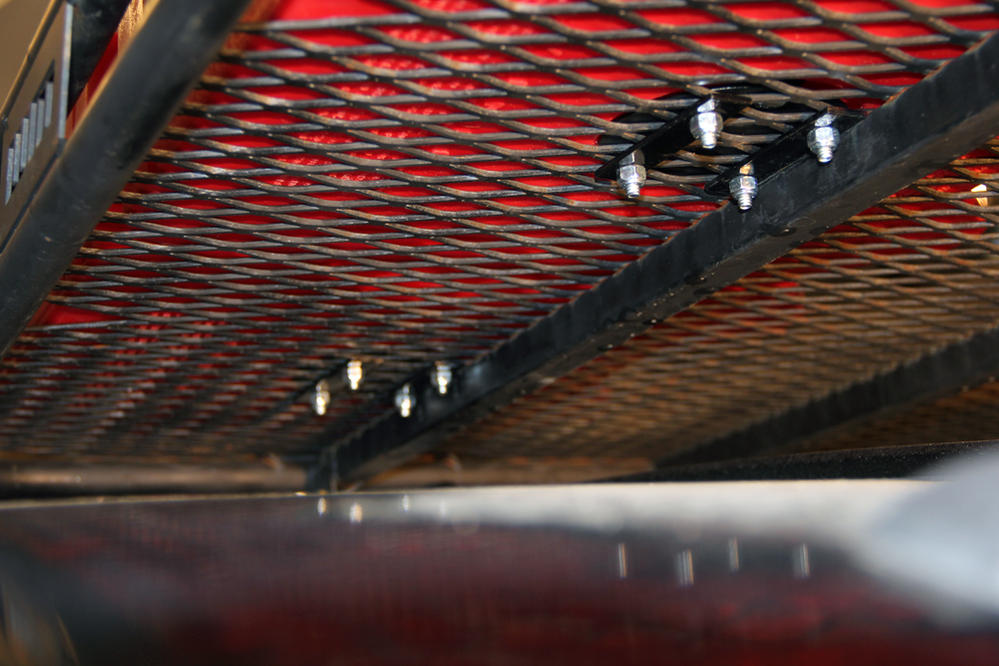

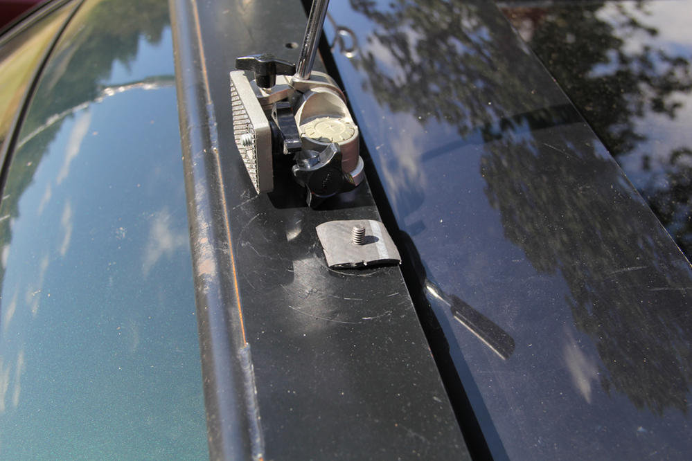

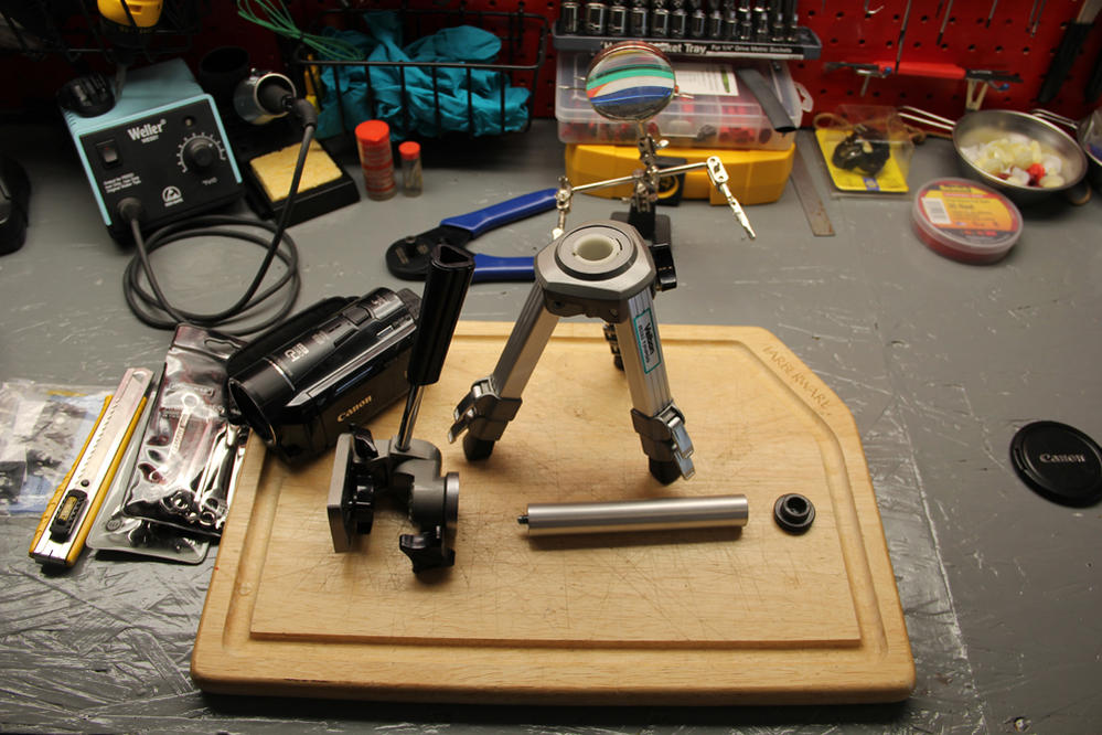

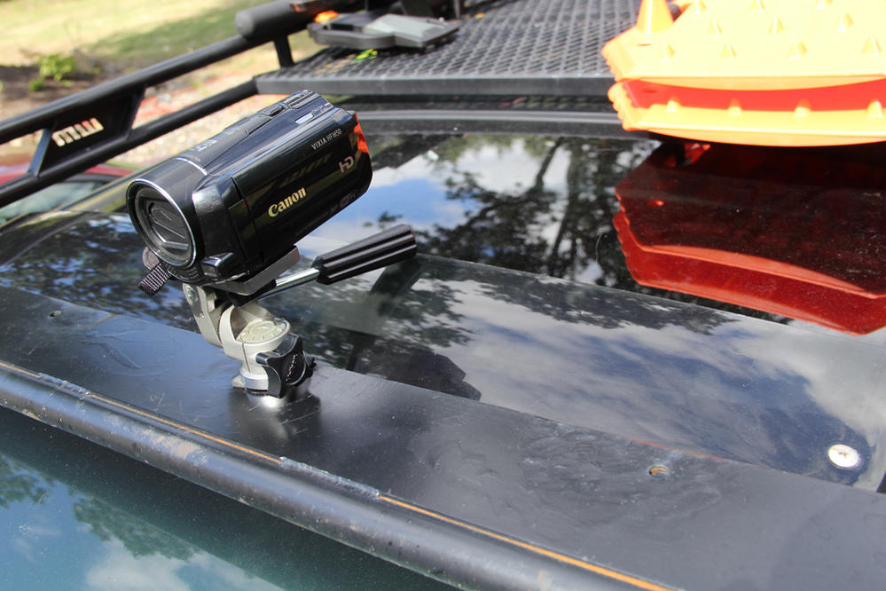

First off I LOVE my Whitson rack. Little golden nuggets hidden in there! When I duid the Olympic Peninsula last year over labor day, I mounted my tripod on my hood and bumper using gorilla tape.
This year I picked up the rack and there are these pre-drilled holes from the previous owner. Obviously he drilled one just for me because that is exactly where I'm mounting my video camera this trip!! Used a Grade 8 bolt a couple washers and a piece of rubber hose to absorb some of the shock.

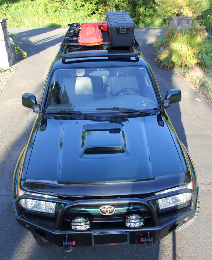

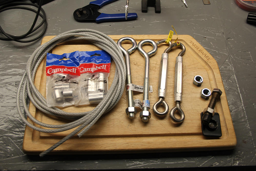

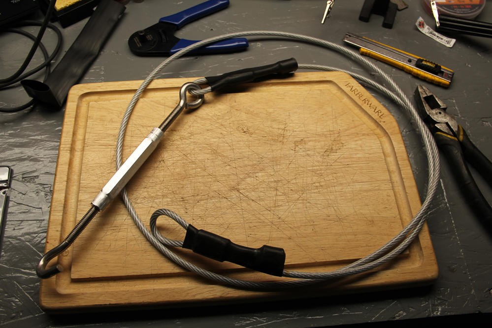

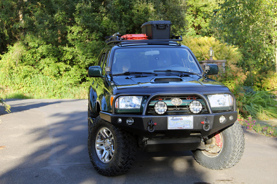

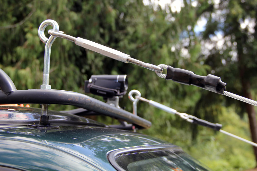

I also needed to take a page out of [MENTION=55891]Bandit Runner[/MENTION] build and fab up some limb risers. Ran to true Value and picked up two 1/2" x 8 eye bolts, 88" of 3/16 rubber-coated aircraft cable x 2 with swedges and two turn buckles.
Replaced my two front support feet for the rack with the eye bolts and came up with some pretty dang good limb risers. When I return, I need to look for stainless steel instead of galvanized and go shorter than 8".

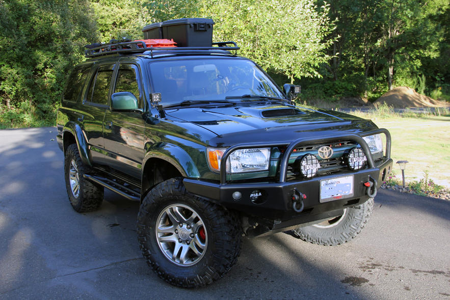

Rig is set to go! Lubed all the shafts yesterday (Woody get your mind out of the gutter) and did a once over.

Awesome thread. Absolutely awesome. Great work sir. I have a question. What is the purpose of the cables going from roof rack down ?
How's that arb air compressor?
And have you done the big 3 upgrade ?
Are you still on stock alternator?

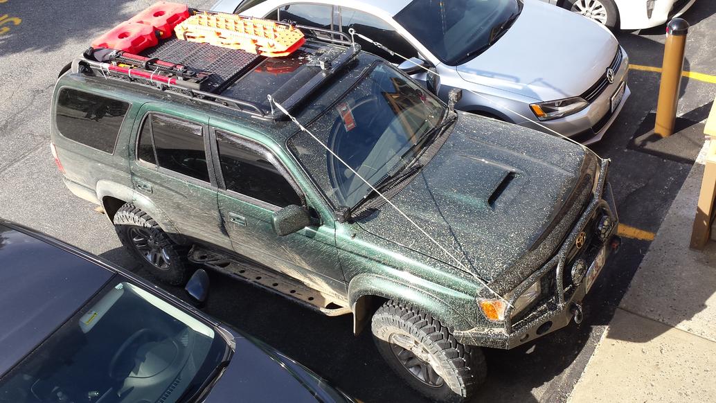

The cables are "limb risers" and they're meant to do just that: raise limbs up off of your hood, windshield, rack, etc. The way he has them mounted will also keep branches from getting under his roof rack.
I like the direction you're going with your build. The bronze wheels on that color are a match made in heaven.

Bandit, I can't open the hood with the limb risers but for this trip it's perfect. Definitely needed them. I'll re-engineer them when I get back home. Leavenworth hotel pic from 2nd floor.
