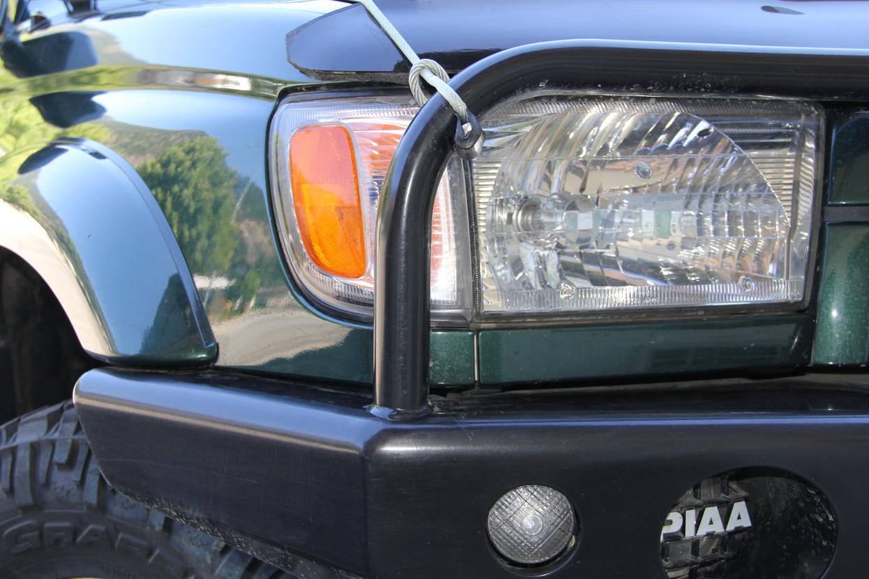

Awesome thread. Absolutely awesome. Great work sir. I have a question. What is the purpose of the cables going from roof rack down ?

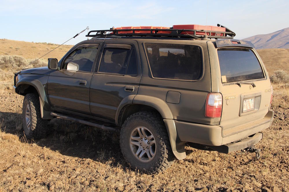

Ok so as The Durk said it's to look like the rig on the OB medallion. Seriously they are the to knock the branches and limbs away from.your rig and they work! I fabbed mine the afternoon before I left for $57.

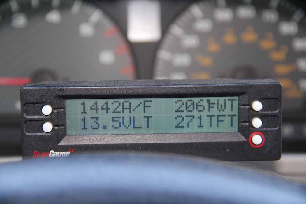

Quick update on the trip. Epic so far with amazing views and trails. The rig is a beast. The toughest part of three trip so far was Umtanum. Transmission temps went as high as 267 but averaged around 230. Tough climb in 4wd with entire family and cargo loaded down.

Bandit, I can't open the hood with the limb risers but for this trip it's perfect. Definitely needed them. I'll re-engineer them when I get back home. Leavenworth hotel pic from 2nd floor.

Here's a few pics before I crash for the night. Umtanum Ridge with transmission temps up to 271! This was a tough climb. A 4WD was needed all the way. I let it cool down twice on this leg. The view is magnificent. As you guys know, photos can't capture it. Had to get the quintessential photo of my son driving through the water!

Really? It really knocks branches away ?????

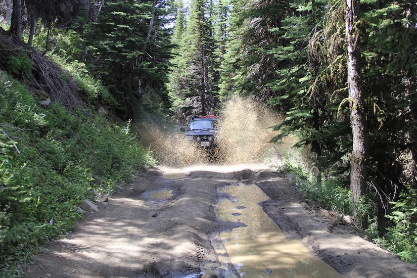

Looking at your tan runner in that first pic of the series makes me think twice about a snorkel, but then again, I really don't think much will help when the dirt is that fine and airborn. Hope you check your filter periodically

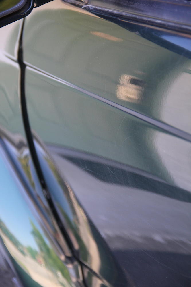

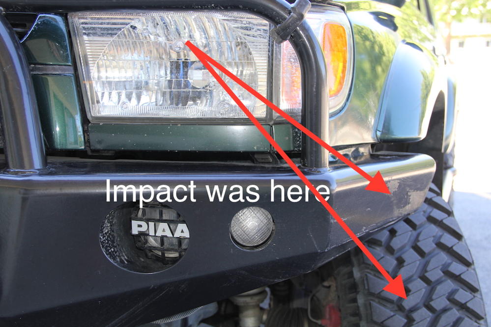

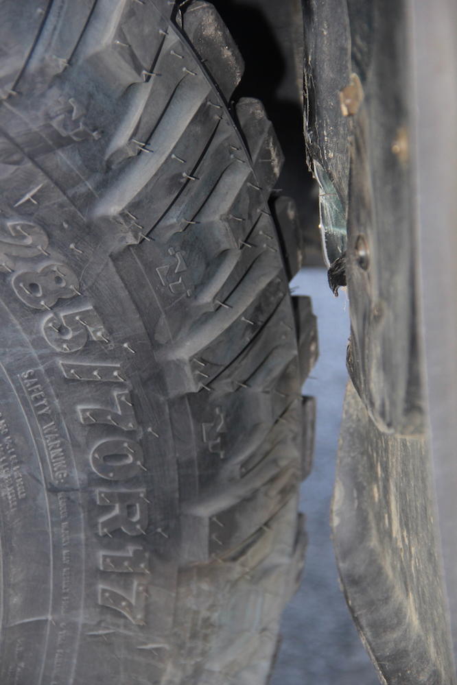

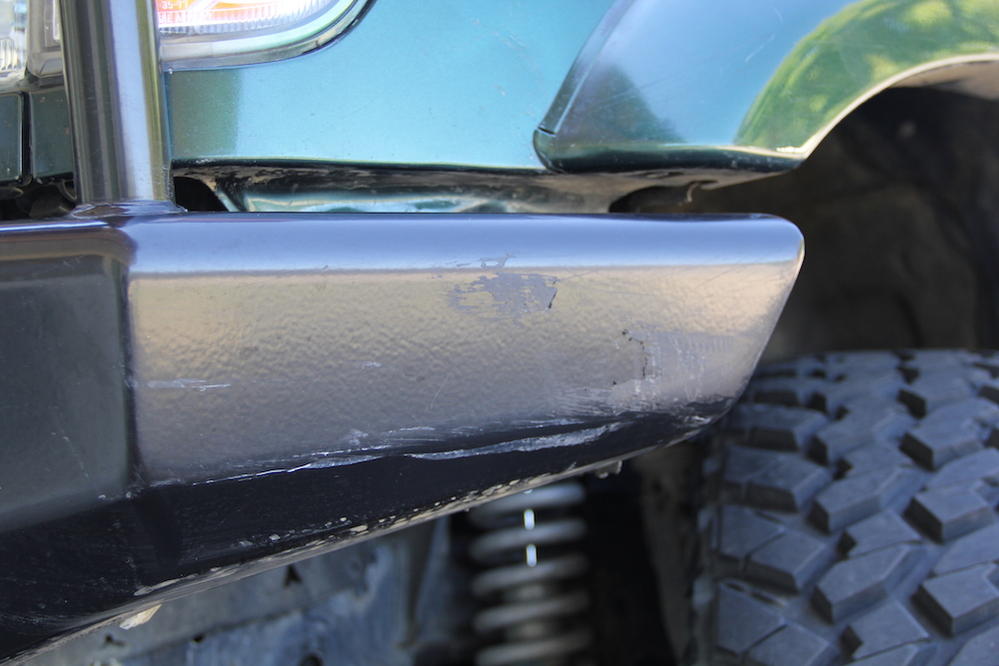

Update on the Impact from the Enduro

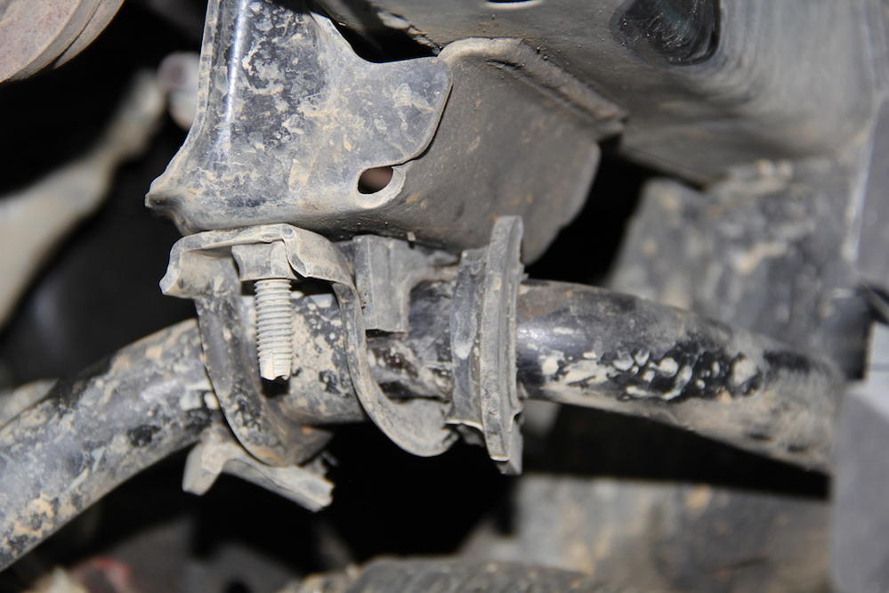

A more thorough inspection this morning of the impact area after giving the rig a bath revealed more damage than I had originally saw at the scene.
The impact area was a direct hit in the center of my driver's side tire and the corner of the bumper. I've noticed several things from the impact. The gap between my bumper and the fender/hood/lights etc. It was pushed up about an inch or more. There's a gap at the rear of the fender where it meets the drivers door. However, there's no deformity between the hood and fender. I'm not too concerned with the body. I can fix that.
The big concern is the rear of tire no longer clears the rear of the wheel well the away it used to. Something is bent. It could be the LCA mounts that are bent, or worse. It could also possibly be the axle. I'm a bit concerned about the integrity of the LBJ after taking such an impact. I'll probably be replacing that tomorrow. (thoughts?) I might need to go aftermarket for the next five days.
I still haven't lifted it and removed the wheel yet or even opened the hood. I'm hoping to put it on a lift but I'll lift it later on today if I can find some shade.
I welcome any thoughts on what you think it might be. Had to say I know without seeing everything. I'll post a cpl pics later on. I'm in Leavenworth so time with my wife is pretty important!!

This is my non-expert opinion, but I don't think you would be able to really bend the front axles in a way that would alter the location of the tire to the vehicle. I think with CV's it would just cause a serious vibration if you had bend the shaft. If it was a solid axle front I could see it though.
As for the rear tire clearance that could also be your alignment getting knocked out. You have aftermarket UCAs if I remember correctly so they push the wheel forward as you get more caster to clear the wheel well. It could be that the lower adjustment cams got knocked or even the adjustment on the UCA.
First thing I would do is throw it up on an alignment rack and see how everything there looks.
As far as the bumper alignment I feel like there is a good chance that it got bent and the fender maybe got tweaked too causing the gap by the door. It hit the very end of the bumper where it is furthest from it's mounting on the frame so it's also the weakest point.

I'm running the light racing UCA's. That's the first thing I'm going to do in the AM. Heading to Wenatchee packed up and ready to go. I'll get it up on a rack before/if I replace anything. I looked at the axle again, and like you said the geometry of the CV should allow for it to flex. If anything is bent, it has to be something that is rigid. Bottom line is, if they can pull the alignment in to a point where I can drive it safely, we're moving on. I'll deal with the rest when I get back. I'm just thankful we're ALL safe, my family included!! Nobody was hurt. That's really all that matters. There's so many trails up there. Problem is, not everyone knows the BDR trail. It's been pretty empty so far. I've only seen four Enduro's doing the trip. Didn't see one 4X aside from those going camping or just doing a trail or two.

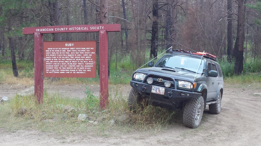

Finished section 4 to Lake Chelan and up and over Ruby Ridge to Conconully. Forest Ranger told me he didn't recommend doing it. He has runner with Yukon and locked.in the front and rear and he won't do it. Ha.
