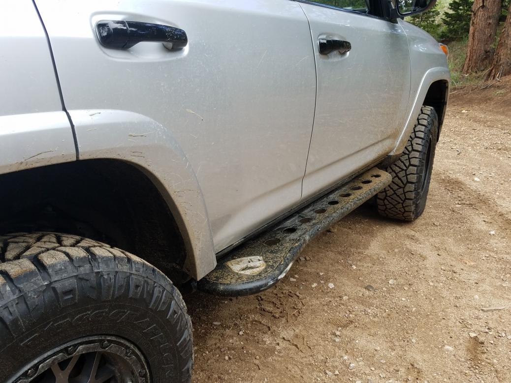

Flat with kick-out has been awesome for me. The top plates helps keep "some" of the snow/slush/mud/crap from hitting the doors, but it really helps as a step for kids, wives and reaching or loading stuff on the roof.
