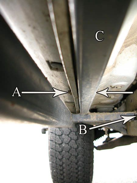

Tips: Use jack stands (with padded tops) to hold the bars up, as you are trying to fit them. Drilling the holes was easy, installing the bolts was not easy. I didn't want any slop in the holes, that would cause trouble later. I left the plastic body panel in place, and drilled through it. It could be trimmed around each hole, if you like.
You want bar (C) to press tightly against the rocker panel. This is the only way there will be room for the bolts, and have enough meat in the pinch weld to survive trail usage. Also, this is where the load is distributed to the body, if you come down on a rock, or lift with a jack. If there is a gap above bar (C), the load will be pressing up on the bolts alone, and will likely damage the pinch weld, as the forces are concentrated in these few locations.
1) Drill all holes in pinch weld, as undersized pilots first.
2) Then drill and fit the bolts at the ends of the pinch weld (rocker panel).
3) Then drill and bolt the legs to the frame (B).
4) If you can, drill out the remaining holes through the rocker (A)and adjacent bar (C). A 90 degreel drill motor helps, as there isn't much room behind the rocker panel. You may be able to get a long drill in there, from the outboard side of the rocker, through the gaps in the slider tubes (maybe).

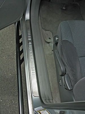

Looking down from front to rear. Narrow space for a step, with the door closed.
Slider1.jpg~original
With door open. This is the best way to stand on them.
