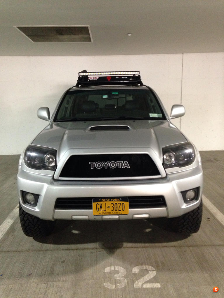

Just got my 40" single row spot flood combo from Exploration outfitters really happy with it ! Man it got here quick just ordered it earlier in the week.
Now just have to get the rest of the 6" lights and bring my rack to my buddy's shop so he can weld up mounts for all the lights.
Very nice. Looks just like my 30". The spot pattern on these is great because it's much tighten than ones like my 40" I think the spot LEDs are 8* whereas on the DR's they're 30.
Yeah i'm looking forward to having it wired and mounted! Did a quick test fit and it fits perfectly on top of the rack.

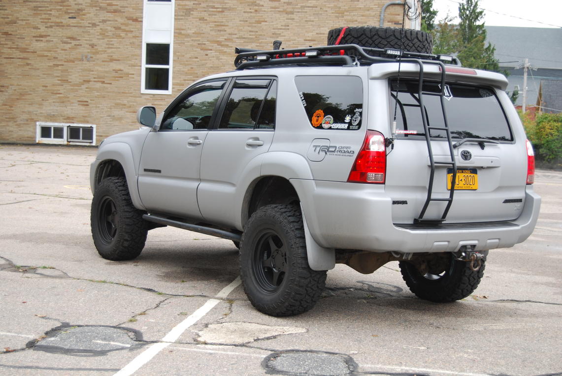

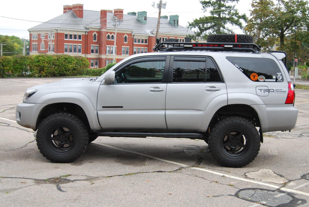

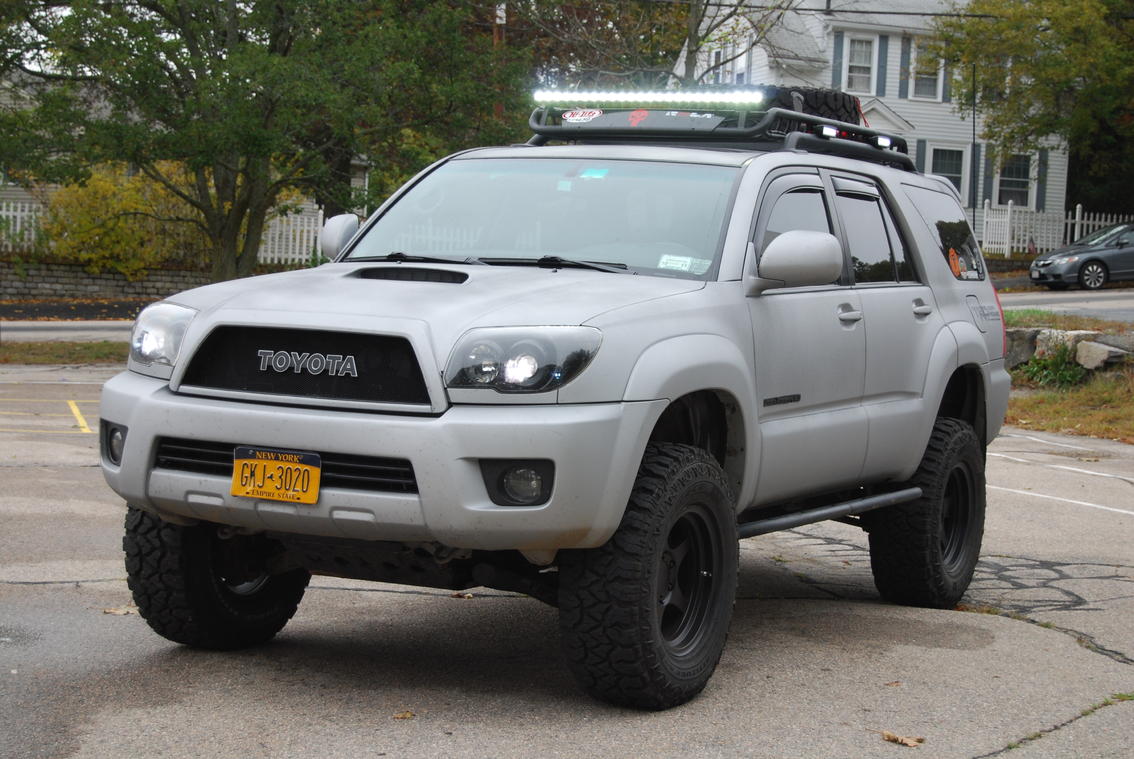

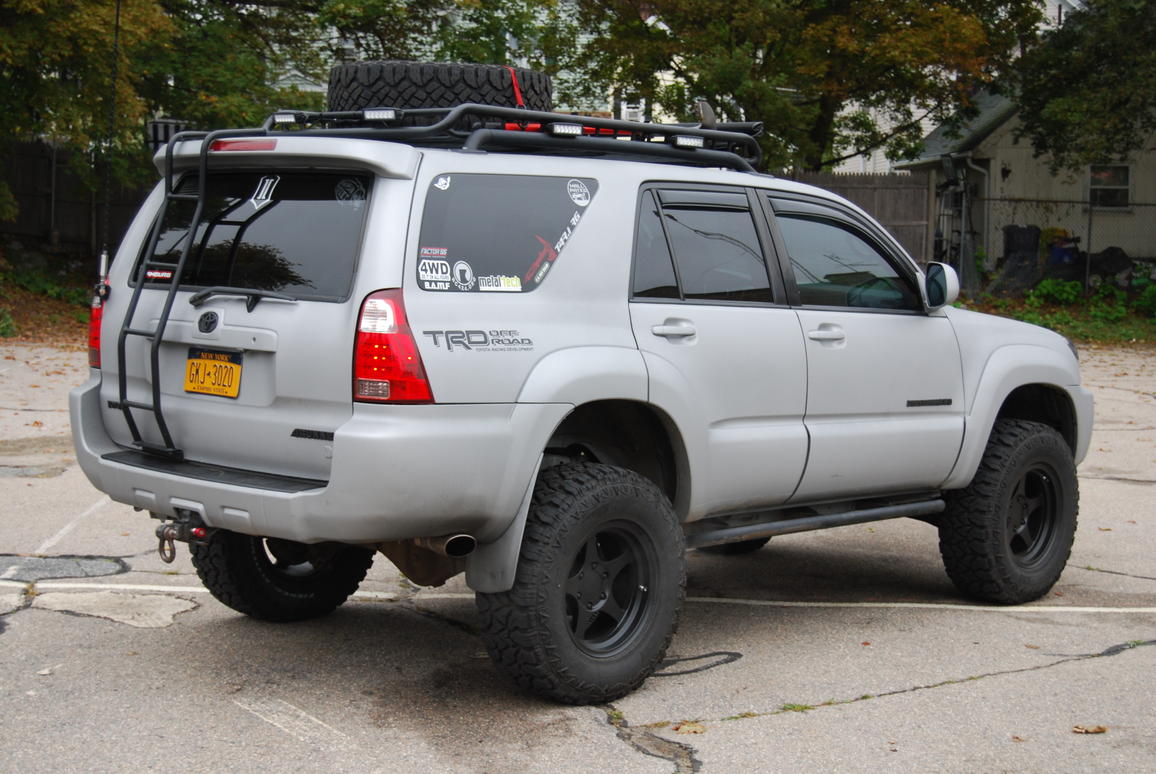

I thought i would revive this thread because the rola rack has become pretty popular on our 4th Gens and a couple people have hit me up over time asking about how i mounted my lights on the rack and well i never finished posting after i had everything done.
So I had my buddy weld brackets on the front for my 40" light bar and then also weld tabs on both sides and the back to mounts 6" leds all the way around. All in all i was pretty happy with the turn out except the way the brackets were welded on the front leaves the light bar sitting just a tad bit higher than i wanted. Originally i wanted it to sit as flush with the top of the rack as possible.So what my buddy did is weld the brackets for the front light bar to the top of the bar which why it's sitting a bit high, if he would of welded it to the bottom of the bar i think it would be sitting perfect. He did it this way because he said it was the strongest.I may have somebody cut it and re weld it but for now it's been great. I thought i had some good pics of the brackets and how the other lights are mounted but i can't find them at the moment but for know i'll couple pics of the rack with the lights and i'll get some good pics of the brackets and how the lights ar emounted for you guys tomorrow..

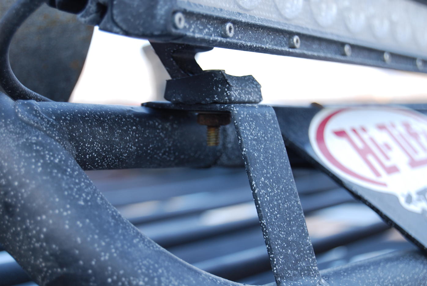

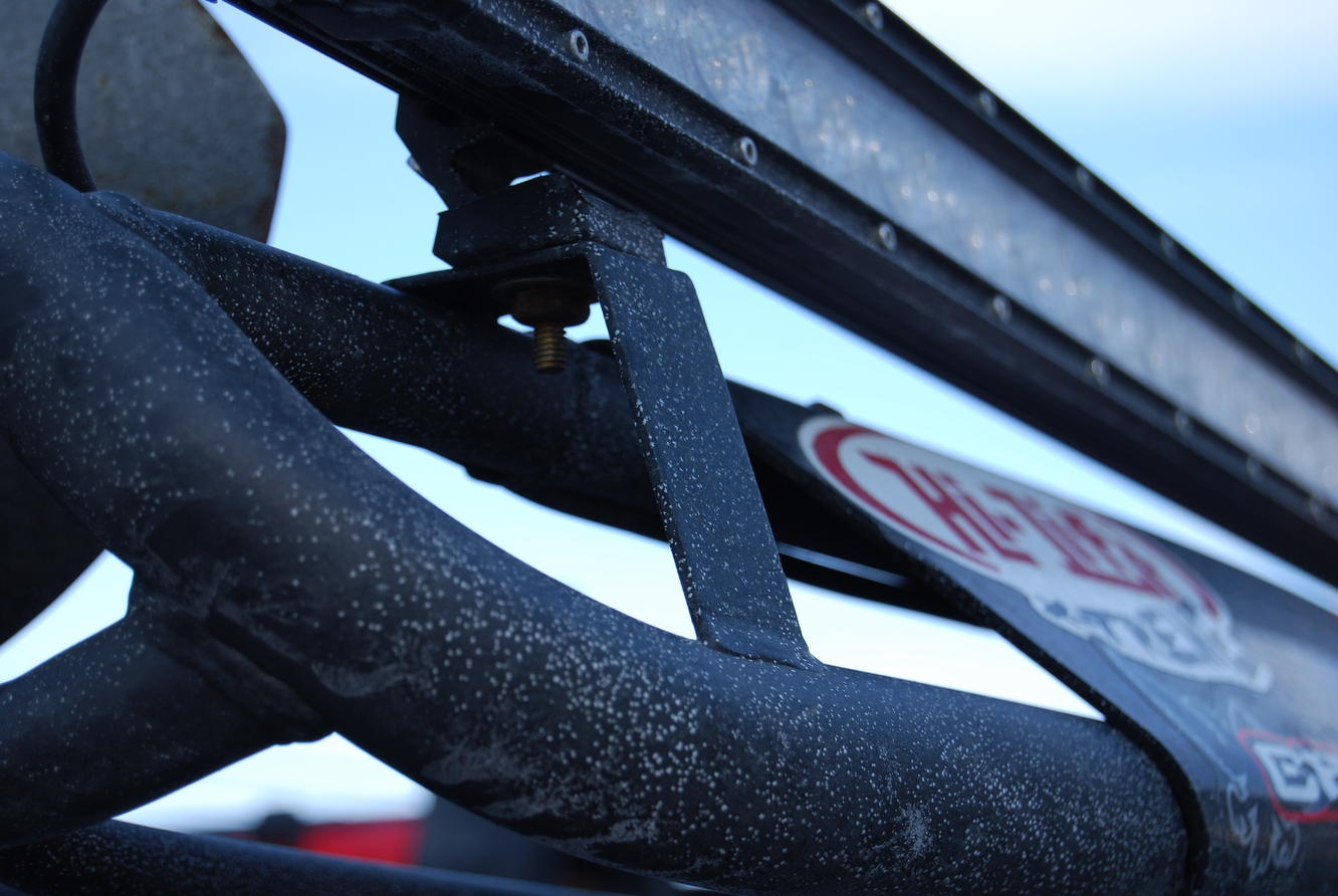

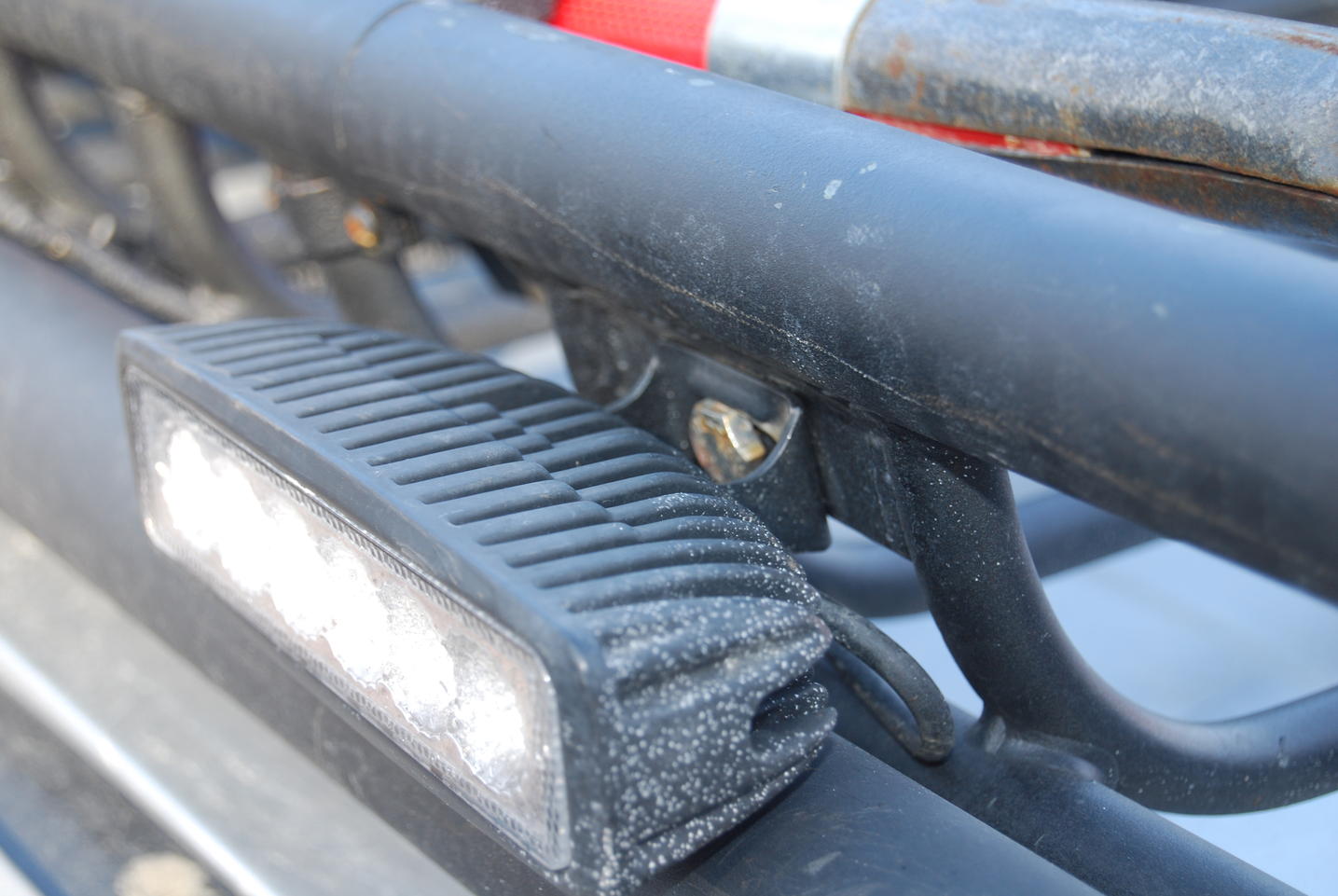

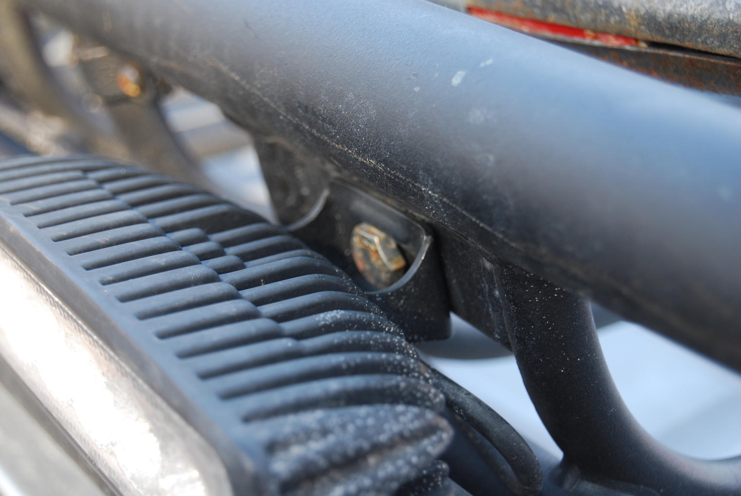

Here's a couple quick pics of the front side brackets with a little bit of new england salt for ya.
