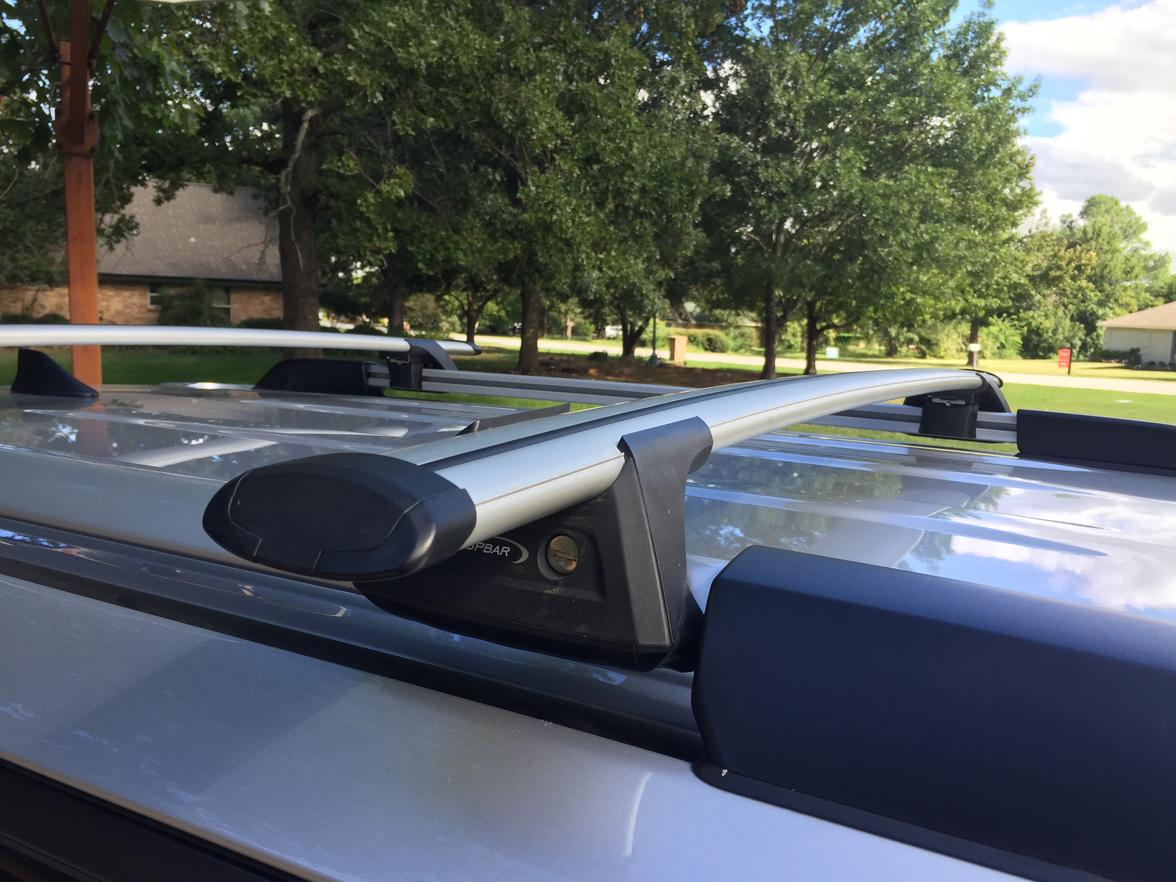

I am using the Whispbar crossbars on mine. They clamp nicely to the factory rails. I am not anticipating any issues with two 40 pound 9.5 foot sit on top kayaks.
I would prefer the factory rails were longer and more centered instead of being far to the rear.

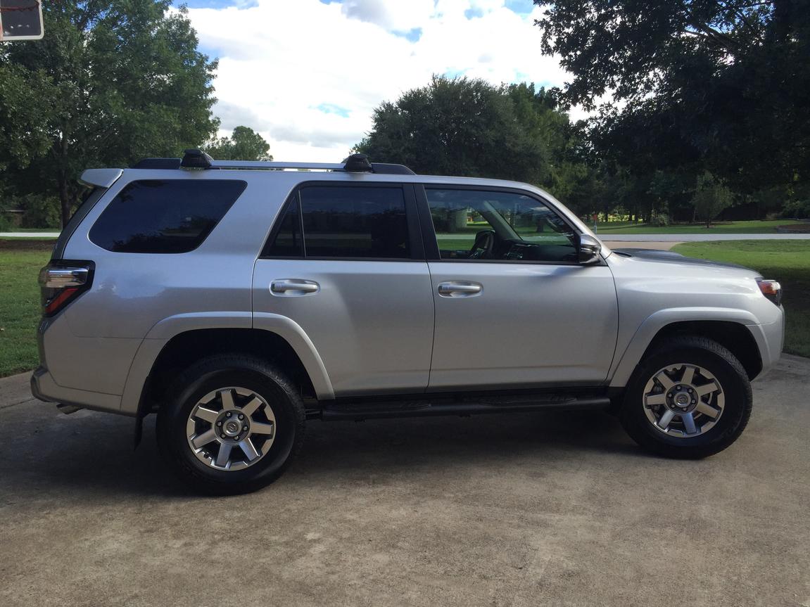

I had my crossbars on my Tacoma before so using them again was a no brainer.
Here's another view.

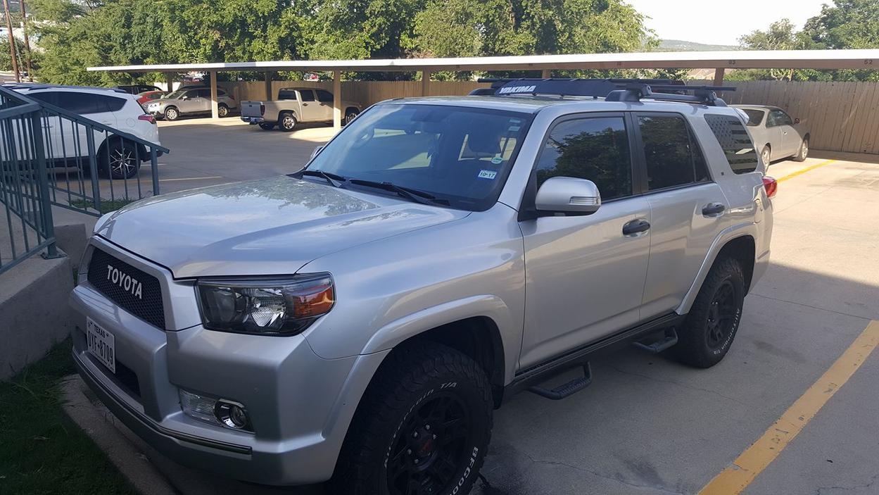

I put on a Yakima rack system using Timberline mounts and Core bars (60"). Nice and flat; good load capacity and easy to lash anything from kayaks to a 4'x8' sheet of plywood on.
-H-
Hello! Can't tell from your photo but the Timberline/core bar system does sit up higher than the sat antenna? Also, 60" bars hang over how much past the vehicle?

I have the same setup with 58 inch round bars. I believe they overhang 4 inches on each side. Also, they do sit higher than the antenna, but don't interfere with it.

I actually just put them on about a month ago. Not planning on taking them off at all. We'll see how they hold up to Texas heat.
I have had this rack system on 4 different 4Runners over the years, just changing necessary parts to adapt to the racks. Very stable.
