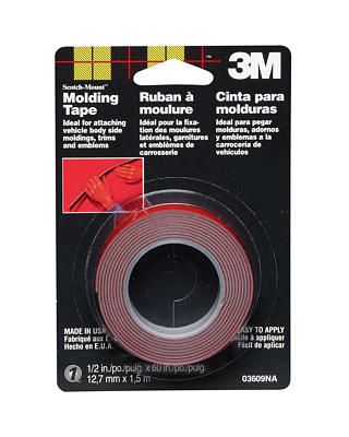

yeah, those are the screws that I assume are removed most often as thats how one removes the end caps to get the crossbars out. And they thread in at an angle, not straight up and down. I effed one up a little bit 2 weeks ago. Then a little more. Then all the way+.
Ended up cutting the nut off with the dremel, very carefully. Popping the headliner was nerve-wracking bc I wanted to avoid breaking/creasing it. I figured out you just pull down on the big button and break it off, then buy replacements.
Used autogeek_2272_110477584.jpg to stick on a flanged replacement nut. Lined it up real careful so the bolt would thread in proper. Then did the RTV gasket thing.25223.jpg. Left over from transmission pan reinstall. I actually did the RTV with all 5 holes, having removed the entire channel, as I didn't trust the original silicone to maintain a seal.
