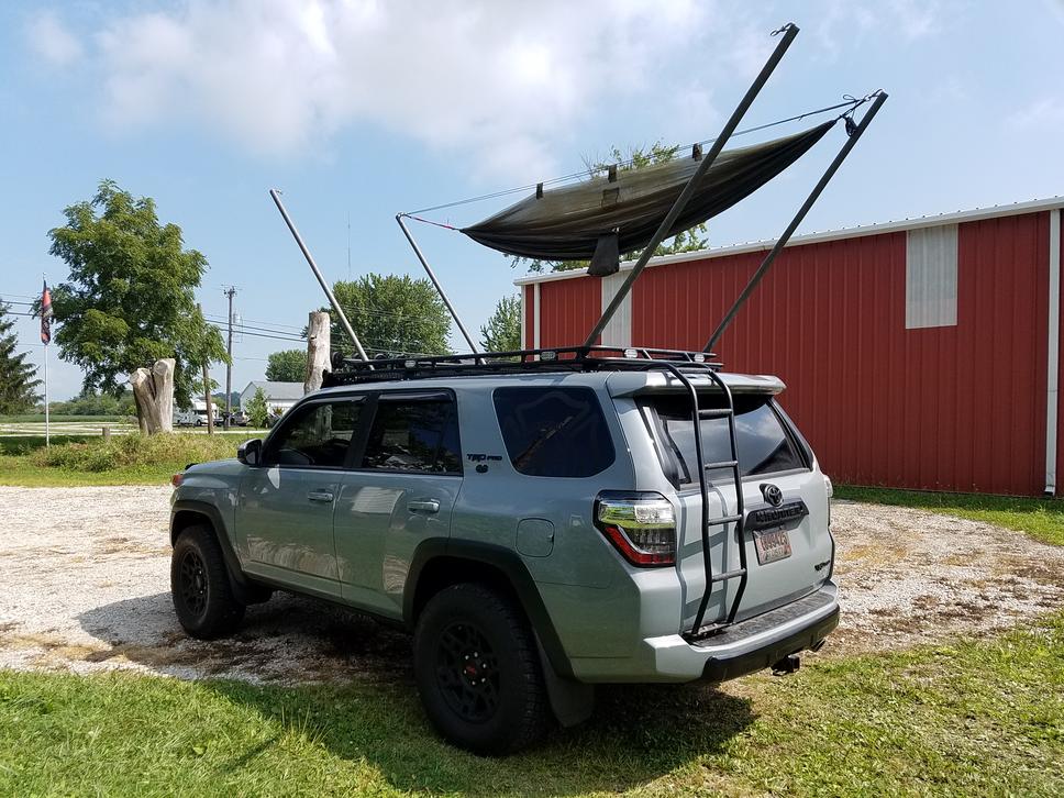

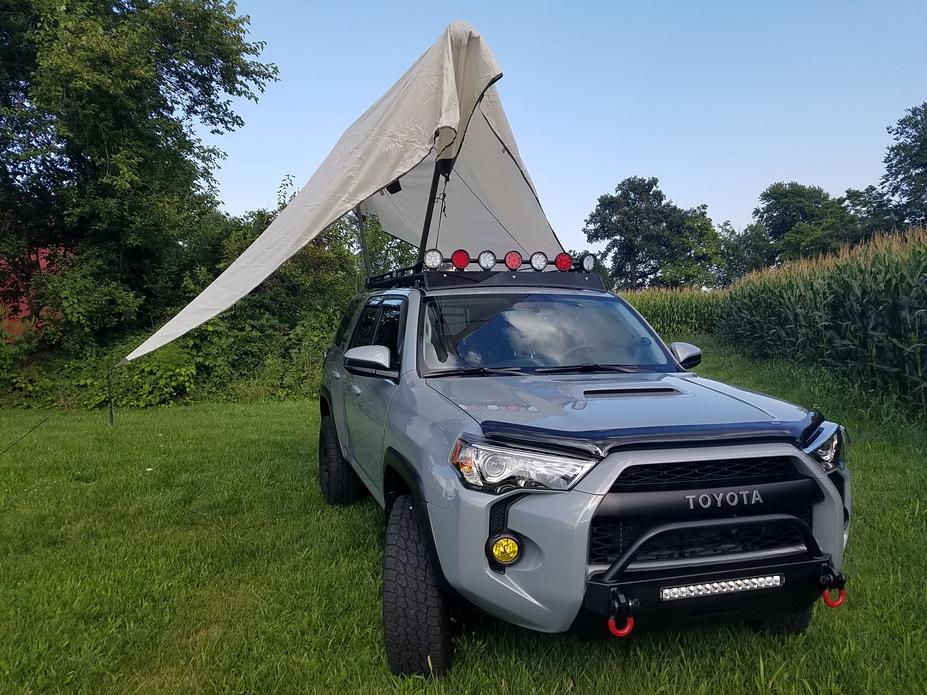

Roof Top Hammock... Does this count?
When I get out of the driveway I will pitch the Rain Fly over it and maybe then it will qualify as a RTT, for now it is a RTH haha

how's it look folded away? or do you take it all off the roof?
Just the 4 posts slide into the slots and it is a backpacking jungle hammock.
Check out my "build" thread #7 and #10 linked in my signature line. It is the only thing I have built yet on the truck, everything else is things I have seen throughout the forum.
So far I have only test drivin' it in the back yard but from what I can tell at this point is it is solid, and we can go tandem or solo.
Here are a couple of Rain Fly options, but they will change when I get the ARB mounted up too... always a work in progress!

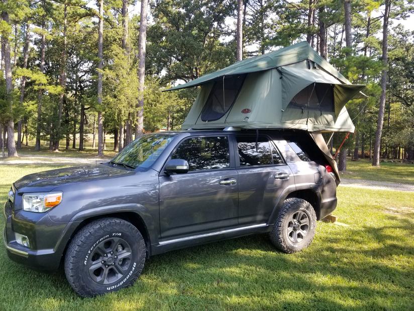

Mombasa RTT mounted on factory rails currently. Haven't flipped the rails yet, probably going to get some high rise cross bars for the short-term:

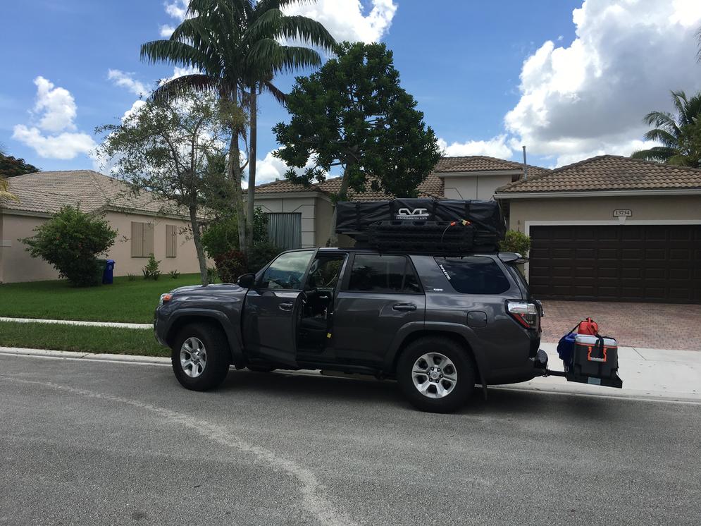

Got to try out our CVT Mt. Rainier Summit Series over Labor Day and again escaping Irma. Very impressed so far. Plenty of room for my wife and I and our two kids (2 and 5). Mounted to Frontrunner slimline ii 3/4 using their new quick release mounts (which as I posted above are worth the $ IMO). Setup in less than 10 minutes in a full on thunderstorm. Kept us dry as a bone. Never slept so well in a tent before.
Last pic is us loaded up to escape Irma.

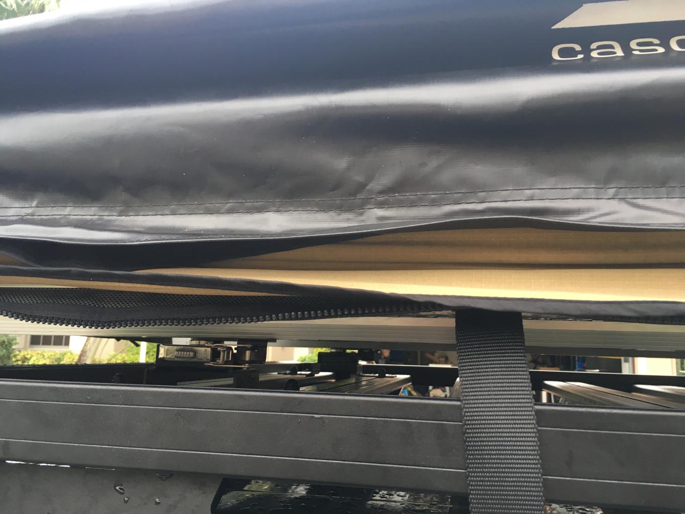

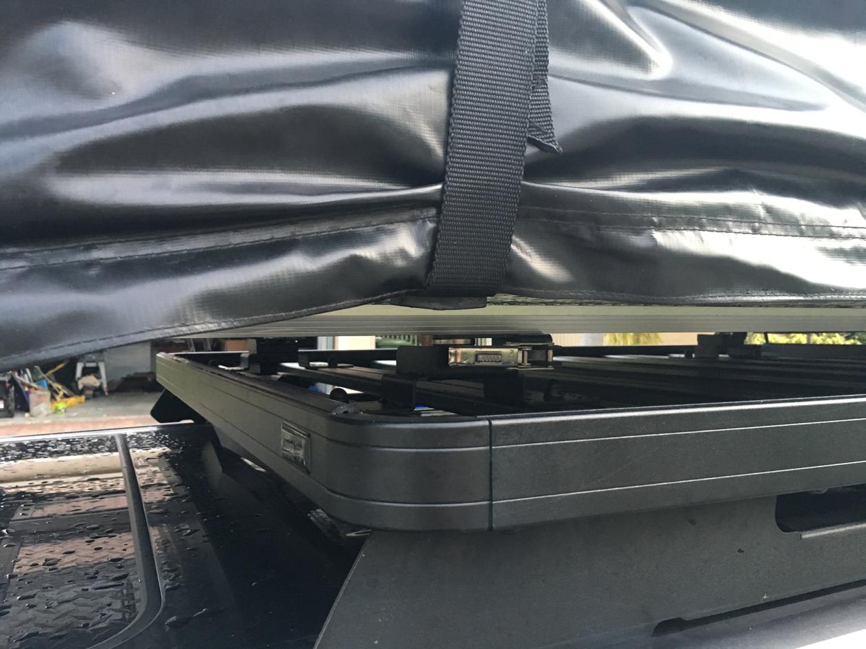

I have them on my Frontrunner. After initial setup they are worth the $ IMO. Literally put our CVT Mt. Rainier on in less than 2 minutes.
Thanks for info! If thou get a chance, can you take a photo of the mount on the rack? Thanks, God bless you and be safe.
Sent from my SM-G930V using Tapatalk
Thanks. These are the best I got now. I can take more once we take it off. After talking to Frontrunner you can mount below for lower profile (literally flat with the top of the rack). I chose to mount above (about 2" above rack slats). Although not as low profile I feel with the mounts sitting on the rack as opposed to being held on by just the channel nuts it was better for spreading out the weight, as it is already a large/heavy tent and we sleep 4 in it. Frontrunner did say that it can support up to 660 lbs (weight rating for he rack) mounting below. If I had a smaller tent...i.e. FrontRunner, 23zero Litchfield etc. and only slept 2 I would have mounted under the rack.
Honestly in person it doesn't look as high as in the pictures, and I do like having the extra room under the tent to either mount flat objects or just to get my hands in for any adjustments.
