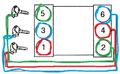

Also I found a wiring diagram and cylinder numbering diagram that I splashed a bit of color on to make it a bit more obvious. From yotatech.com >> https://www.yotatech.com/f2/5vzfe-cylinder-numbers-3rd-gen-v6-4runner-109370/
I also just realized that this diagram doesn't help anyone who might be color blind. So...
Wire order breakdown:
Rear of vehicle
5 >> 2
3 >> 6
1 >> 4
Front of vehicle

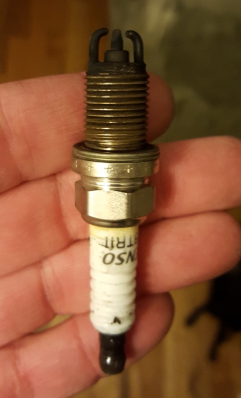

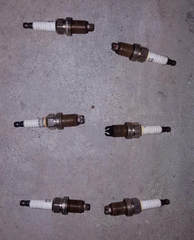

Here are the pics of the old plugs. Cylinder #4 plug was the worst of the bunch. I also was able to tighten my valve cover bolts as a temp fix for a leaky VC seal. I have the parts waiting for me and a friend to find the time.
