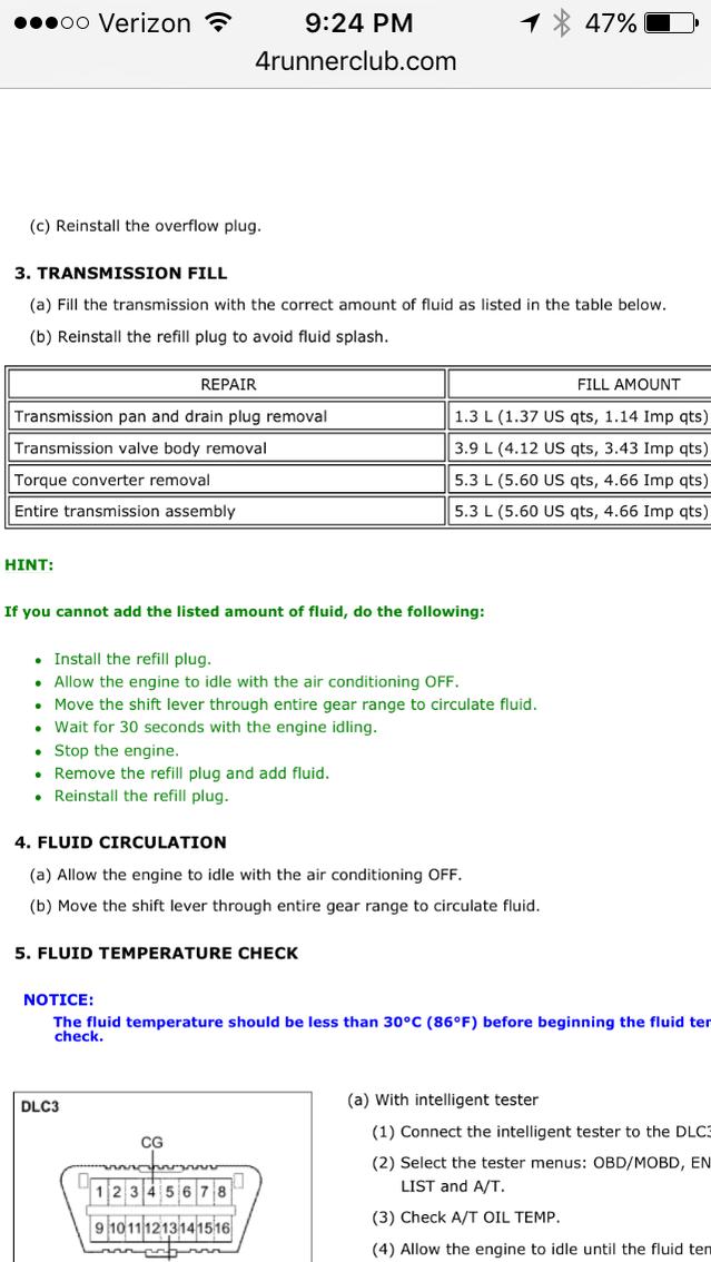

Does anyone know if this is correct amount of oil for the drain and refill of just the pan,1.37qts? Ive read most all of this thread and seen a few different numbers researching this. This is from the factory service manual, but i wanna say ive seen somewhere else in the manual where its a different amount? i wanna say when i did it before i put in about 2.5s and it was happy when i went to check the fluid level at tempature. Developed this shudder over the past few days and this morning I thought the trans was going to drop out the bottom it got so bad. Went to do a drain an refill and a good amount of oil came out the over flow drain. Ive read the whole service manual on the filling and checking and the fluid level and its saying if you drain and refill the pan you need to put in 1.37 qts back in, or pour untill it comes out the over flow then get the fluid up to temp then check the level. I understand that 1.37qts is just a starting place but why is the number so off, the owners manual even says 3qts.

Are you doing the level check with the car running? The T4R should be running and the fluid should be at the proper temp to do the level check.
