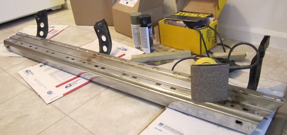

the runningboards on my 94 are pretty much rusted to nothing underneath so i recently bought some used stock runningboards for a pretty good price ($50 for both)...however they are chrome (with a tiny bit of surface rust). i want to make them black just like mine are now
does anyone have some tips on the most effective/cheapest (at-home) way to remove the chrome and make them black?

planning to finish one today...going to sand it down the most i can...then some duplicolor self-etching primer followed by krylon rust tough enamel
the undersides are bit rusted so im planning on por-15 for that (an ounce of prevention is worth a pound of cure!)
