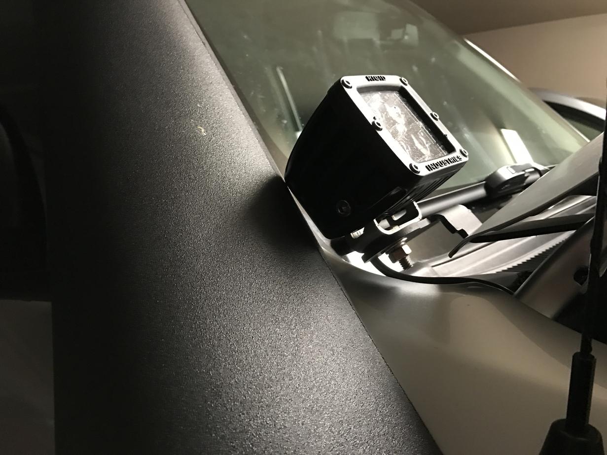

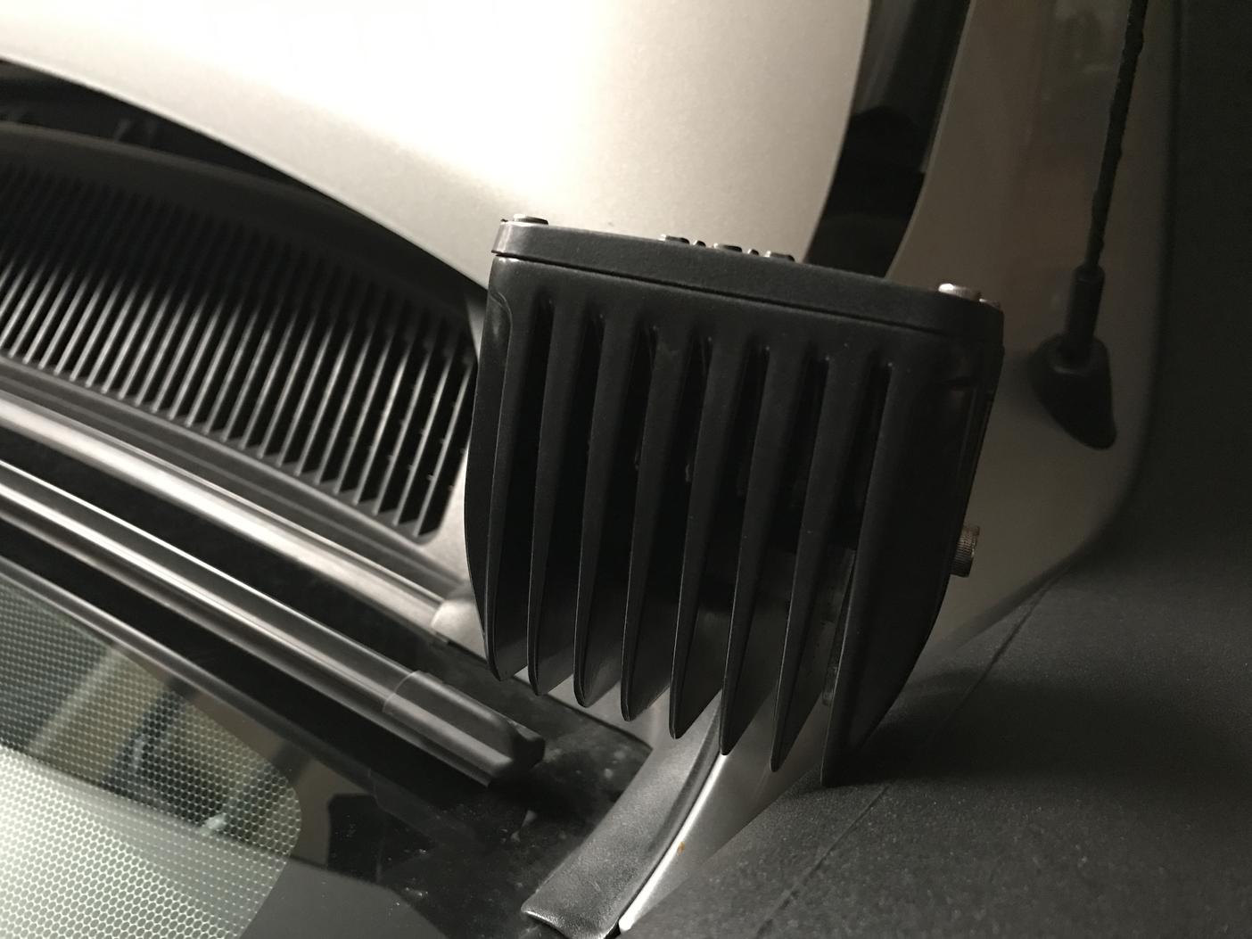

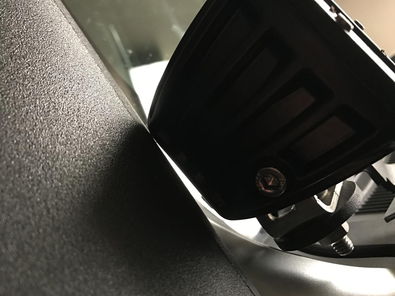

That looks awesome! :clap2: I have one on the way also and curious if you have any issues with your ditch light brackets when hood is open?
I have CBI brackets and Rigid Hyper shots. I can open the hood and the light just does touch. Probably going to eventually swap them out for a flood pattern and angle them at 45 degrees. I'll get a pic tomorrow when I have a chance. Thanks for the kind words!
[MENTION=140508]DesertEagle[/MENTION] here you go brother. The hood is open all the way.
