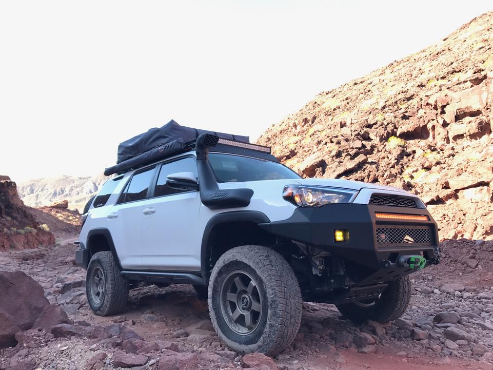

worse part of the install was putting the fender clips back in without putting the fender liner back in...and I had no drinks to blame that on....lol:first:
also, I wanted to mention that this does fit the TRD intake. It does make it louder under acceleration, but its still very quiet under normal everyday driving.
Finished up a bit ago! Made a beer run for some destresser before posting the results though.
[Edit] Oh! For the big hole I used these Dremel cut-off wheels. I only used maybe 1/4" radius off one disc.

Looks great! Well done!
Thanks! This was definitely the highest pucker factor mod I've done by far, which you must already be aware. The bumper was the first destructive mod but that one is easily reversible for a few bucks. This one, not so much.
Yes... Pucker Level 10+
Satisfaction Level after installation, knowing you did it right... Priceless!
Loving how it looks with the Safari snorkel. Hopefully we can find some water to tread through and test this bad boy out. :rain::rain:
